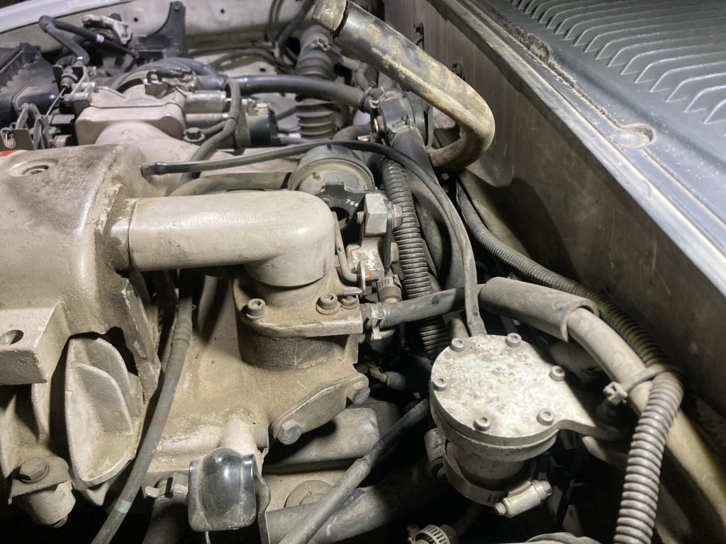

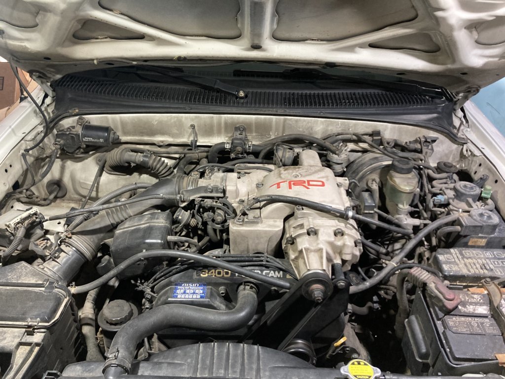

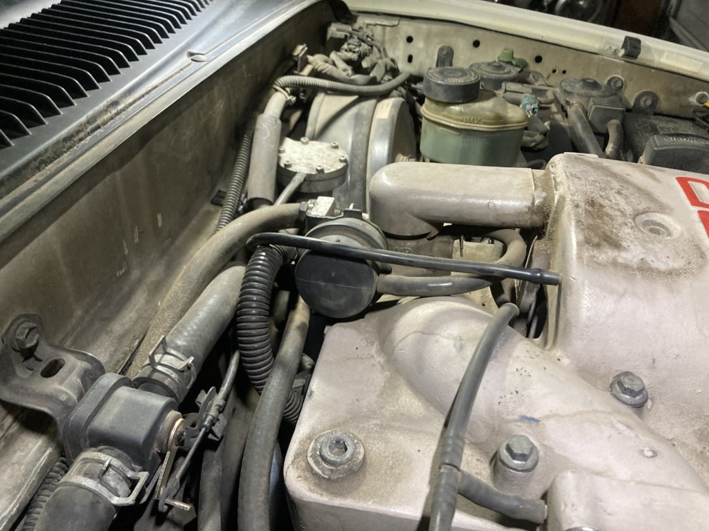

    The problem: The 7th injector kit says it only works on vehicles without an EGR system... Rookie question: Does mine have one?
    General Engine Bay Photo
    Passenger Side Photo
    Driver Side Photo

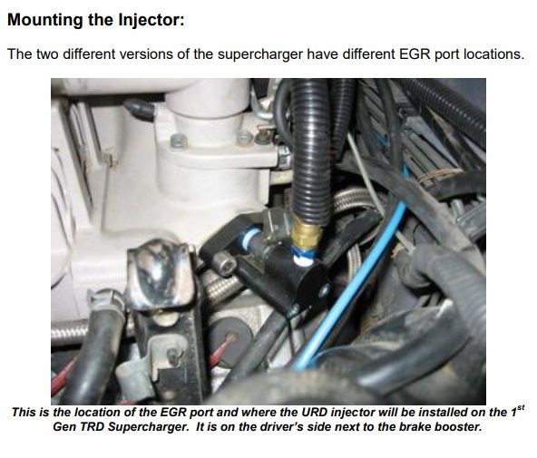

    This is what the URD Directions say for the 7th injector kit.
    Looks like my supercharger has the opening there...what do we think? Thanks all!
