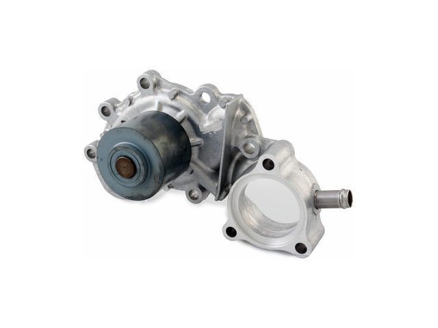

    There’s only 2 TB/WP kit. Only difference is the water pump: with or without cooler, hence, nipple/outlet on the water pump.

    Will the water pump that came with the aircabinman kit work for my truck?

    The oil cooler is pretty obvious if you have one, you should be able to see it throught the wheel well if you move the mud flap out of the way.

    With cooler is top picture
    Without cooler is bottom picture
    Both are exactly the same minus the bypass nipple for the cooler, located on the right side of the housing, by the thermostat.
