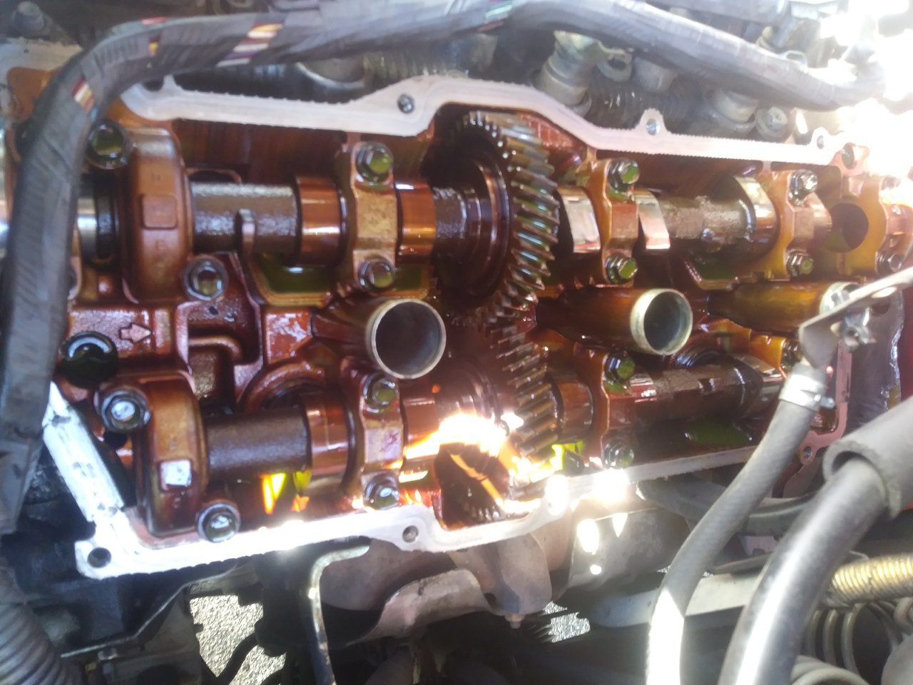

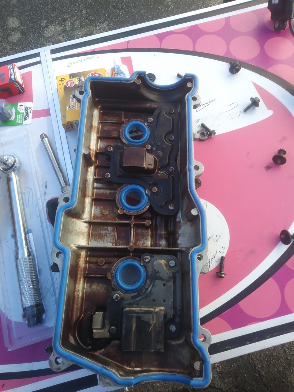

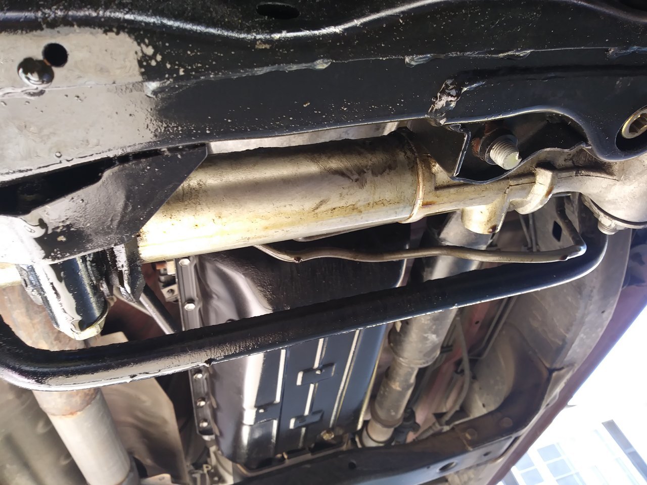

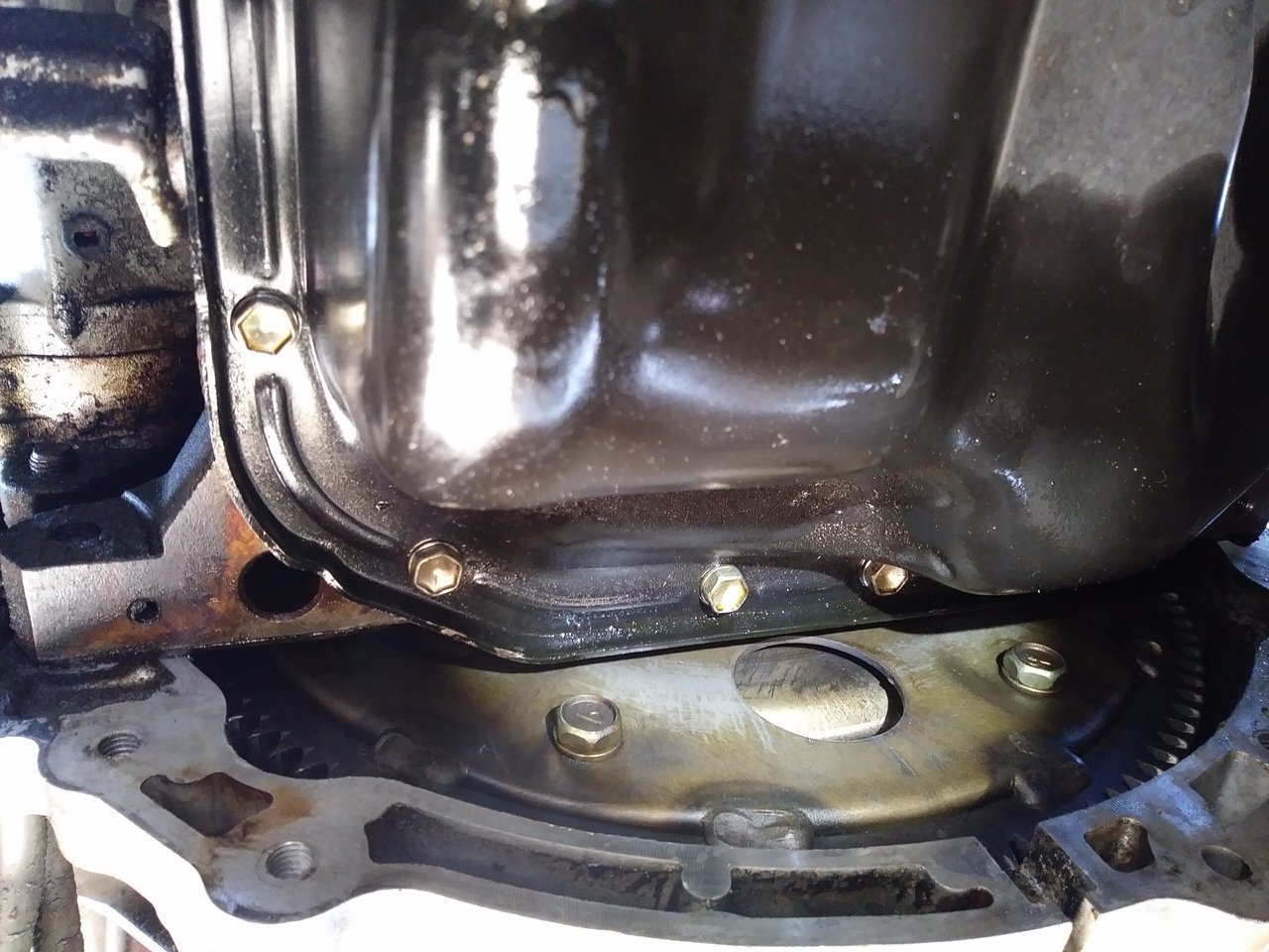

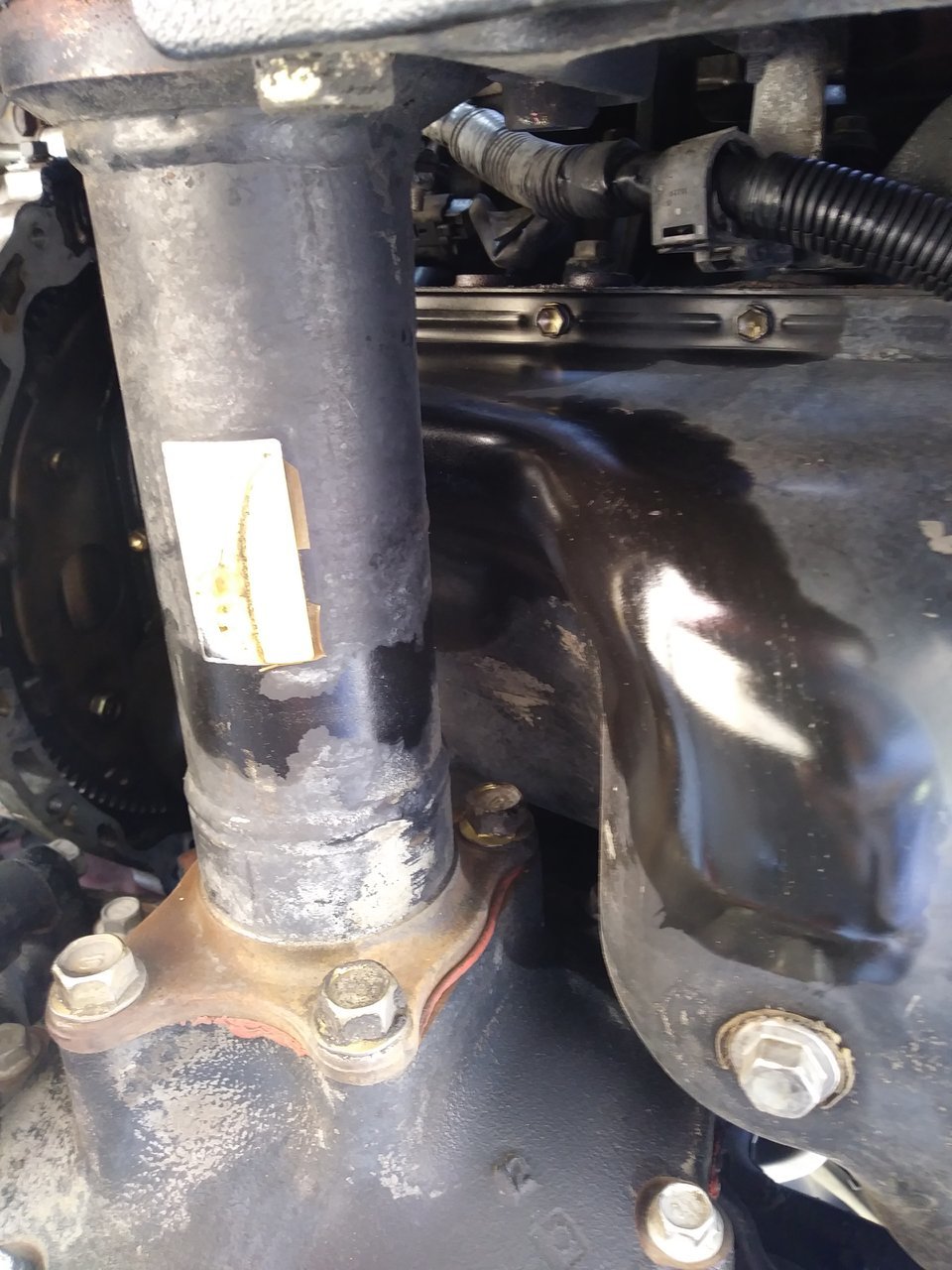

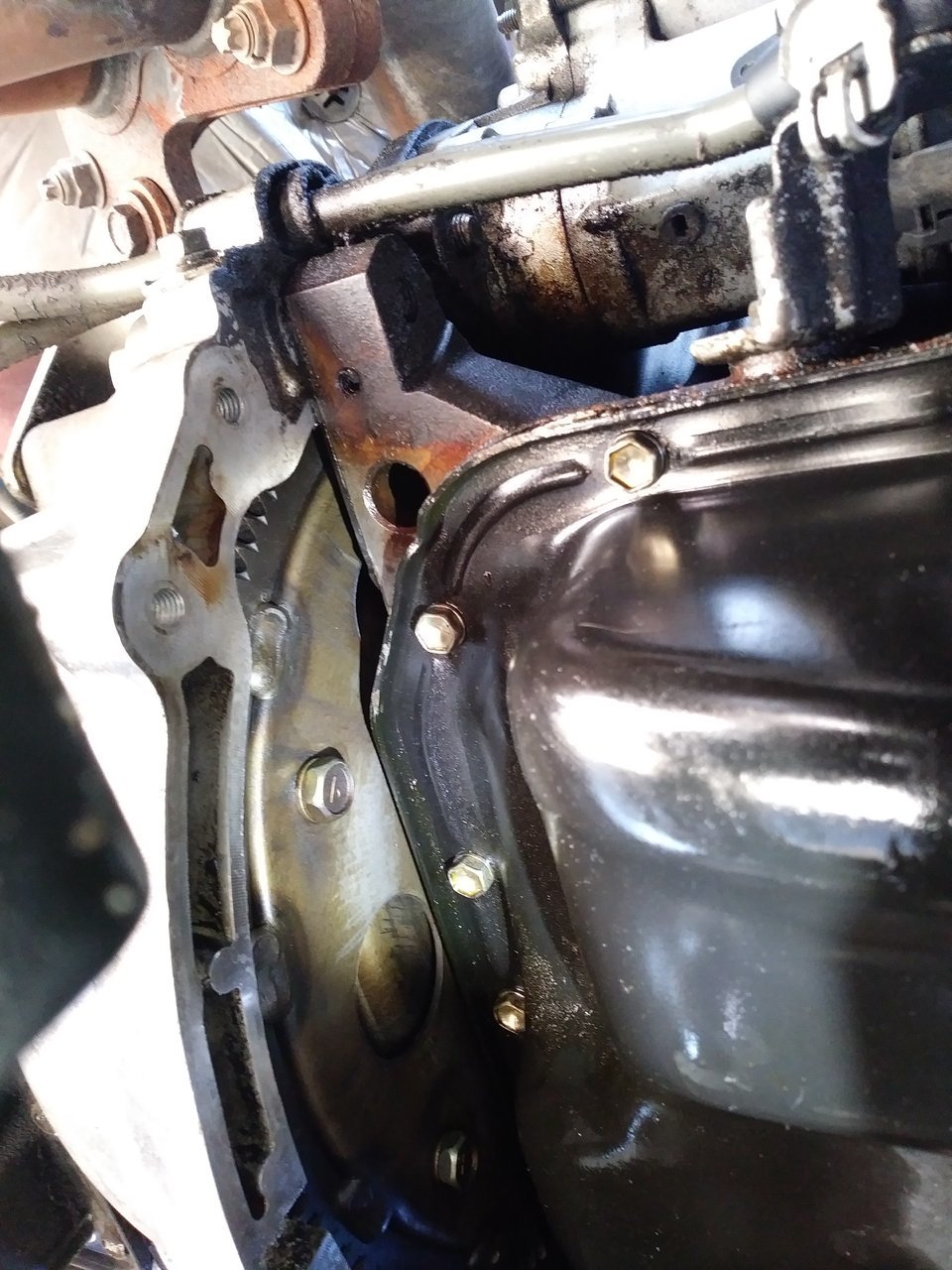

    recently, I started stabbing at an oil leak. I HATE when my vehicles leak oil. so, I cleaned the crap out of the engine, did an oil change and added UV dye to it to get to the bottom of it. I found a little oil coming off the back of the block and located the problem. Whoever did the Valve cover seals last, was not able to reinsert the valve covers into position without fudging up the seal and knocking a corner out of place before torqueing it back down. Pic attached. and this was causing an oil leak. so, I replaced the valve cover seals, resealed the half moons and replaced the rear cam plugs. bingo bango valve cover oil leak fixed!
    I buttoned everything back up, cleaned the engine again, replaced my skid plate and was happy as pie for about a day... still leaking oil. everything messy and oily all over again. kill myself. I checked the back of the block where my new plugs where installed and also ran a paper towel over the newly sealed half moons and found that my replacement job was a success and there was no oil coming from the said areas. so, whats next? with oil dripping down the bottom of the bell housing and oil pan I thought well shucks, gotta be the rear main seal. so I geared up the drop the tranny and watched all three of timmy the toolmans transmission videos. then, I thought... but what if maybe it,s not the rear main seal. so I removed the access plate granting me a view of the flexplate (flywheel?). the flexplate (flywheel?) itself is dry. no oil on it, if it was the RMS wouldn't there be oil all over this thing (pictured)? instead, there is oil on the access plate itself and around the outside of the inside of the bell housing immediately surrounding the access plate. so, I really looked at where the oil seemed to be coming from and, from what I can tell, it seems to be the oil pan gasket. near the rear of the oil pan, oil seems to be leaking out and then proceeding to drip down into the access plate area and eventually down to the lowest part of the bell housing making it look like the rear main seal is going. when, in fact, the RMS may be fine and just the oil pan gasket needs to be replaced. JUST the oil pan gasket??? yeah right, pain in the ars job too it seems to be.
    does anyone have any input on whether or not the flexplate (flywheel?) being dry indicates the integrity of the RMS?
    so, here I am with 2 potential oil leaks in oil spot.
    the oil pan gasket can be replaced by dropping the front diff. which, is a pain in the ars, as I understand. the RMS can be replaced by dropping the transmission which, is a pain in the ars, as I understand. both can be replaced by pulling the engine, which is a pain the ars, as I understand. so I am currently leaning toward pulling that engine. mind you it has 370k on it and my idle is intermittently rough. I has the valve covers off and, I know, I should have checked the clearances using a feeler gauge. but, I called the local Toyota dealership to check their stock on valve shims and they would have to be special ordered, which means, i'd remove valve covers, measure, turn, measure, turn, measure the clearances and check spec. then, of the valves that were out of spec, remove the shims, mic em, put them back in, turn, remove other out of spec valve shims, mic em, do the math, order from dealer, wait a week then replace all out of spec shims after having been without a truck for a week at least... so I just didn't do the valve job. ughh, with that rough idle... maybe I should have.
    But, it all starts with a compression test, I know, I know, I need to do this still. to really determine whats what.

    My guess would be the oil pan gasket. I would try re-torquing the bolts to factory specs first. Clean it up and see if it starts leaking again. Chances are, over the years they've probably loosened.

    Second of all - I'm sorry, but IMO the only replies you're likely to get here will be along the lines of "jeez, 360k miles, no shit it's got blown compression." and "360k miles, yeah it's gonna leak oil. Be grateful that's all you got to worry about."
    Third, Yes, you pretty much have to move something to replace the oil pan gasket. Either move the front diff, or lift the engine up.
    If you want to be bold, you might consider dropping the oil pan just barely enough to slip the new gasket in, but you have to cut the gasket so it can go around the rotating assembly. Your clearance between the oil pan and the front diff is just a few hairs.
    But honestly, man...you really threw the wrong amount of money at the wrong truck if you're the type of guy who is worried about oil leaks.

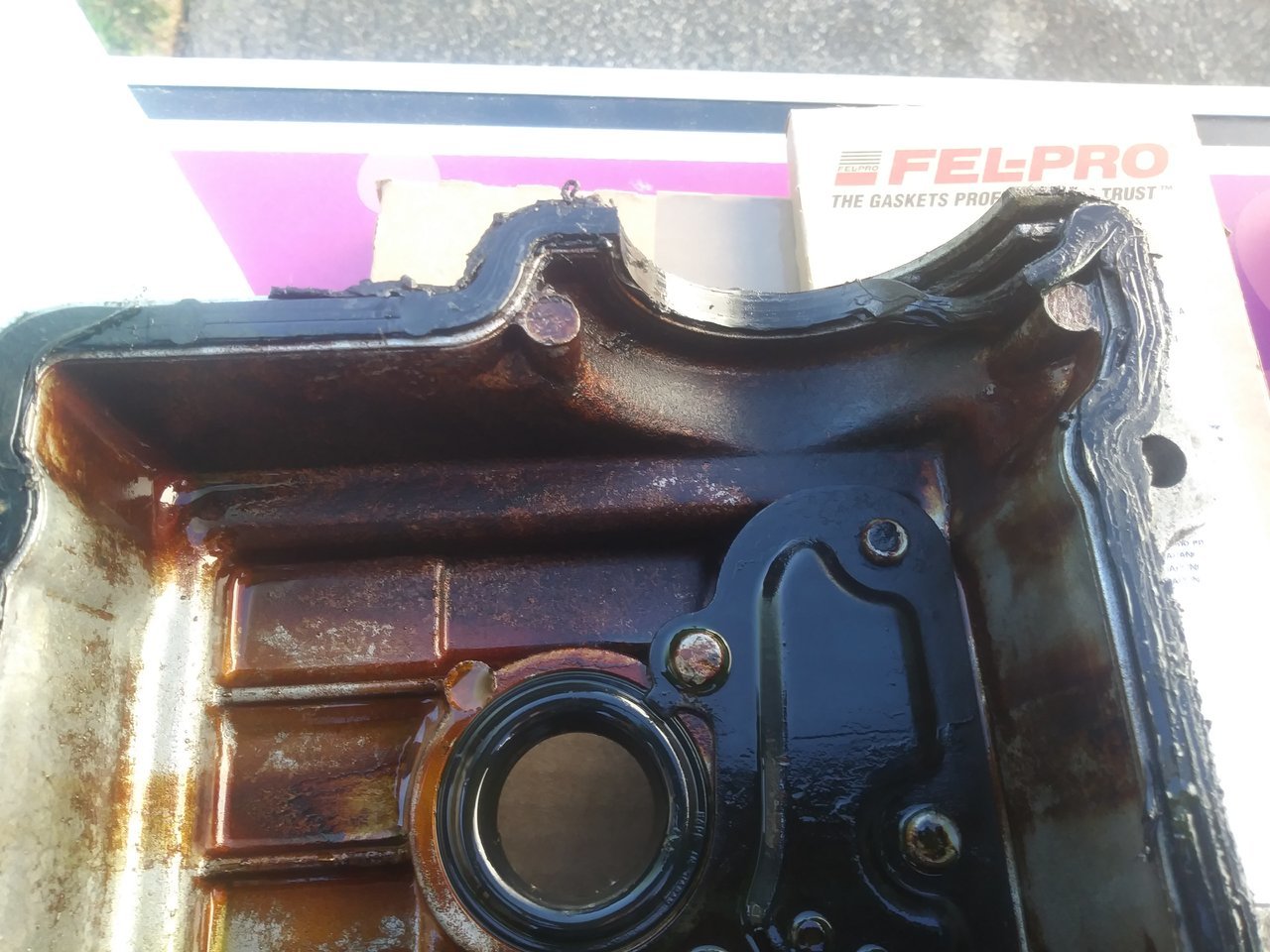

    Good job on the valve cover gaskets. Honestly, if I were you, I'd buy a valve shim kit online. I'd say after 360k mi, it probably needs it. Wait awhile, see if it gets any worse then decide if you should do it. I definitely wouldn't rebuild the engine. These are known for high mileage. Also what fast5speed said. You can cut the gasket and squeeze it in that way. Lightly use "pookey" on both sides of the gasket and "glob" it on by the cut..

    Looking at the pictures, it seems pretty clean!!

    Yeah, you're right. I took a second look, and all the bolts look super clean. As well as the frame, but only the front part of the frame was pictured. Dude probably lives in California :taco:

    there should be no gasket on the oil pan. The oil pan should have been sealed with FIPG ... form in place gasket material. The other potential leak could be from the oil cooler, D/S of the block 2/3 of the way back. Do a search using "Mystery coolant leak found" in the 1st gen forum and you will see pictures of what I am talking about.
