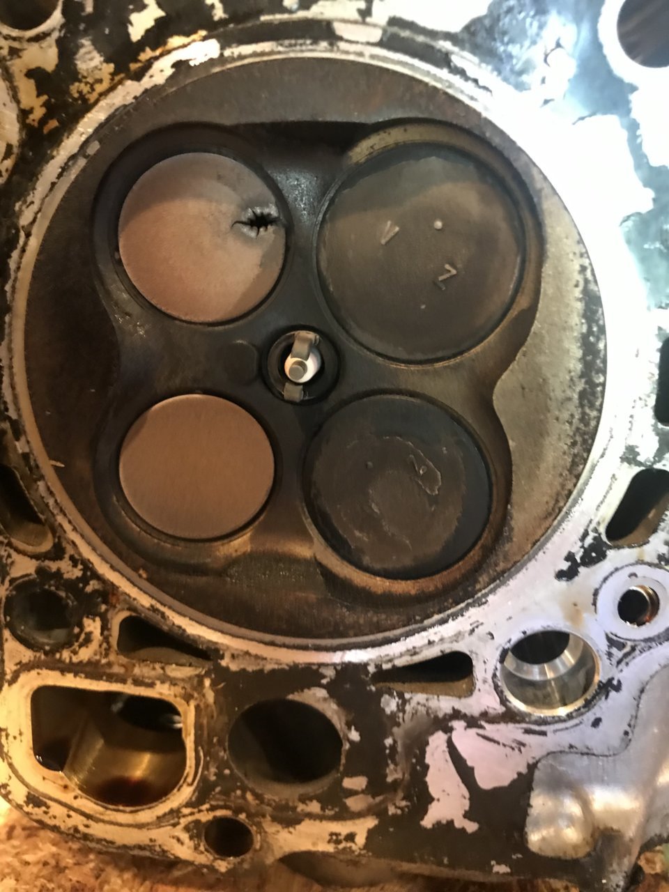

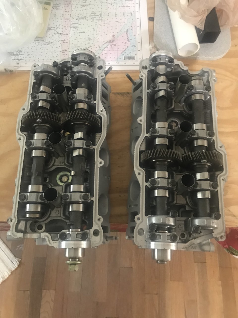

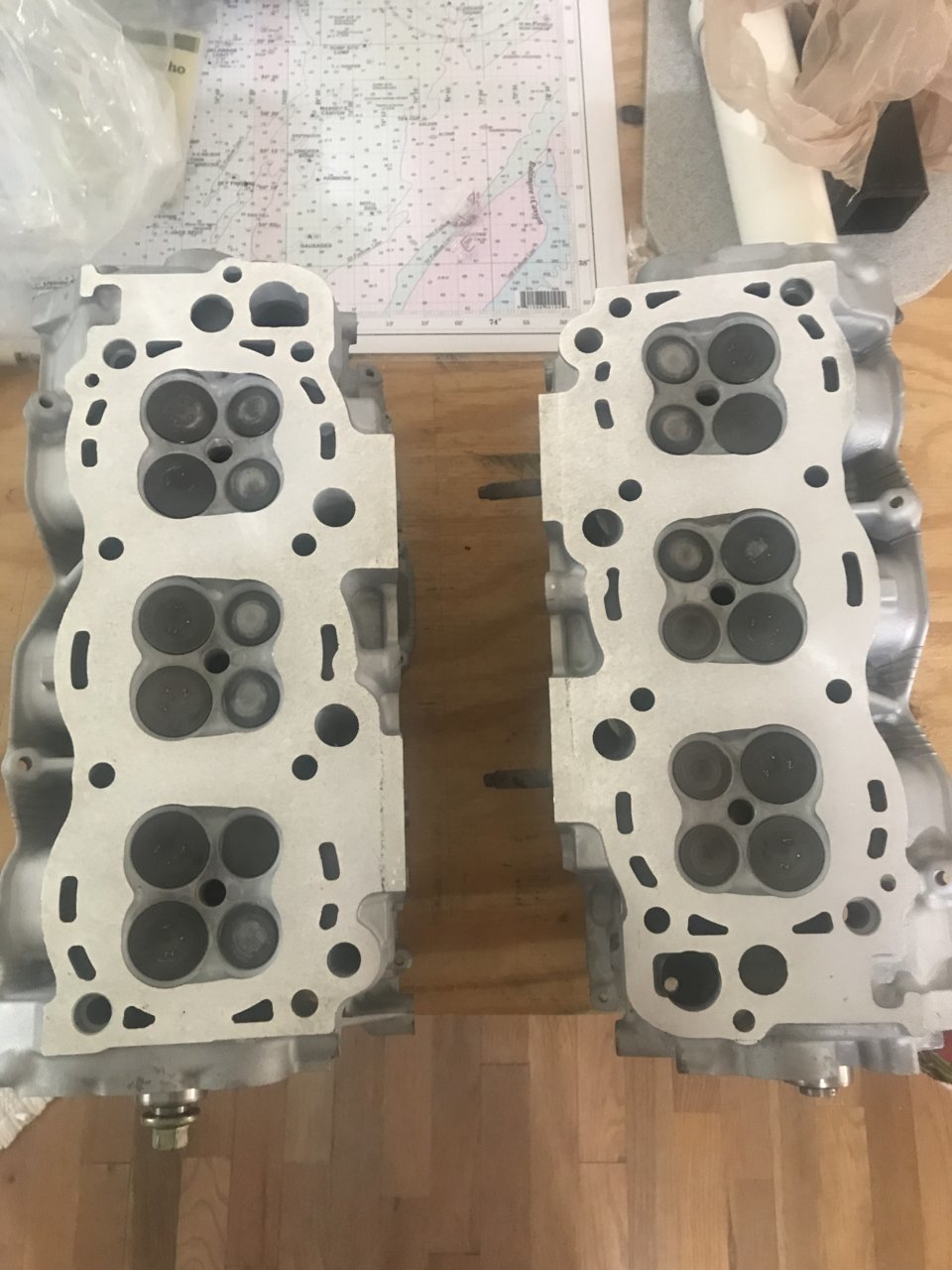

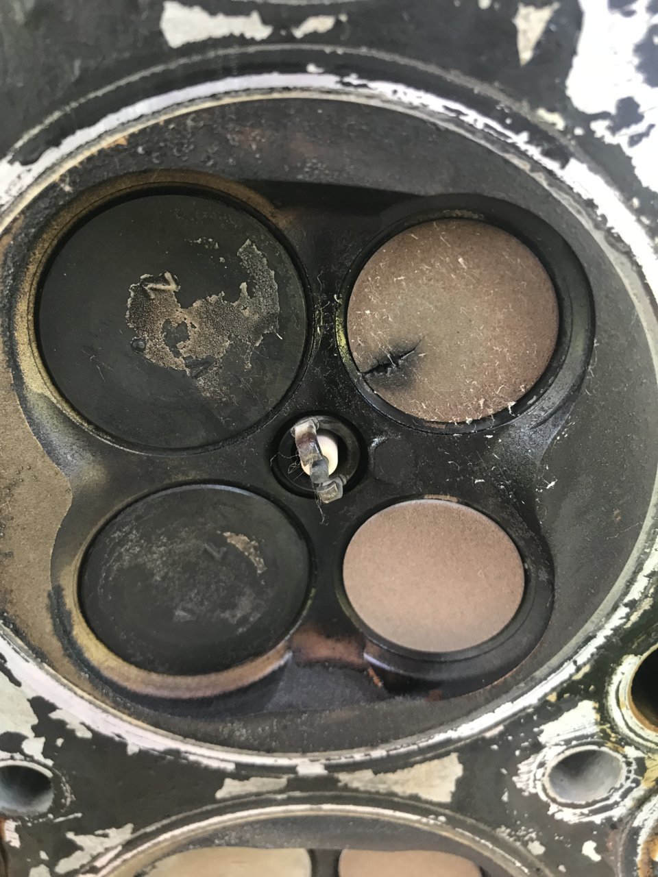

    IMG_8556.jpg IMG_8559.jpg IMG_8637.jpg IMG_8638.jpg Fella Tacomers & members it's been almost 2 years since I requested your input on my engine running bad situation. I've been busy completing a rehab on my home.
    Anyway, my first step in the investigation process was to pull the heads. After getting them off I found that I had 2 burnt intake valves. I also noticed that the cylinder walls still had very noticeable cross-hatching in them & there was no ridge in the cylinders. It was at this point I decided to do a valve job only. (My truck only gets used about 32 miles a day on average mostly towing my boat & driving on the beach to surf fish.) I had the head work completed at a machine shop that I used to do my work back in my muscle car days. After receiving all of the appropriate (OEM) parts & gaskets sets (I also rebuilt the fuel injectors & used new head bolts) I reassembled the engine. Hit the key & it started just like it does every day.
    That was almost 20,000 miles ago and it's still running great.
    I just wanted to thank everybody for their input.

    those are exhaust valves... a couple of thoughts, check the clearances and examine the adjustment shim that is associated with the burnt valve. The theory of operation is as follows. The cam lobe contacts the adjustment shim and it pushes AND rotates the shim/bucket/valve assembly. If the assembly does not rotate then the valve will sit in one place and burn. An examination of the shim should tell you if the taper across the face of the cam lobe is still present. You can do the same with a micrometer. I have only seen this on Chrysler products or cams that went broken in properly and usually the cam goes flat in 50 miles.

    Thanks for coming back and finishing up the thread and I’m surprised you had ANY compression in those 2 cylinders, them are big holes.

    I don't think the valve is going to rotate, the keepers at the top of the stem hold onto the valve too tight. The bucket will rotate though
    Valves usually burn because of an adjustment issue, like being held slightly open all the time. if they aren't allowed to fully seat there won't be enough heat transfer through the face of the valve to the cyl head.. where the coolant passages can carry the heat away

    That would be "posterity" not prosperity. LOL. But seriously, did the machine shop have any idea what caused the valves to burn? Seems an odd thing to just happen on an otherwise well-running and non modified engine. Were you running hotter/colder plugs or anything like that? Or different coil packs? And this really happened to two different cyinders 'at the same time'? Another thanks for the follow-up. I would not have guessed this was the prob.
