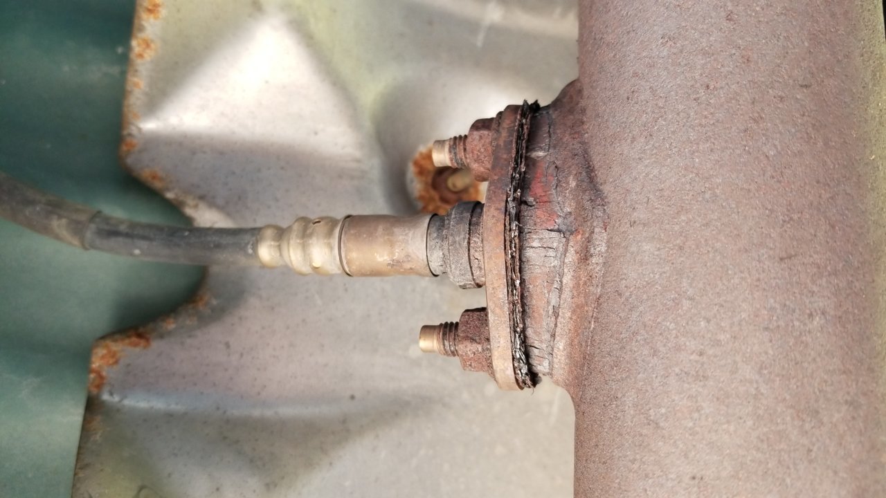

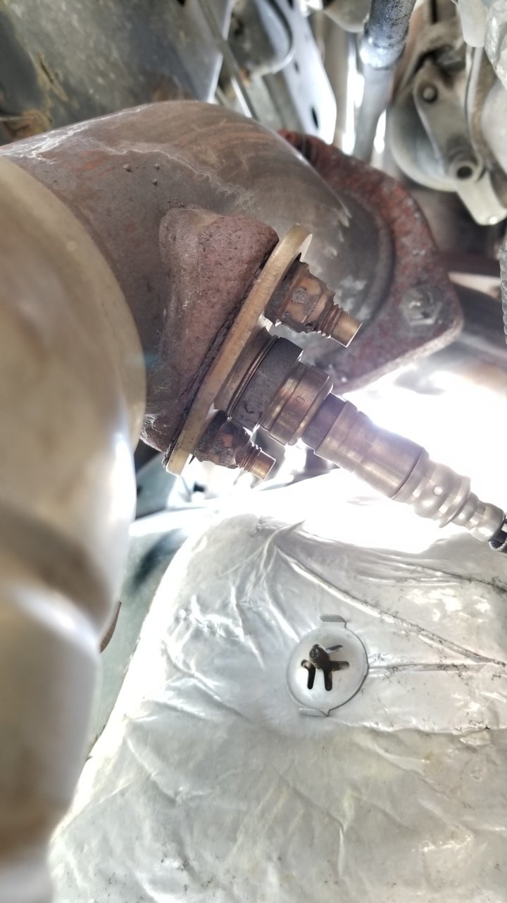

    I believe my issue is my catalytic converter and a sensor. (See pictures of senors)

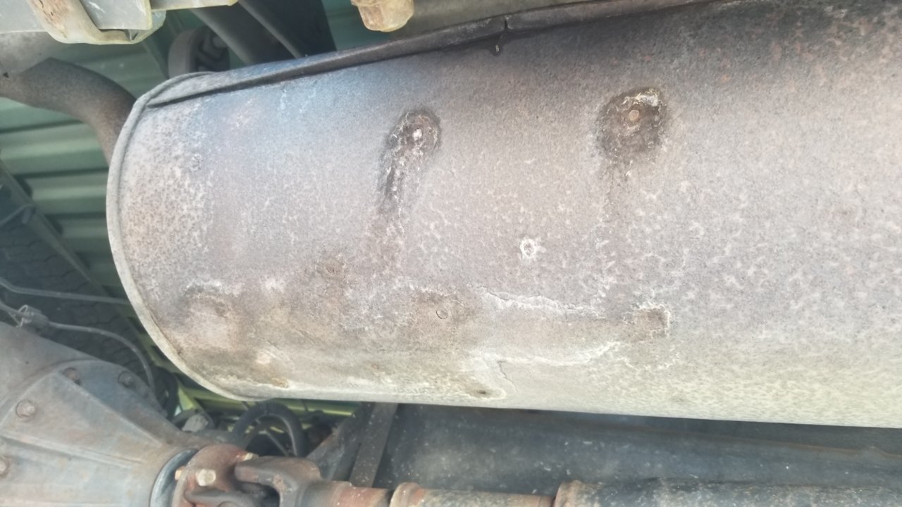

    Also, I had water leaking from my tailpipe and the tip. See pictures of water marks on my exhaust tailpipe, it was dripping just as much from the tip. I didn't get a chance to get pictures or video of it.

    your exhaust should produce a small amount of water, it's the catalyst's function to change the exhaust gases into less harmful ones. the reason the exhaust rusts from teh inside out is usually the moisture gets trapped and not evaporated fast enough due to shorter drives not heating the entire exhaust system up

    water from condensation in tailpipe in the morning is normal. i doubt the p0420 code has anything to do with it other than maybe cat was killed by poor spark and rich fuel.

    @BeardedTacoma your catalytic converter is doing its job, perfectly normal to see that.
    I would definitely look into swapping out those sensors for new. The exhaust leak you're smelling probably coming from the sensors (those gaskets look wasted) and/or exhaust. I snapped off one of the studs for the upstream sensor on my tacoma and ended up using a band clamp to secure it. While its sealed enough to not throw any codes, I can totally smell it.
    Be sure to only go with Denso - computer will be happy. Use this to find your part#s: https://densoautoparts.com/find-my-part.aspx
    Tick the box for Oxygen Sensor and it will pull up your part#s. Once you determine the part you need, hit up Amazon. I tend to not use fleaBay for O2 sensors - too many counterfeits there.

    I recently had a similar issue. Turned out the bung on the rear O2 sensor was corroded and lost a bunch of metal, so I was getting a lot of leakage.
    A good custom shop cut it out, welded on a new bung + new denso sensor and it runs perfect.
    Mine looked worse than yours ... Good luck.
