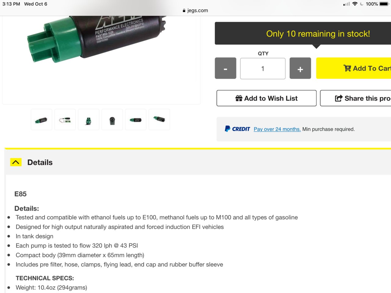

    If your running e85 did you have to change any of the fuel line parts?
    Do a new tune?
    I know my new AEM 50-1220 340Lph pump says it’s E85 compatible,
    Not sure if they all are

    the toyota system can run e85, but you'll need to beef up the fuel system depending on how much power you are making. tune for sure.

    Bigger pump and injectors and both are ethanol compatible but I didn't change any of the lines or else. Took the whole top end apart after about 10,000 on e85 and didn't find any issues but I would for sure think about redoing them if you want it to hold up to long term ethanol usage. It's just a fact that ethanol eats through rubber lines made for gasoline only but for short term use you might get a way with it for a bit.
    Had to retune fore sure. Also not sure on the comment about the system being compatible with e85 but that would be nice.

    Ok thanks, I will stick with what I’m running,
    Yes the 017-50-1220 pump is compatible up to E100.
    AEM E85 High Flow In-Tank Fuel Pump Semi Universal
    Part Number: 017-50-1220

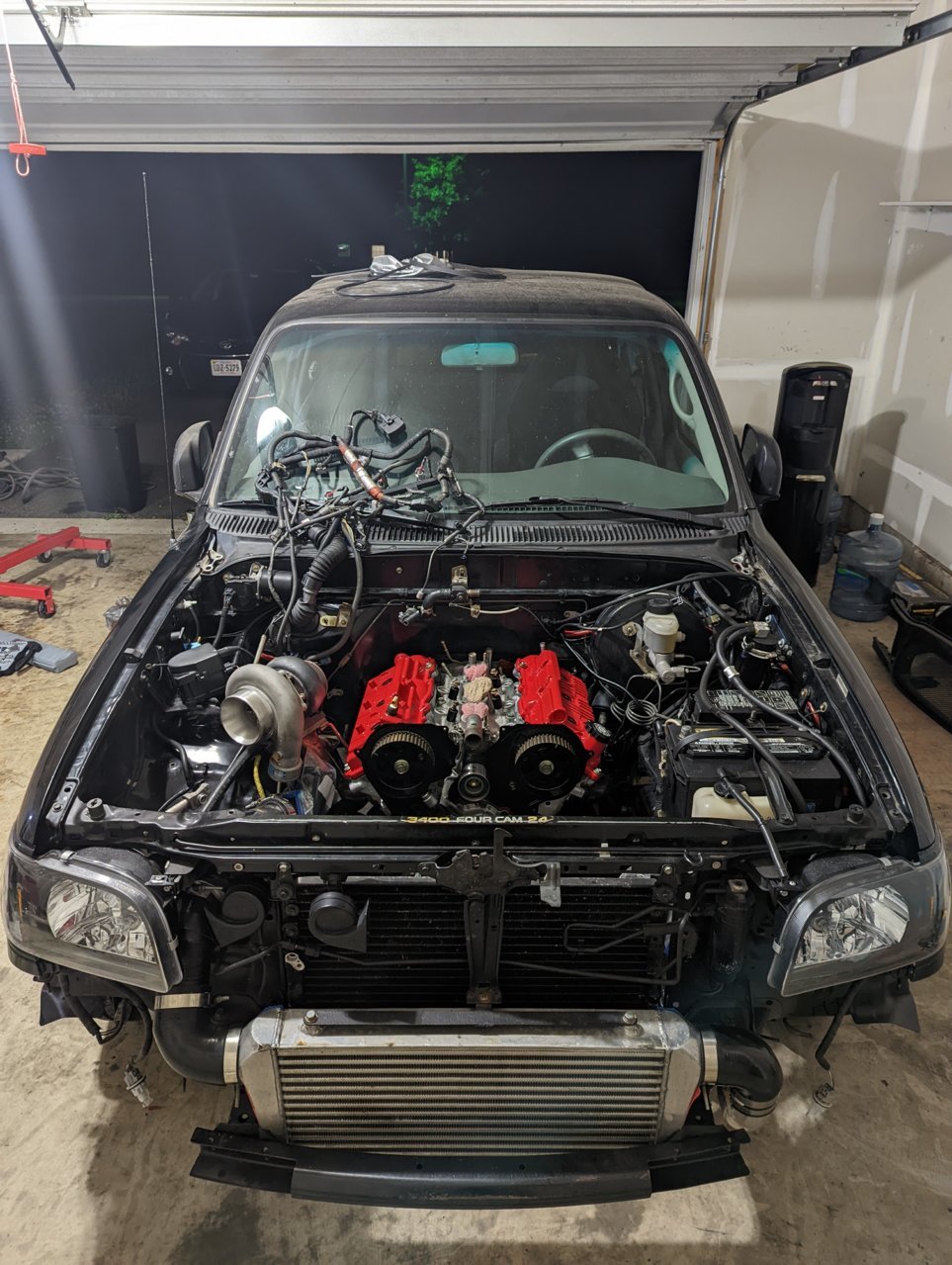

    All but two pieces are installed. Just have to finish TIG welding some stainless tee fittings for turbo water cooling. Then I will add coolant, dump this oil, fill it with break in oil and begin the whole process. Might be able to go for a first time drive by the weekend.

    Looks great and sounds like it has a cam
  19. Aug 18, 2022 at 10:14 AM
    #239
    garetcurry
    garetcurry Well-Known Member
    Dec 12, 2010
    #47615
    207

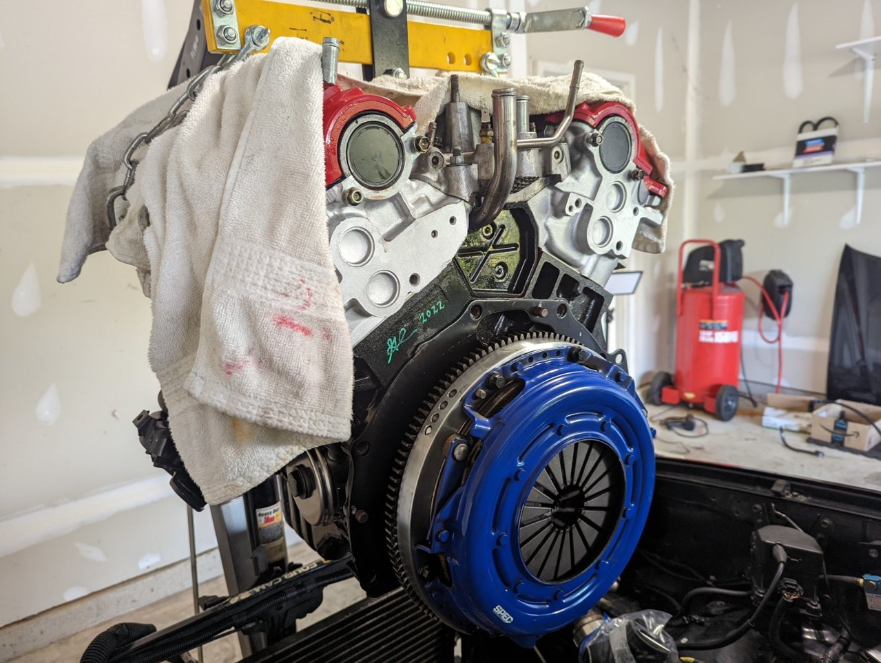

    Must be the lower compression and/or the porting & polish. Lower intake plenum is also ported & polished. The cam that I got from Web camshafts through LCE went back and I'm running stock cams with stainless valves & stock springs. My valve lashes are also all in the middle of the clearance range (verified many times over).
    I never got the complete story as to why the Web cam wouldn't work out. They were offering to do install them but I don't know what it would have taken for me to do it myself. Maybe the valve guides need to be changed to brass? I honestly don't know but the camshaft is on the shelf at LCE if anyone wants it.
    Plan is now 450-500 on pump. Then 500+ on e85. Was also thinking of a 200 shot of NOS in the future. (shrug)

    did you order the shim under bucket kit to go with the cams? that is usually the deciding factor
