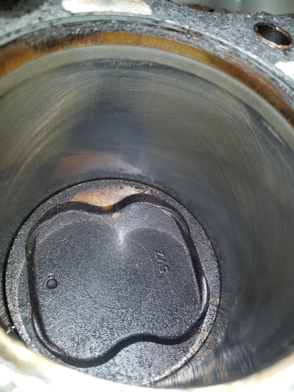

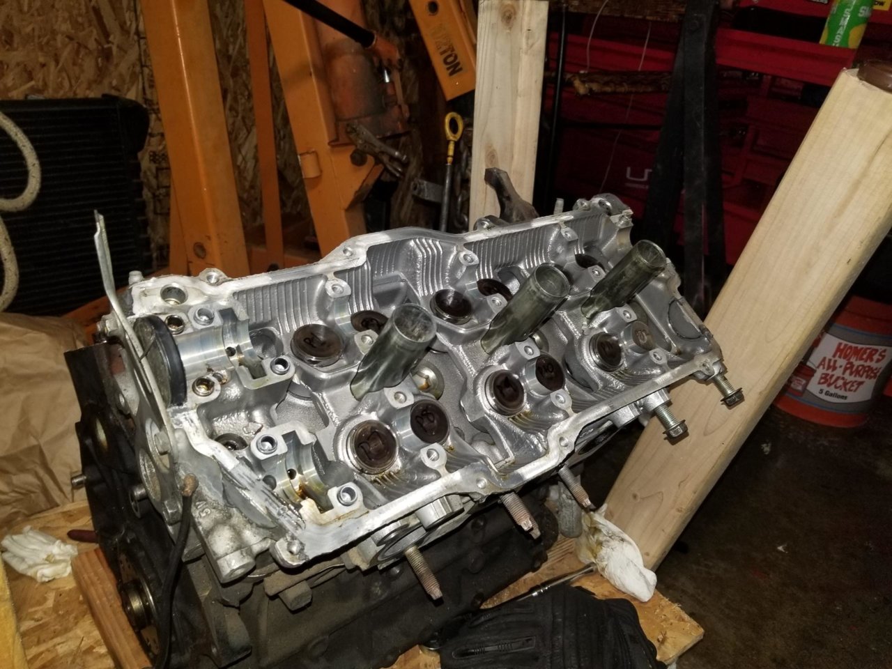

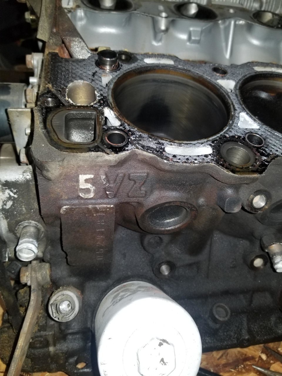

    Ok update for those interested:
    Took my donor motor taken apart completely so my machine shop can take a look at the heads and block to make sure Its good to be machined and rebuilt. Machine shop will be going over the heads, block, main, crankshaft, and camshafts. They will port and polish my intake plenum as well. I will also be having them install my valvetrain kit from LCE so that can alleviate some of the time and potential issues I might have with making sure clearances are ok.
    My donor motor has about 210k miles on it, good compression but just a blown head gasket. Its crazy you can still see the factory machining inside of the cylinders! Testament to Toyota's quality. This is a different motor than the one currently in my 4runner, which has a blown head gasket as well along with 145-165 dry compression, 220-240 wet. So my current motor is worn. Ill be trying to drop off my donor motor this week so the shop can do the inspection before I buy my LCE kit. Hopefully in time for the Christmas discount.
    I will continue to update as things happen.
