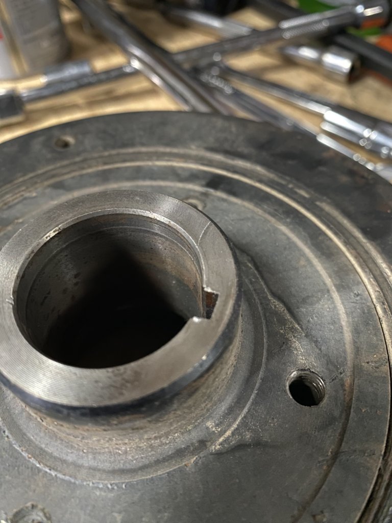

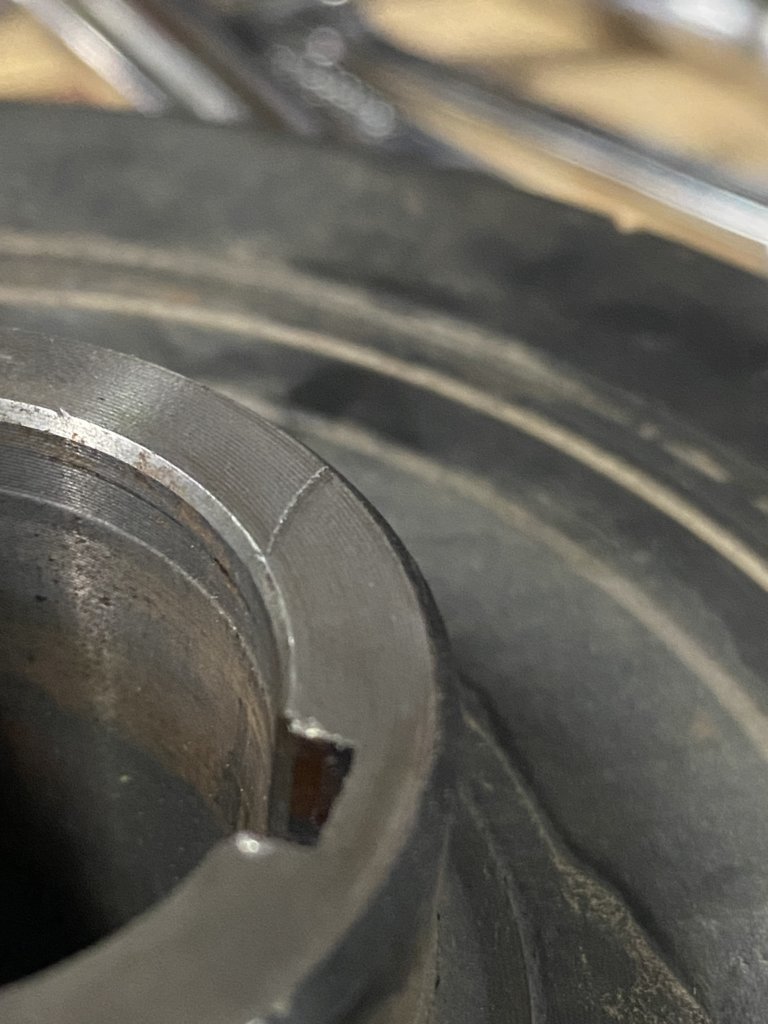

    Yesterday I finished up doing my timing belt and all the other odds and ends in my 3.4 while I was in there and after the job I noticed an increased amount of wobble in my harmonic balancer/crank pulley. The bolt did seem over torqued when I first took it apart, even for the 217 spec and after tearing it apart again I noticed a small mark on the mating surface of the balancer. Could this be my issue? If so and I have to replace should I go oem or alloy aftermarket with a company like lce. I am contemplating on boosting it in the future

    I'd replace it. Harmonic balancers do go bad over time.
    If I remember right it was like a hundred bucks, and well worth the peace of mind.

    Make sure your crank woodruff key thing isn’t worn down / excessive wear & play

    Who ever did the timing belt didn't tighten the crank bolt down to spec.
    The bolt backed off, and the balancer started to wobble, wrecking the balancer.
