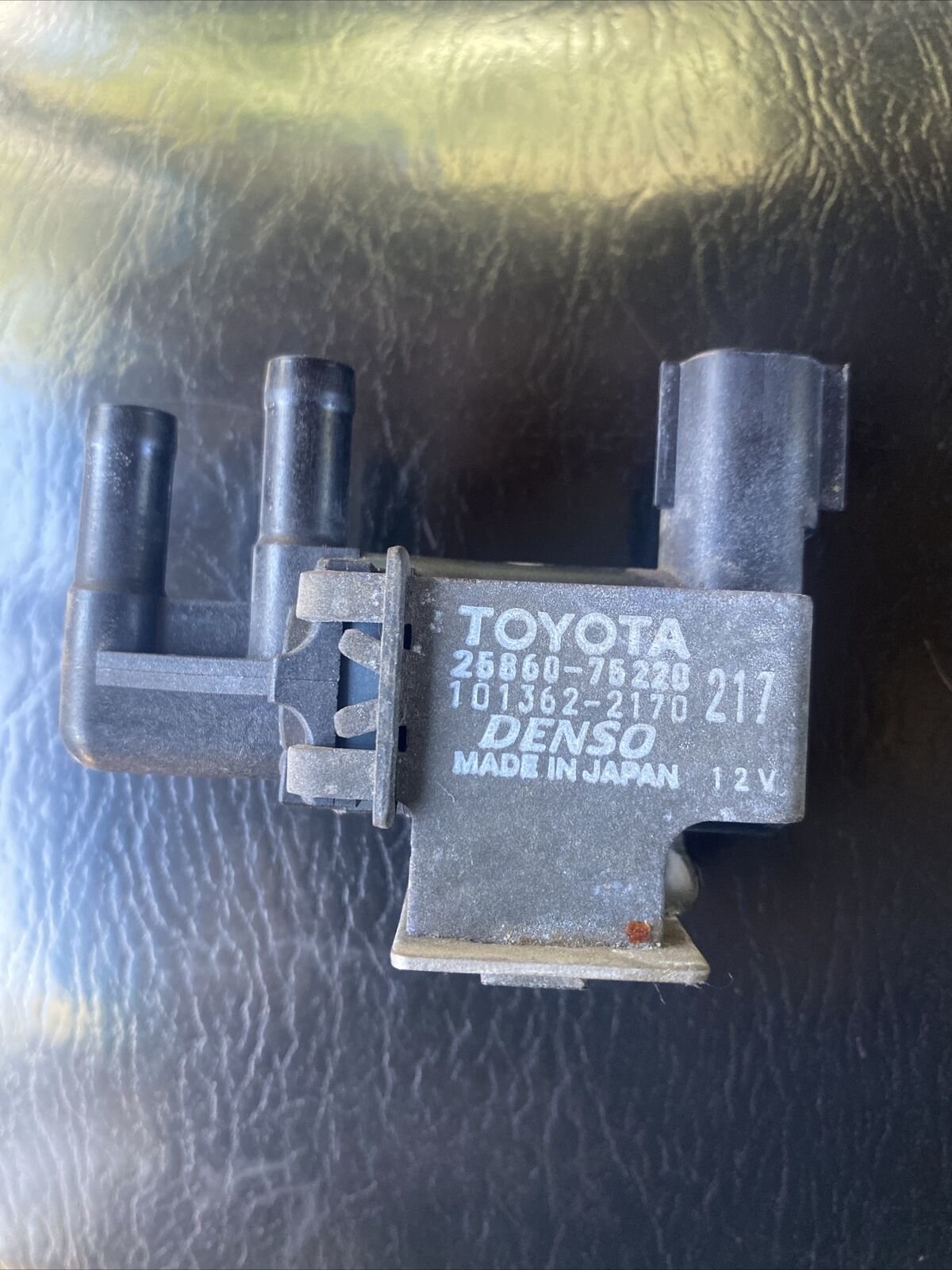

    I have a 2rz.....and sitting in the driver seat....I had this loud ticking....
    when idling after warm up.....drove me nuts...
    If you stuck your head under the hood next to the vapor canister it was louder then the whole engine...
    but especially when sitting in the driver seat...for some reason.....2RZ tho....
    Its was that dang vsv valve out of the canister on the hose to the TB intake .....
    So I went bought a New one.......guess what....the new one... even louder.....
    unbelievable.....I give up....
    Av180r likes this.

    I had this problem too. I also replaced the VSV. And the new one clicked also.. I then found out I had the vacuum lines connected to the vsv in the wrong order. I reversed the lines and no more noise.
    O'Silver_Taco[QUOTED] likes this.

    Dang......pays to hang out here....cant wait to try that...
    If you have a higher end scanner....you can watch that valve opening/closing....
    and the egr one closing as you accelerate....opening again at idle.....
