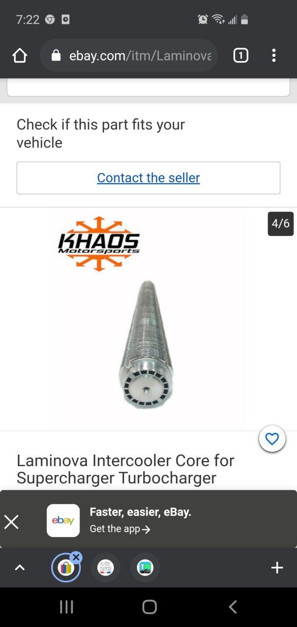

    I would try to do a liquid to air intercooler like the newer versions have. Not much hood space for that though. Or place a couple laminova cores in the charge plenum, make a water box around them, then hook up a pump and heat exchanger.
