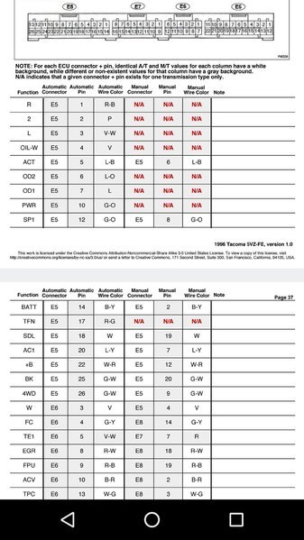

    Hello. I am trying to button up a motor swap on my first gen single cab. I took out the 3rz and dropped in a 5vz. In doing the swap, I also swapped out the engine harness and ecus to a v6 set up. Here's what went wrong: I go to start it, and it dies within 2-3 seconds. The only time it will run is when the key is in the start position. Once I let the key go back to the run position, it dies. Any ideas?

    Looks like I have to re-pin the body portion of the ecu.

    When I did my 5VZ swap I replaced the engine harness and the body harness. If the Re pin doesn't work install the doner trucks harness.
