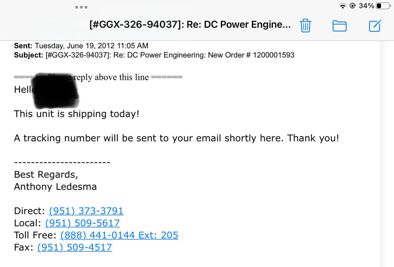

    My DC Power Engineering 180A alternator is going on year 12 for me. I have 2 car audio amps in my truck and it provides all the current they ever need. My electrical systems also loves the higher voltage (14.8V) and current on tap.
