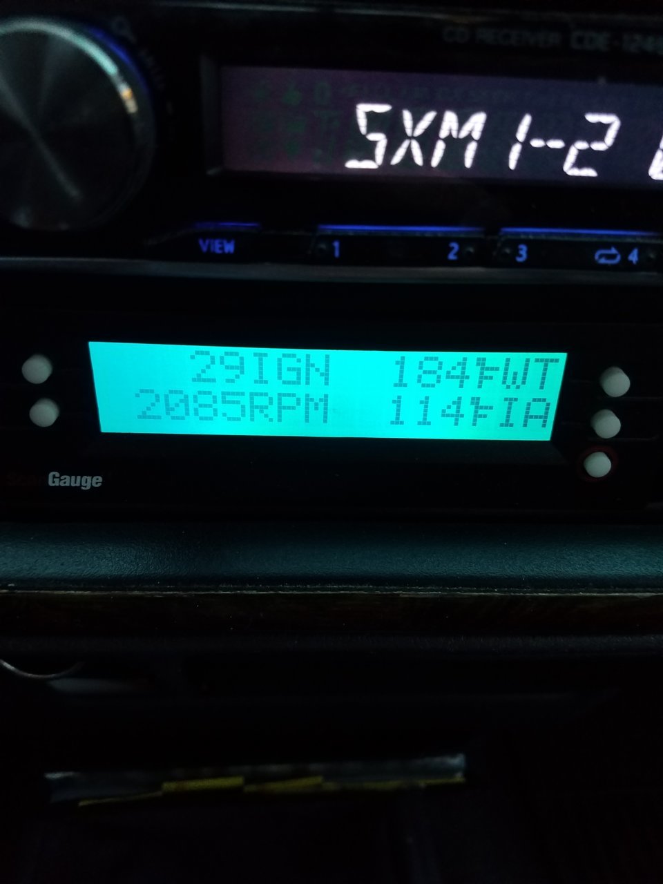

    Does anyone know what the minimum temperature is to get the ecu to go into closed loop - just installed a new champion radiator and the throttle keeps rising to 2400 in open loop saying there's insufficient coolant data to go into closed loop but at the same time I'm watching live data of the engine temp rising as would be expected - the temp is max 184.
