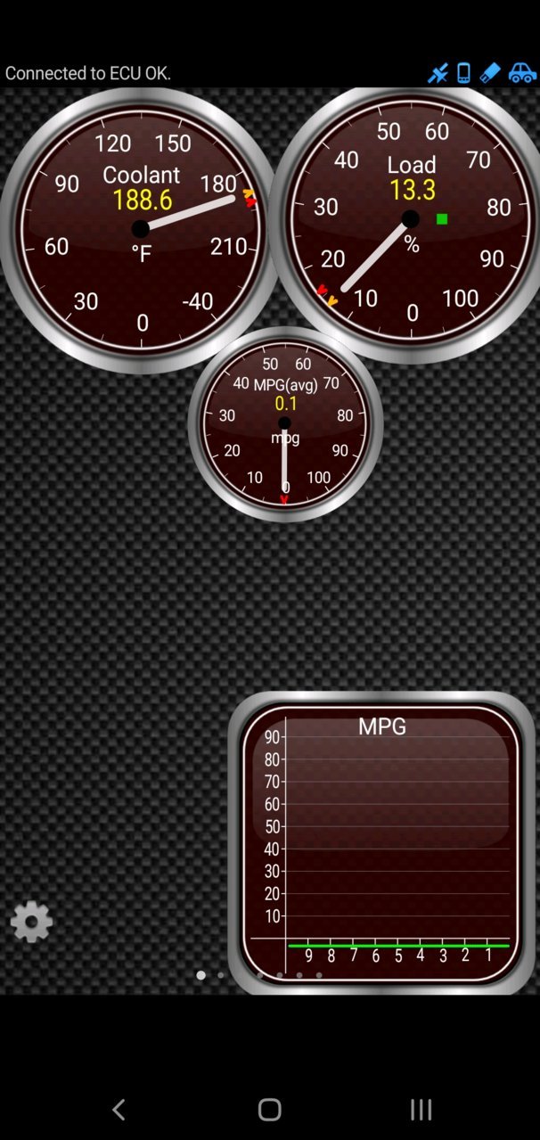

    Just changed my jiggle valve from 12 to 6 and my average temps dropped by 10°! Did the tbelt job 2 years ago not knowing about which way it should go. Very worth getting new coolant and fixing the tstat orientation.
