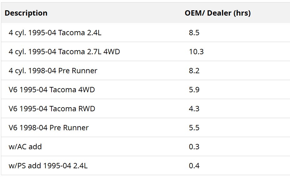

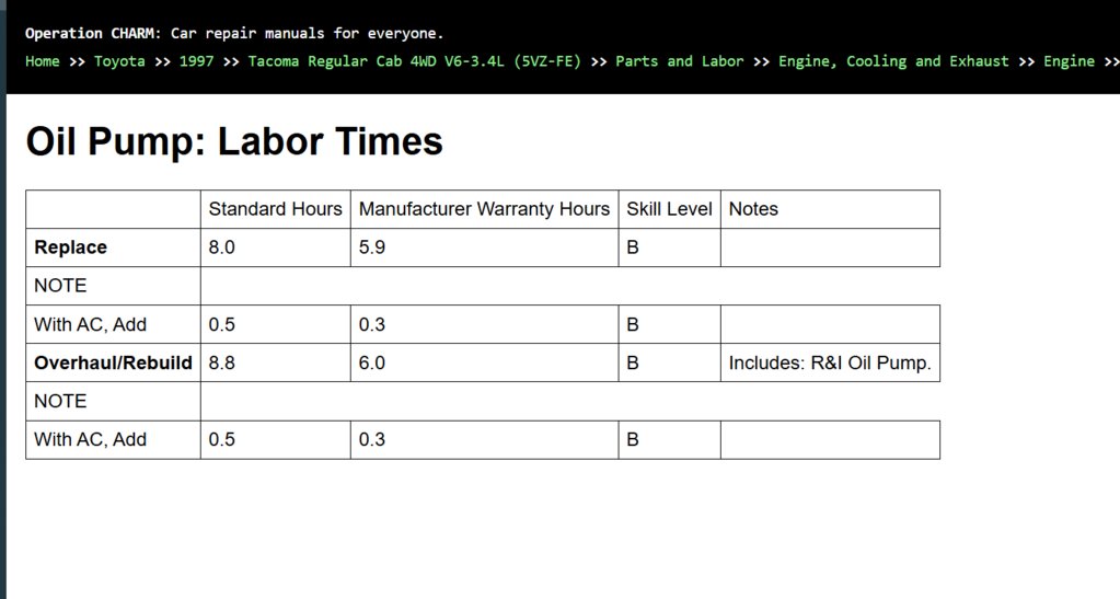

    Toyota lists 5.5 hours.

    Chilton is very close to the same hours.

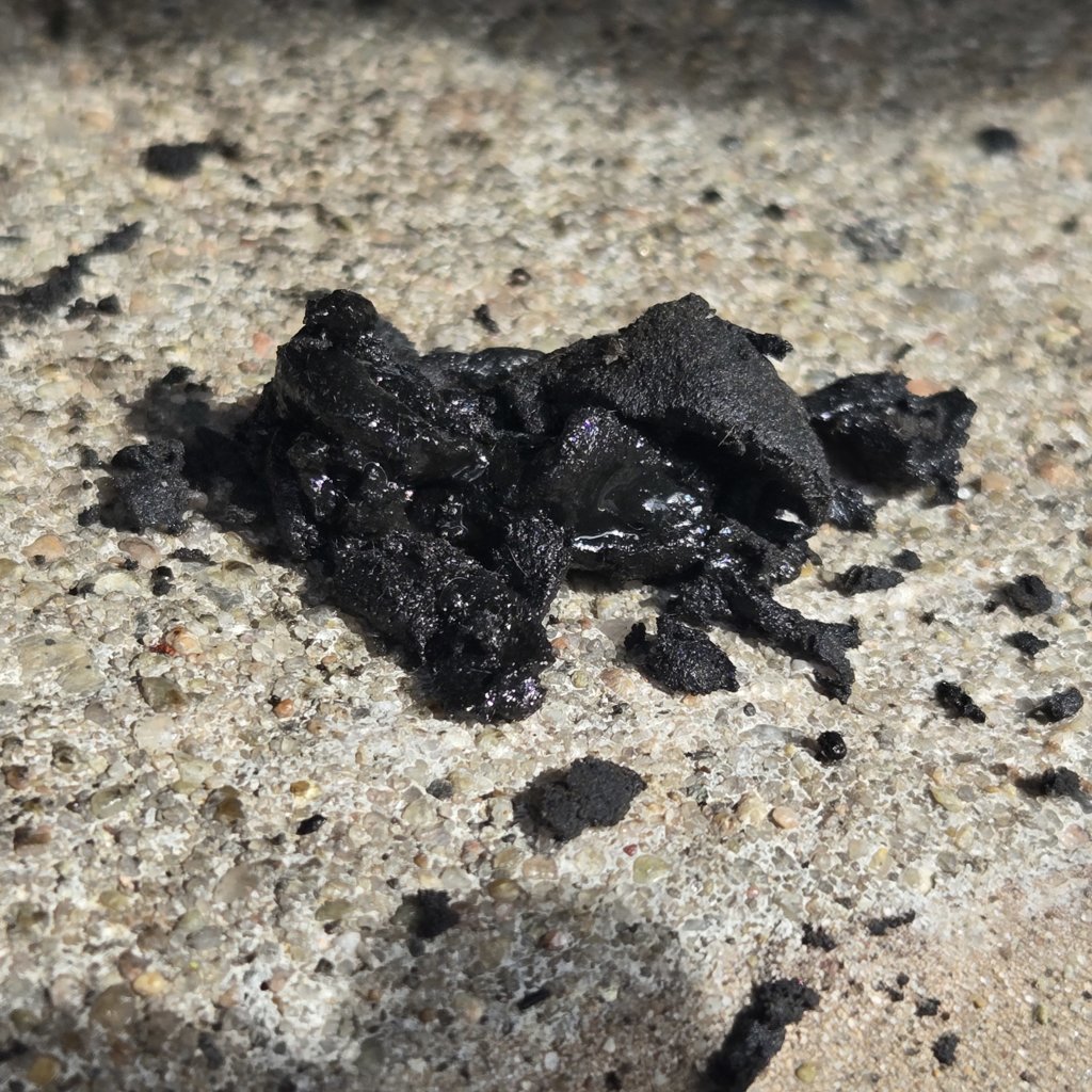

    I looked up the part (if needed)
    A bit over 300$ MSRP
    200$ through the various friendly online OEM discounters
    Maybe it is just the crank seal, it does have big miles in service since it was last replaced
    .. cleaned the caked dirt with oil found yesterday around the area to monitor
    then found a new pool of oil seepage after a hard 200 mile run today...the high winds finally went away so it got some exercise in the aggressive speed range following the crowd :)
    I can post pics of the seepage found in a bit
    And if my ears are good.. with the lack of wind noise at highway speeds the awful whiny noise it's had for the past year at legal speeds sorta went away once we were doing 90... the lack of high winds really helped to hear
    Shhhh..don't tell the sheriff about that, it was needed as part of DIY diagnostics
    Area51Runner likes this.

  13. Apr 28, 2025 at 4:39 AM
    Black97v6MT
    Black97v6MT [OP] 365k on the 0D0 ... 5VZFE R150F 4WD
    May 9, 2024
    #449422
    1,234
    iMA0
    tacoLand USA
    28 years of livin' Gen1 TacoLife...

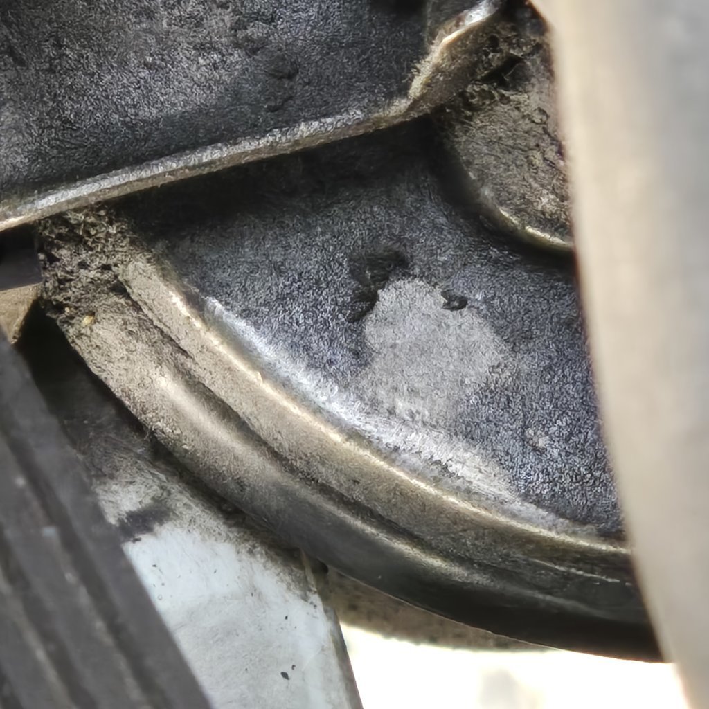

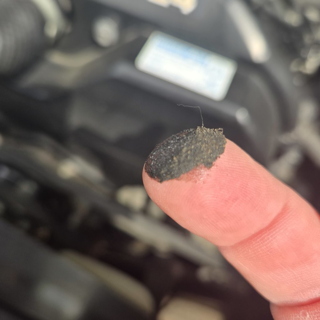

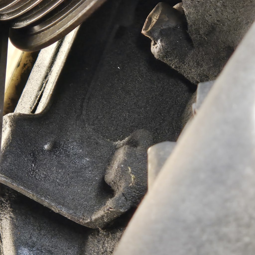

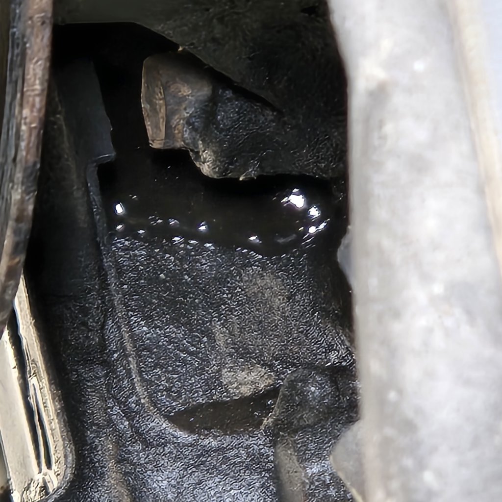

    ok... here are some pic's from the other day
    before cleaning it up a bit.
    oily dirty mixture
    knocked All of this dirty off that 'shelf' area digging in there with the finger and degreaser on a shop rag
    after yesterdays 'spirited' 200 mile run i checked the area and found This pooling up.
    nothing has dripped to the ground as of yet...

    Can you post another picture of that leak but zoomed out? I can’t tell where that is.

    it looks like it is right under and behind the crank pulley
    that crusty looking bolt head is for the lower timing cover (i think)

    wish better news......
    looks like that 5.5 to 5.9hrs is is warranty time(you know what your doing)

    hard to tell what you got from the pics, but safe to say its not the compressor....

    It may be just a small seep from the front of the pan that gets blown up onto the 'shelf' on the freeway...lots of wind
    I went out this afternoon after I got back home and checked for same pooling and could not find it! Oil level looks ok
    Ran a blind finger down in the area and could only find some small wetness where the front oil pan mates up right in that area
