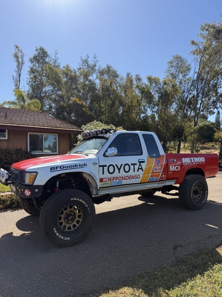

    Cool looking truck tho. Are those 37s?

    You won't believe me, 33s! Currently on 33s with 16" beads

    I was way off, looks great though.
