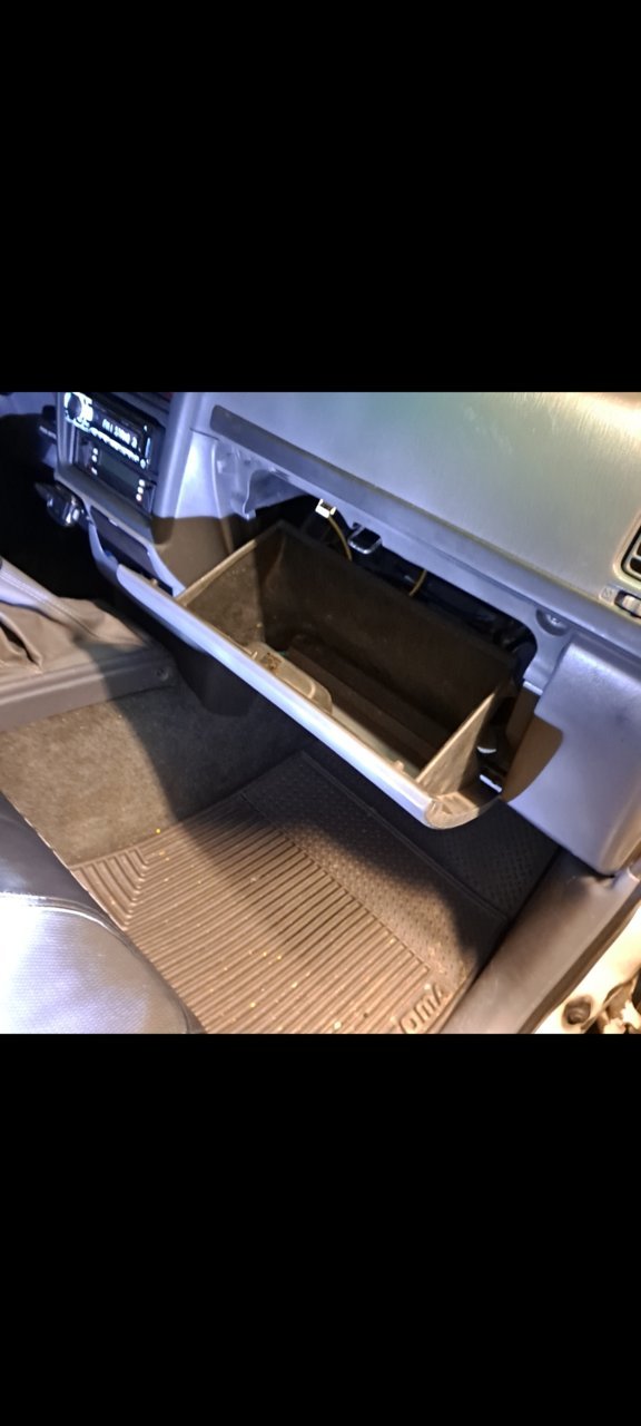

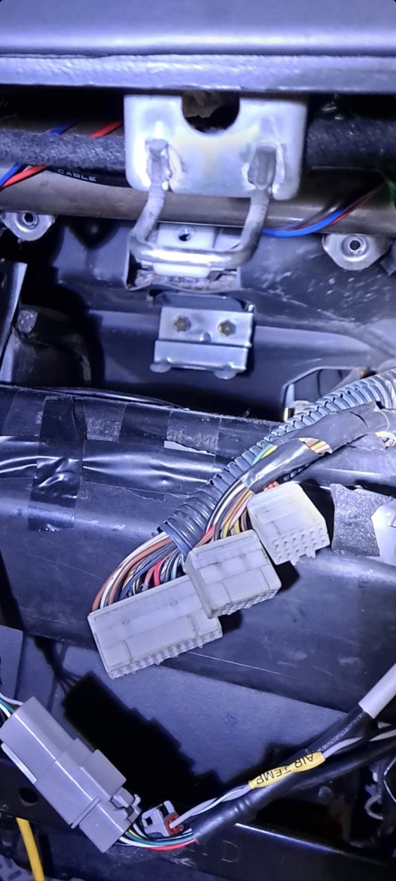

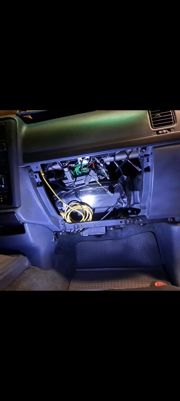

    You would need to make your own harness that would plug into the specific tacoma plugs or ecu if it's done as a piggyback.
    I'm not 100 perfect how the kit comes but would be easy to ask haltech, they are available anytime for support and when your getting your haltech setup unlike most other companies

    Looks like the Haltech doesn’t include any connectors, but a connector and pin kit is available from Haltech for around $75. I guess they figure most people would be using a pnp harness anyway and don’t include the connectors with the unit. I searched for a breakout box (these were common in dealership shops years ago, nobody ever used them and they always got stuck somewhere collecting dust) thinking I could rob the female connector off it to make my own pnp harness and found this https://www.diyautotune.com/product/diybob-breakout-adapter-nippondenso-76-pin/
    This is exactly what I need to make a harness to adapt the Haltech to my factory harness without hacking it all to shit. Whenever I modify anything on this truck I try to do it so I can revert back to stock if I want to. I don’t know why I do this. I am never going to sell it, I have been driving it almost daily for 22 years.
