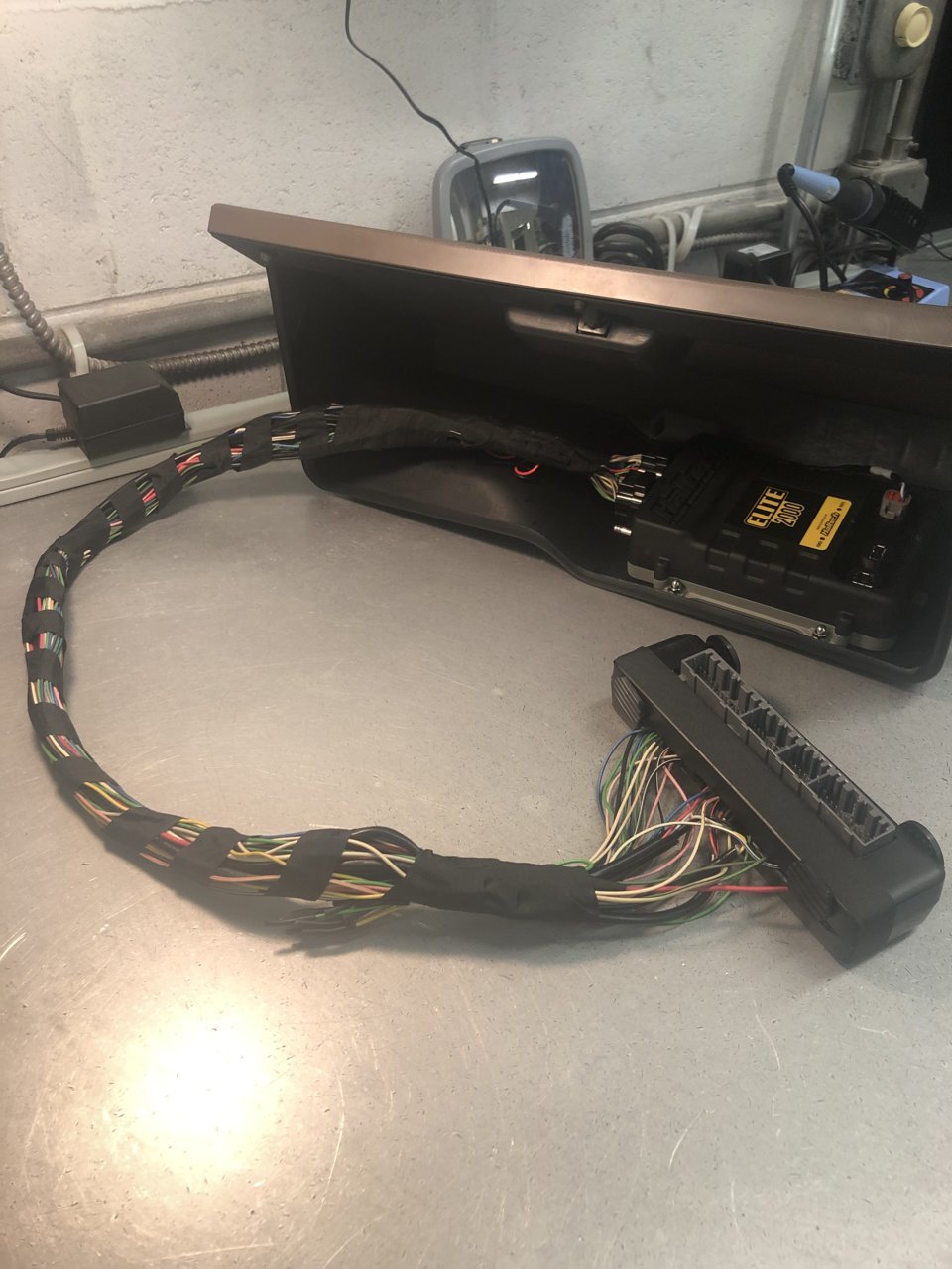

  16. May 4, 2022 at 8:38 AM
    #56
    DrabT100
    DrabT100 [OP] Ex-Lexus Tech
    Jul 8, 2017
    #223507
    207
    East Coast
    1997 T100 Turbo
    Turbo
    ECU is mounted in the glove box and my homemade harness is done. Still waiting for CX manifolds
  17. May 4, 2022 at 9:35 PM
    #57
    1997tacomav6
    1997tacomav6 V6 5sp,RegCab,TVS1320 Supercharger,Haltech, 800k
    Oct 5, 2013
    #113940
    10,419
    John
    Denver
    97 reg cab, v6 5sp 300hp supercharged, Methonal Injection, 800,001 plus miles, Original Owner
    V6 5sp,RegCab,TVS1320 Supercharger, 56mm pulley, methanol injected Haltech ECU, AC Tvs1320 supercharger,(MUST DO) every 125,000- 150,000 needs rebuild Projector headlights HID 5 speed manual Amsoil for all drive train Smaller 56mm custom pulley, (MUST DO) 2004 DESNO fuel injectors, zero ping ping, 2004 side door mirrors Dick Cepek Rims, Michelin tires LTX, ATM Pathfinders Dynopro ATM ( that last 100,000 miles) Now running Dynopro ATM mud and snow tires KN cold air intake Cat back dual exhaust with ss exhaust tip, Raised exhaust tail pipe to 2" below body line Optima*dry cell battery,red top Alpine sirius radio, 200 watt amp, focal is165 split door pod speakers Focal door speakers Subwoffer behind seat Viper alarm, Electric Locks Dark tinted windows, bucket seats corbeau lg1 Tacoma Rubber floor mats TRD fender extenders, Bilstien shocks, King shocks JBA UCA trailer iv hitch, electric brake control, Drilled slotted brakes, High carbon steel (MUST DO) EBS green stuff 7000 series pads(MUST DO) TRD engine oil cap TRD stick shift, Marlin crawl shift kit. Rear sliding window 2002 4Runner functional hood scoop cut into Tacoma hood, 4Runner dual overhead map light Gentex Auto dim + Compass + Temp, garage,rearview mirror Snow Methonal kit stage 2 Custom 3 core aluminum radiator Linex bed liner Haltech stand alone ECU, Intake supercharger gauge. Stainless steel brake lines, Custom leather wrapped steering wheel, Haltech stand-alone ECU,
    May as well wire in a kill switch on the power side of the haltech just in case someone was thinking of borrowing your truck,
    I put my haltech behind the glove box to be safe.
    Out of sight
  18. May 5, 2022 at 4:31 AM
    #58
    DrabT100
    Jul 8, 2017
    #223507
    207
    East Coast
    1997 T100 Turbo
    Turbo
    Kill switch is a good idea. I do have some concerns about having the ecu so visible but there is no room at all in my dash. I will probably make a cover out of kydex, like a false back wall for the glove box, if you know what I mean.
    1997tacomav6 and boostedka like this.
  19. May 5, 2022 at 12:18 PM
    #59
    treyus30
    treyus30 70% complete 70% of the time
    Jun 24, 2015
    #158054
    8,406
    Trey
    Mesa / AJ, AZ
    '99 5VZ-FE Twin K03s w/Haltech
    Historic plates and 2 bar
    I'd consider shielding the cam position wire and using twisted pairs where possible
    Speedytech7 likes this.
  20. May 6, 2022 at 12:59 AM
    #60
    DrabT100
    Jul 8, 2017
    #223507
    207
    East Coast
    1997 T100 Turbo
    Turbo
    Cam, crank, knock sensors are twisted/shielded
