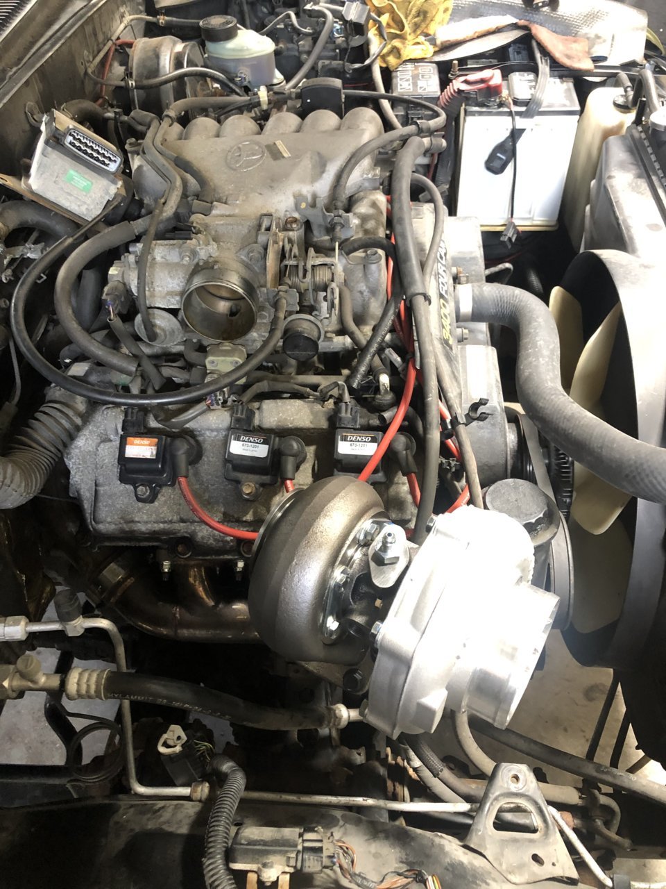

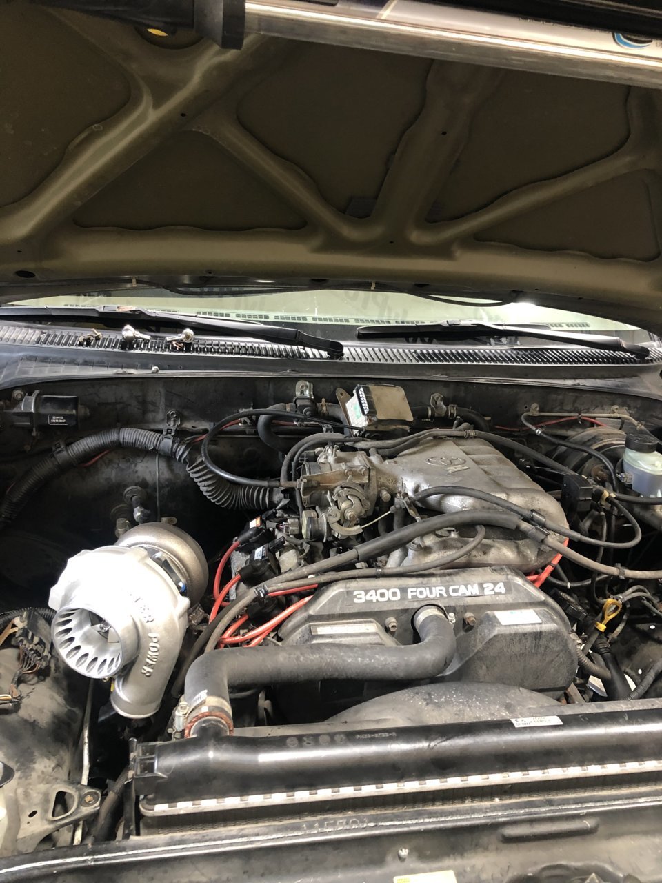

    I did. 13psi as quick as you put your foot down. Undrivable in the sand even in 4x4, just digs down. Choked up top through the SC rotors even with bypass valve open. Tuned with Fic. Fun, different, expensive.
    Overall I like just turbo way better. Pulls much harder even at just 8 psi.

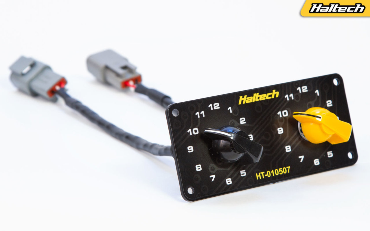

    Ya this would be in the realm of making it a racer, taking it to tracks.
    I wonder if haltech be able to control alternate operating modes? Like having a switch for the twin charge setup, and then one that basically just runs the supercharger in its “carb compliant” ways? Probably not i imagine.

    I’m sure that could be done.
    You would have to setup two different maps in the haltech and a switch to go back and forth from map A to map B.

    upload_2022-5-11_6-36-42.jpgThis

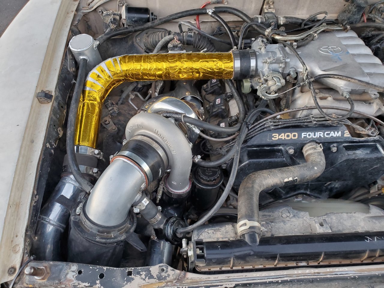

    Quick update:
    CX is telling me another 6-8 weeks for the manifolds. Gauges have been installed, oil pan is tapped with a return and ready for the turbo. Planning to rough fit the intercooler this weekend. Basically it looks like some poser tuner car now with some go-fast parts but no power lol. Only thing missing is the mandatory monster tach screwed to the dash with drywall screws. Oh and the shift light-spot light for effect.

    https://youtu.be/IDqIIXl2z2Q

    liked for drywall screws lol

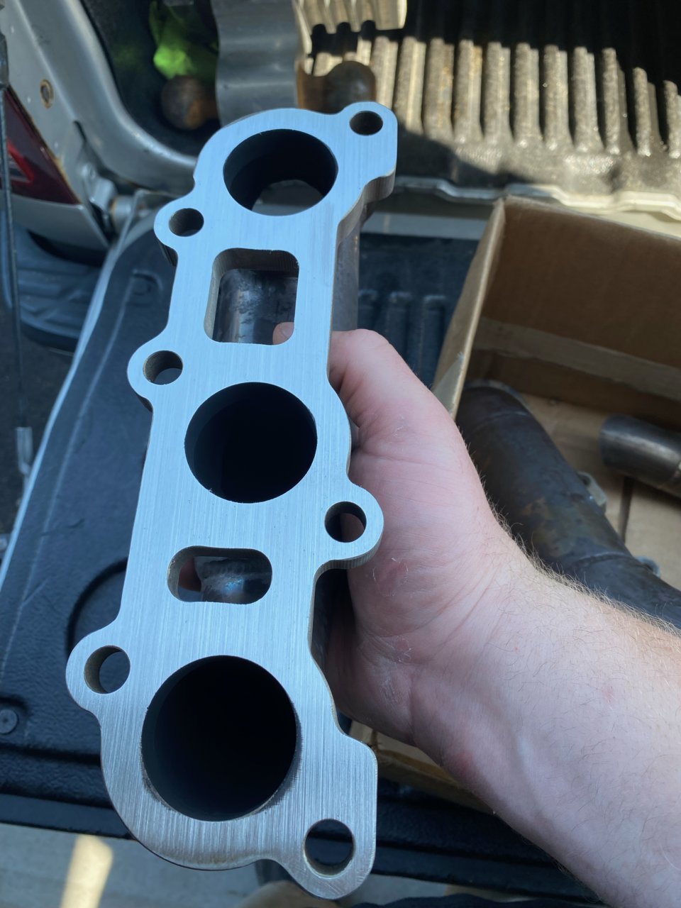

    Quick update: manifolds are in hand (thanks Brice), just got them back from the machine shop. I should have everything I need to get started the weekend after Fathers Day.
