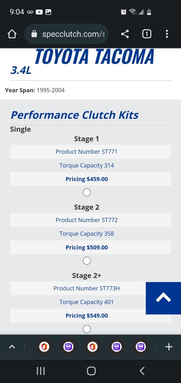

    Thanks for that. LCE is where I was looking earlier. Not too many choices out there. Probably go with the dual comp. The clutch in my truck is an Aisin replacement that has about 30k on it.

    Also look into Spec Clutch. I had the stage 3 on my 1j drift car back in the day. Very durable clutch, no problems ever and I was always clutch kicking it.
