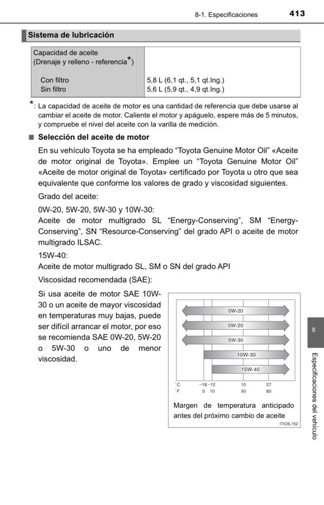

    RC60F Transmission 5.29 R&P FJ Metal Clutch Pedal OEM Mexico-Spec Condenser Fan 265/70R16 Michelin Defender LTX M/S 2 OEM 1-Piece Lug Nuts Custom Built Switch Panel for all Electrical Accessories Rigid Amber Pro D-SS Ditch Lights Rigid 30" SAE High Beam Driving Light Bar Rigid SR-Q Pro Back-Up Light Kit (Recessed) VLEDS Tail Conversion VLEDS Bed Light Kit VLEDS Foot Well Light Kit KC HiLites Cyclone V2 Under Hood Lights Customized 2WD Low Operable (Switched) Clutch Safety Bypass
    That’s the factory service manual. It’s the Mexico owners manual that is in Spanish.

    it is in standard 3rd gen tacoma manual, available since 2015 and you still blame EPA

    Well, technically the CAFE mandated by the EPA is why what’s recommended in our owner’s manual is in there…
