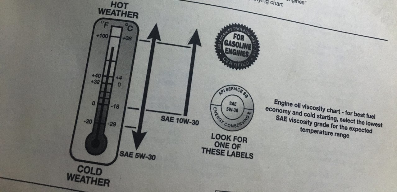

    here straight from the manual use 5w-30 and a yota filter and call it a day
