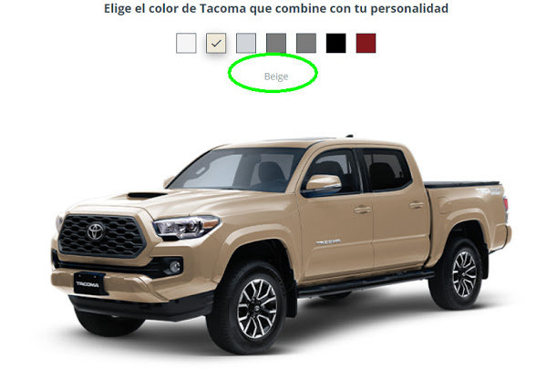

    Be careful! In Mexico, Quicksand is called "beige". Instant depreciation.
