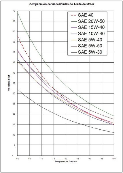

    Knowing that 5W30 is the recomended oil for v6 2nd generation, if you can't find the right grade, just go with the oil with nearest upper viscosity curve.viscosidad-aceite-motor-operacional.jpg

    ...^^^... Nice graph ... will use that for reference.
