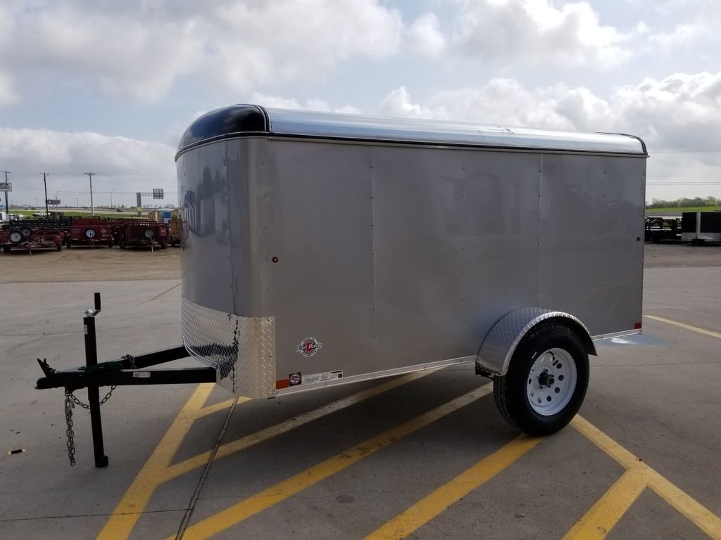

    Hello all,
    I'm in the market for 5x10 cargo trailer - something I can convert or modify for occasional camping use, but still use for hauling. I prefer the round top/round front style over the flat top/vee nose style.
    Any recommendations on best quality trailers to look for, and any brands to avoid? (i.e. Hasn't leaked in 10 years vs leaked the day I bought it.) Brands that let you customize your trailer?
    Looking for something similar to this, from image search:
