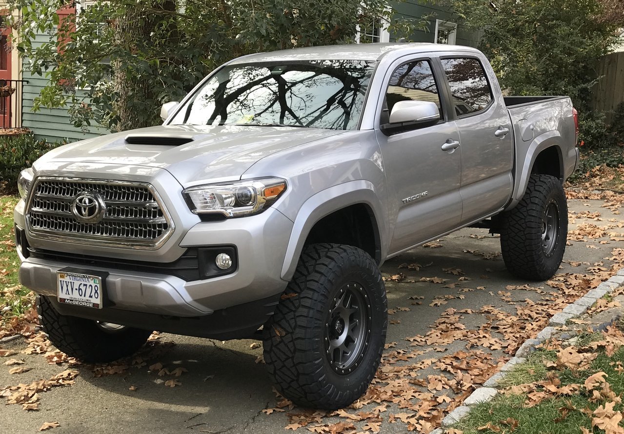

    Obligatory truck pic.

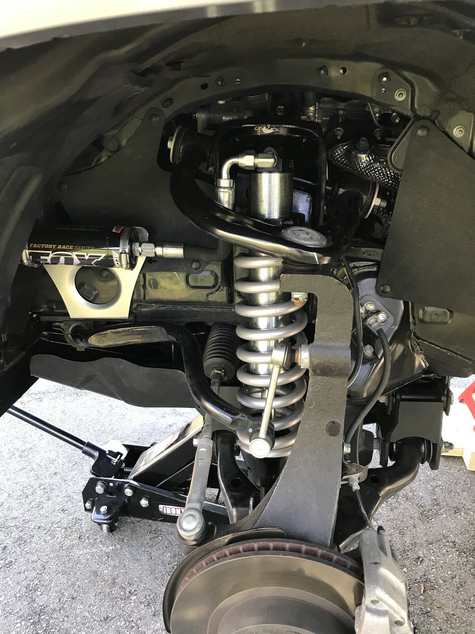

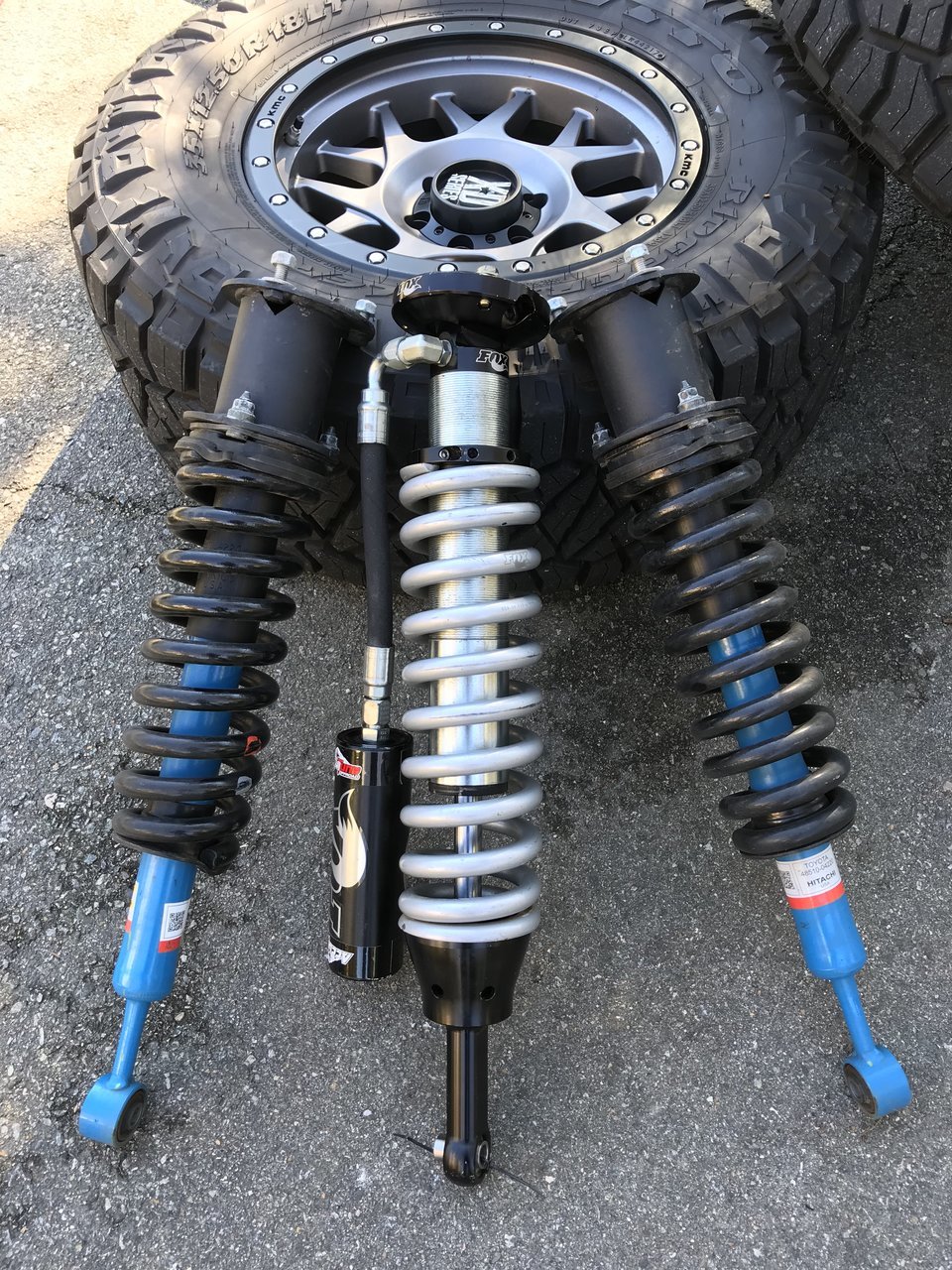

    So I should have updated. I found a second hand set of full length Fox 2.5" with reservoirs. They've been off for custom tuning and are ready to install.

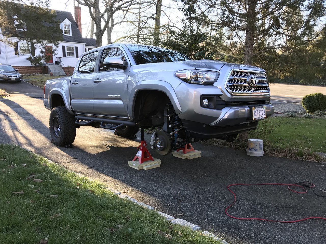

    Finally installed the coilovers today.
    F3BCF1AD-DF27-4E7B-AAFC-DDBFC07034B5.jpg 09179E71-56EA-4467-B4A1-B7CC631086E4.jpg 13A258F3-46DE-4E0C-924F-35BD55AF569C.jpg
