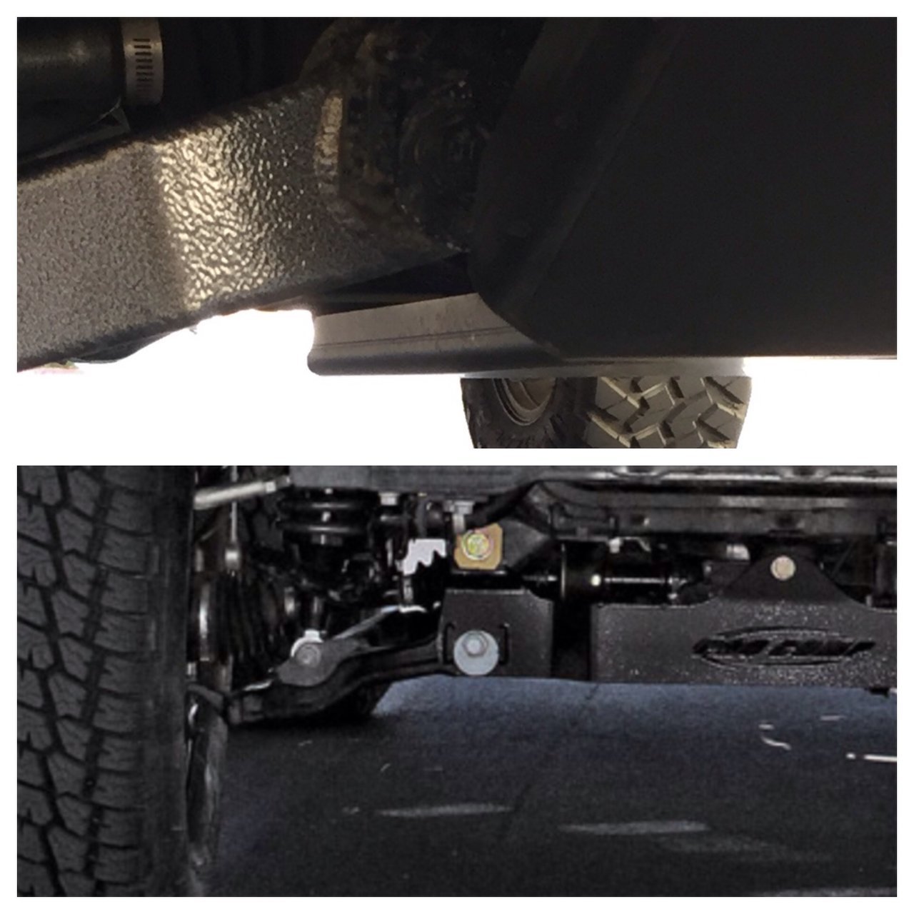

    Well actually you are just regurgitating what you have heard other equally ill informed people say. I hate to squash your drop brackets don’t have as much ground clearance bashing party with facts and evidence...but yeah the facts can be a bitch sometimes.
    Fact = that all other factors being equal such as amount of pre load etc a drop bracket has in fact more ground clearance than a well built 3” truck with full skids. Top photo is a fully built Long travel truck with skids, bottom photo is a bone stock 6” lift. See how in the top photo the OE LCA mounts and skids hang down 1 1/2” below the LCA ...now look at the drop bracket lift and see how the drop bracket is level with the bottom of the LCA...yup facts can be a real bitch...the drop bracket has more ground clearance.
    Next, your statement about flex is bullshit too, you want photos of a drop bracket front end pulling more travel than your precious 3” lift too ?

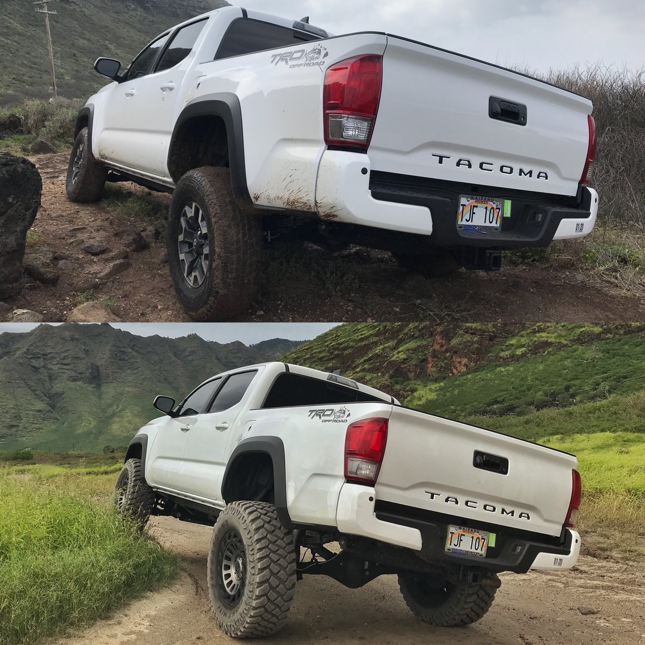

    Jason

    Nope, if you added skids to that truck in the pic it would still have more ground cleareance. Look at the pic again and look at the relationship of the LCA mount to the bottom of the drop bracket and compare that to a stock Taco even with an OE skid. Most folks ragging on drop brackets such as him are assuming that a fully built 3” truck has more ground clearance and is infinitely better for off-roading etc...and what built 3” truck doesn’t have skids ? So what I’m driving st here is that a drop bracket mall crawler actually has more ground clearance than a built up skidded off road truck.
