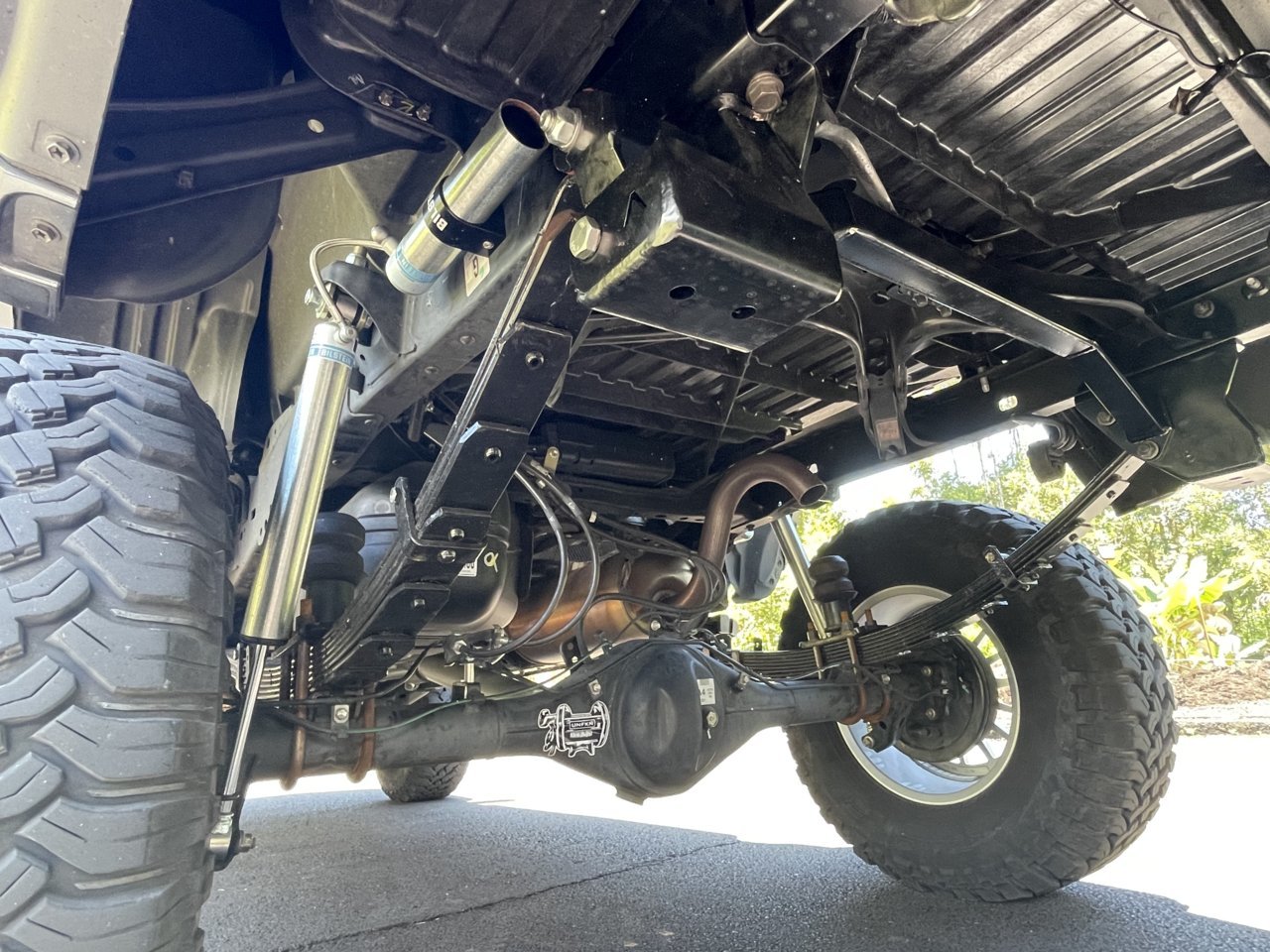

    I bought this truck a few days ago w a 6” lift in the front. Looks lime a 4” spacer in the rear. The rear shocks are shot. Any suggestions and part numbers so I can swap these out? Thanks in advance!!!

    Those prob would but Im lookin for somethin not as high end. Standard Bilsteins or even Eibach but not crazy

    awesome. Ya. Thats more what Im lookin at. I can’t find them on Amazon but I emailed this vendor. I believe mine is 6 in the front and 4” spacer in the rear.

    I’m using Bilstein 5160’s model #25-175783
    28.5 extended, 16.97 collapsed, 11.55 travel

    nice! Thanks man. I went with the Fox but good info for later or someone else!!
