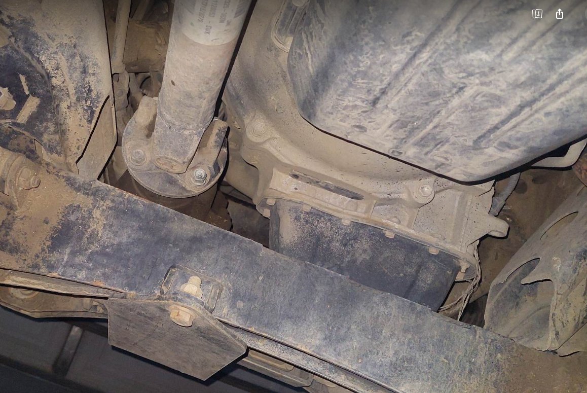

    Hey Y’all! I’m 17 and I am looking to start really going heavy on mods and do a long travel kit. My problem is that the previous owner cut out the rear of the two front crossmembers to install a 6” Procomp Lift. How would you recommend I Fix the cut? I was thinking the most solid solution would be to cut out the same section from a junkyard and re-weld it back in.

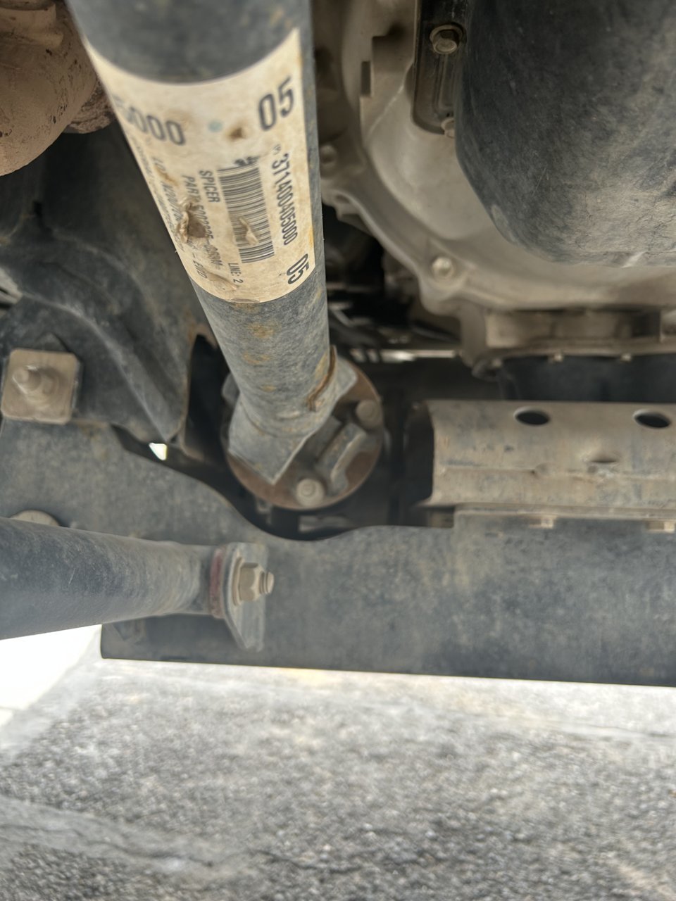

    I have the same problem but they cut more than ur last owner.
    please tell me if you fix it :)

    Probably just as easy and stronger to build that section in with equivalent sized rectangle tube.

    Yes any 6" kit requires cutting the front rear x-member for front driveshaft clearance. The procomp, bds/sone, and Rough country require the cut like your truck (and mine). The fabtech kit in the second post requires the larger cut due to the nature of the bracket as the Fabtech bracket sits higher up for clearance.
    I had 2 friends running drop bracket kits on trucks the bought used and had added long travel kits to the drop bracket lifts. Neither have had issues as the drop brackets are much burlier than the stock tubing especially on that member. Both are extensive unique builds!
    If you were to go back to stock or LT without using the drop bracket, you will also need to purchase standard spindles or whichever normal travel spindle you are going to run. There is a member on here that sells gusseted stock spindles which would be a great option. There have been a few member that have tacked in some rectangular stock and then welded sanded and painted.
    My opinion, your best option is either to run the 6" lift and add LT to make a monster truck... or sell your truck and start with a Non-drop bracket truck. LT is a serious commitment from both a financial and fabrication perspective. My 2 cents it would make the most sense to find a truck with the best frame you can find before going such route and make sure it is really something you want to do.

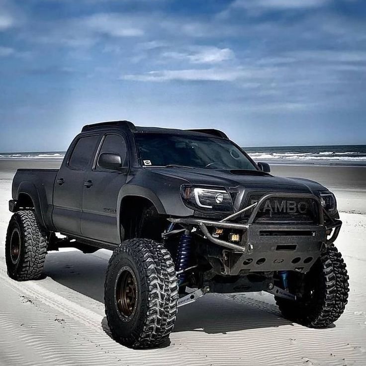

    I actually do not know if either truck is on here. Both are guys I connected with initially on IG. I will try to get more info I just messaged both to see if they have a build hiding on here. Tylers truck I think was on here when he started it but I am not sure. He is on TC LT kit with a ProComp 6"

  11. Mar 22, 2023 at 5:40 AM

    Damn, that’s for “all the lift”. Any idea what size tires those are?

    He’s on 37 x 13.5” I believe currently! The truck is an absolute unit saw it in Florida! He told me he doesn’t have a build thread on here. Top notch stuff and he’s at like 200,000 miles now
