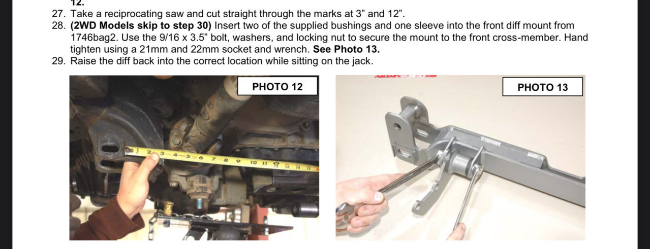

    Hello,
    Do I still have to cut the crossmember if I do a 4” Rough Country lift? I’m not doing any serious off-roading anytime soon, and if I do get into it then I’m definitely upgrading shocks and leaf pack so don’t worry about that. And my next question is there any difference between the two?

    Yes, I got this straight from the installation sheet.
    The difference is 2” ???
