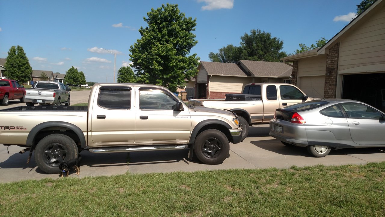

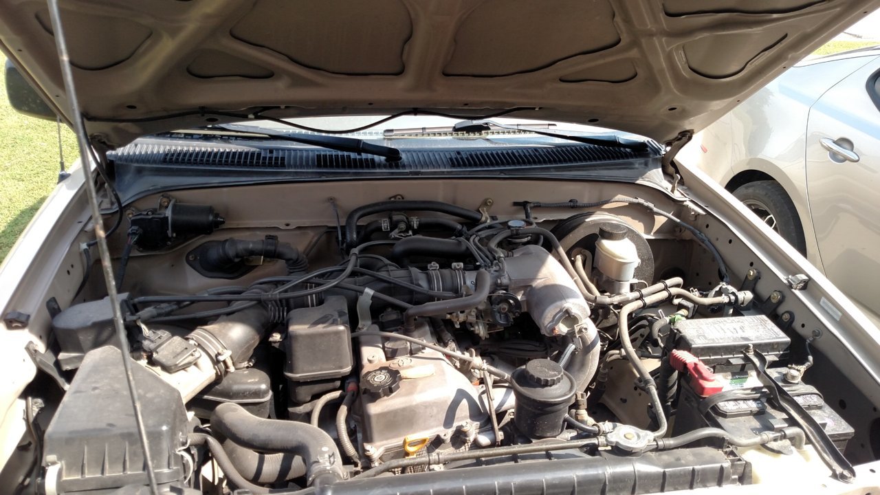

    This is the double cab IMG_20180516_163822199.jpg IMG_20180516_163855153.jpg

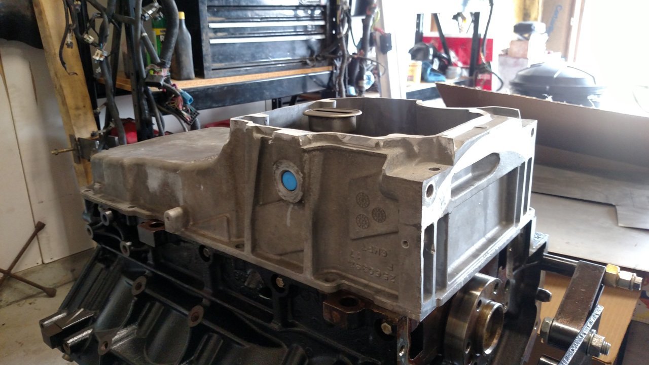

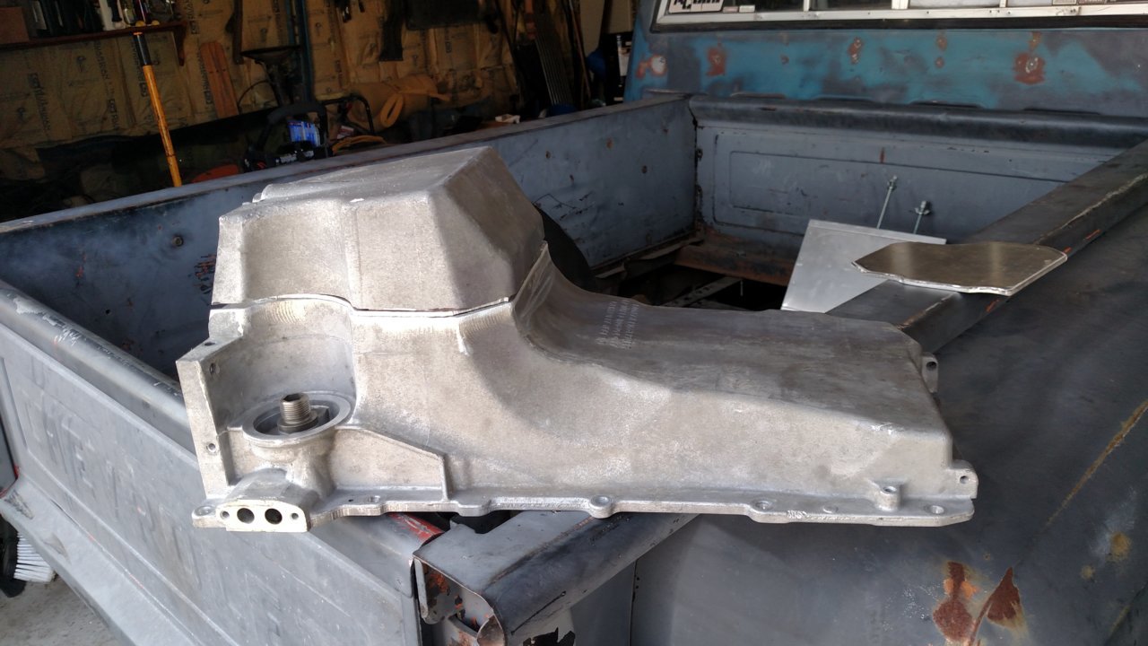

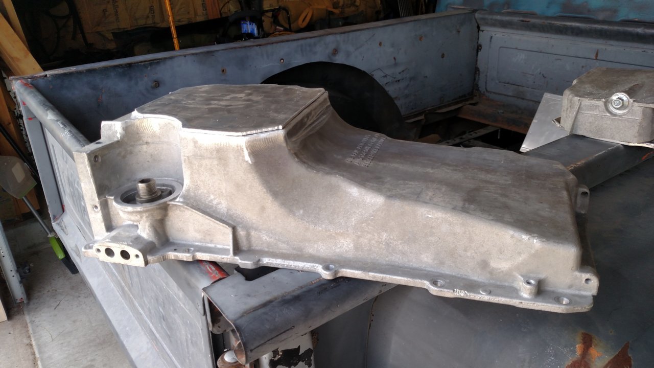

    This is a ls truck pan that shows how much I had to cut off to make this ls fit. IMG_20180812_104316525.jpg

    Pan will be welded with a 1/8th inch plate of 6061 after the pick up tube is matched to the new correct hight.IMG_20180812_104357904.jpg

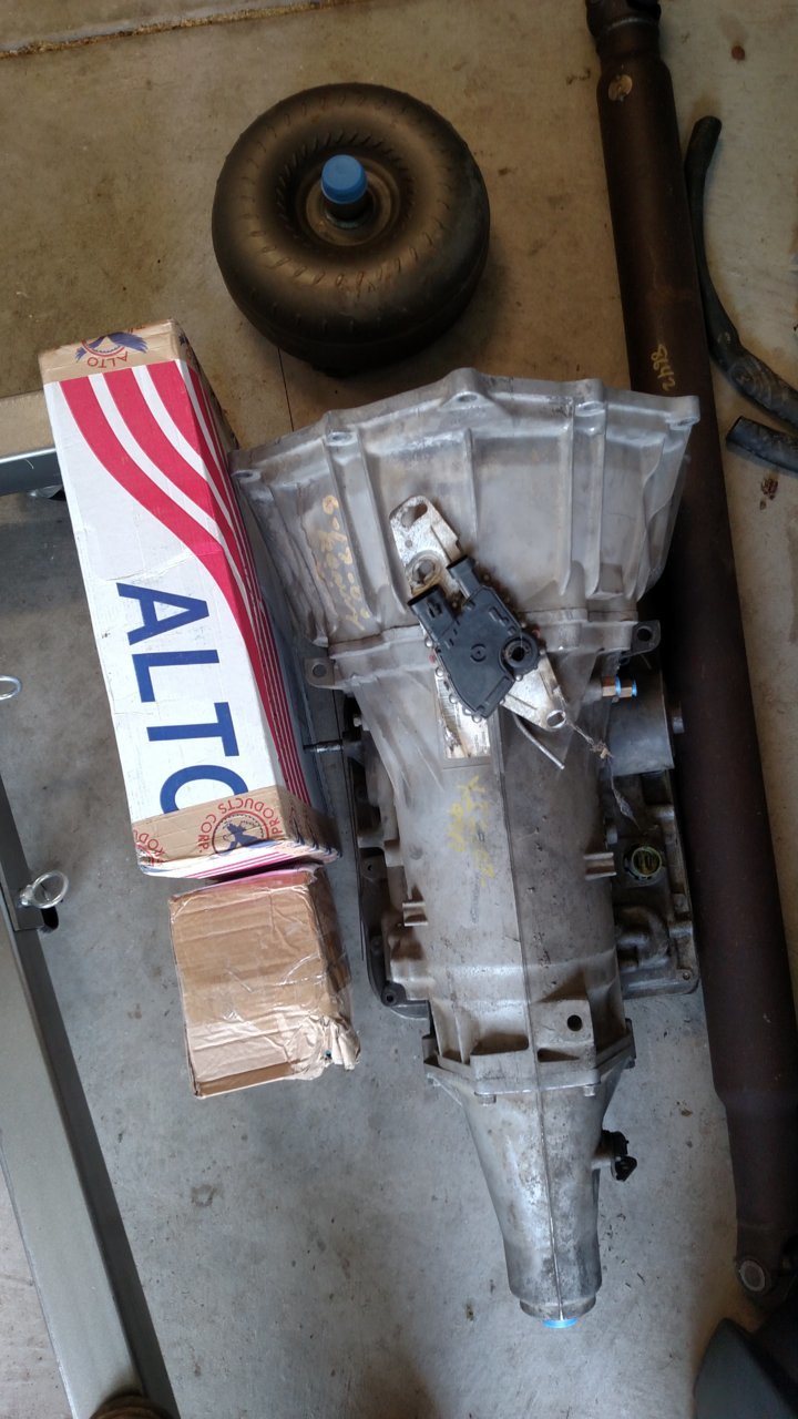

    2wd transmission and rebuild kit untill the 4wd mess comes into playIMG_20180812_105549684.jpg

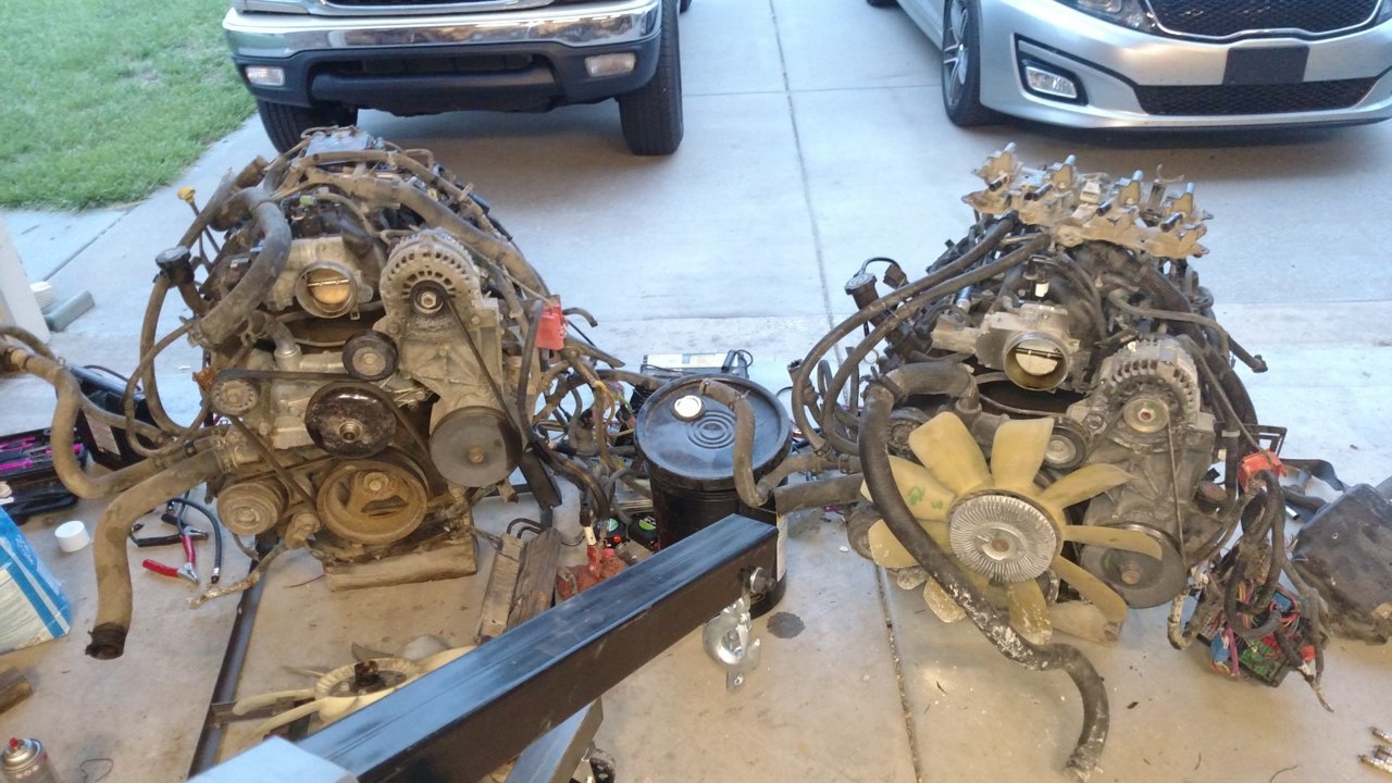

    You can not have too many 5.3s handy

    Poor little guy. It does have a new head on it though if anyone is interested in it.IMG_20180812_110547536.jpg

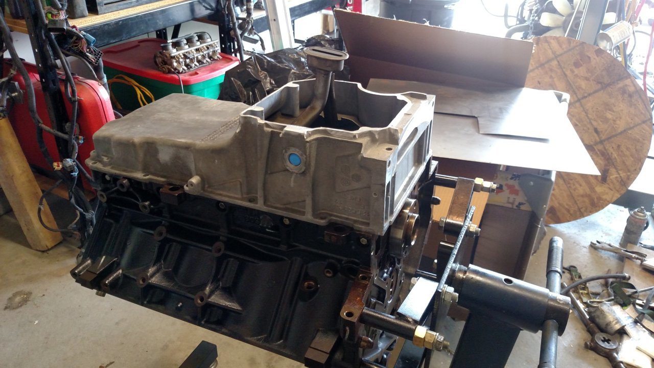

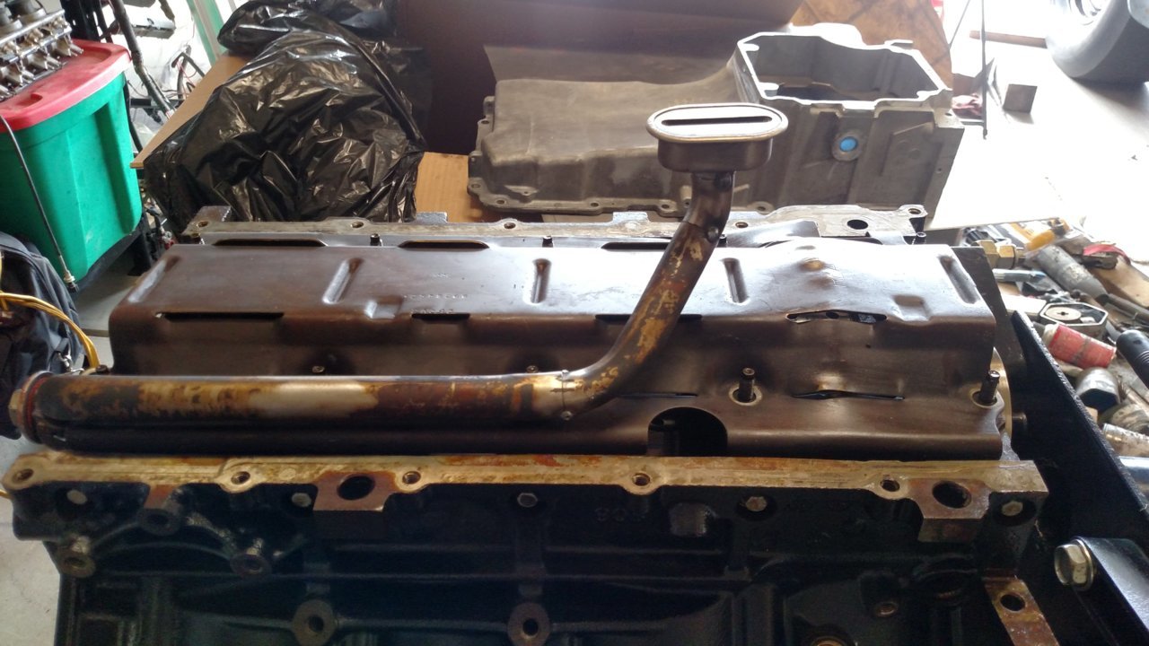

    Pick up tube chopped and tackedIMG_20180812_135752852.jpg IMG_20180812_135757727.jpg IMG_20180812_140958213.jpg

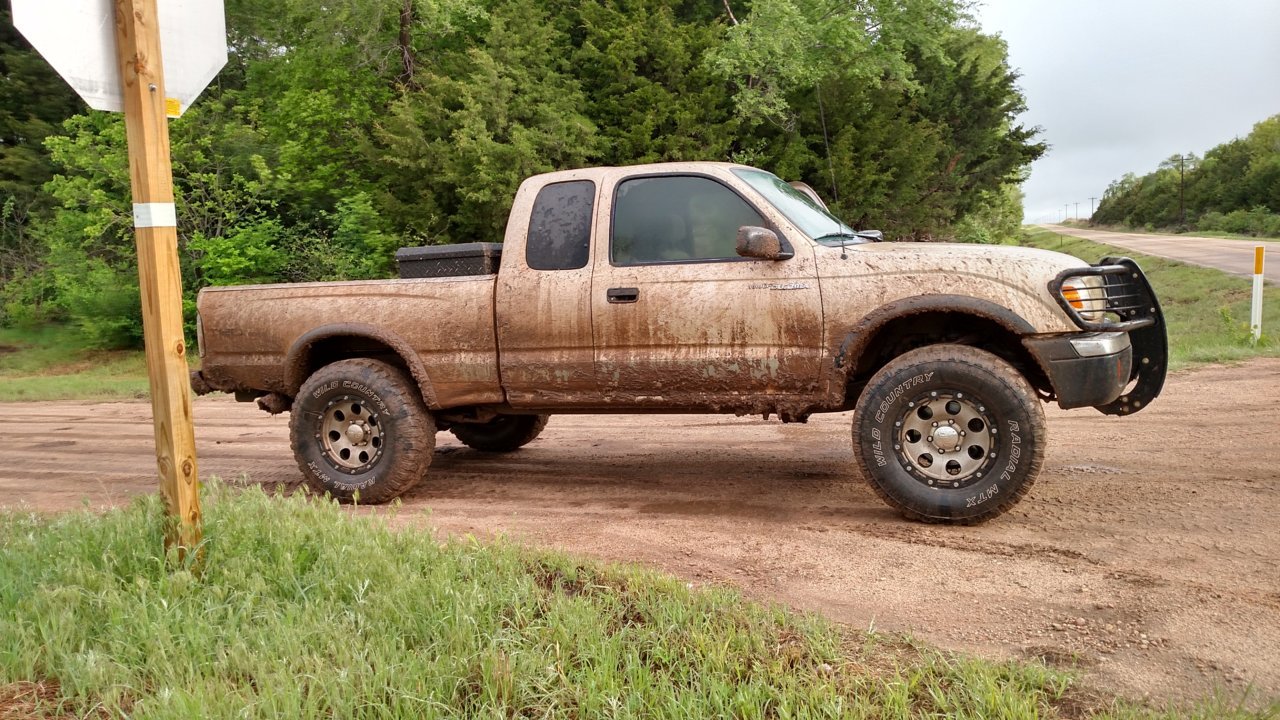

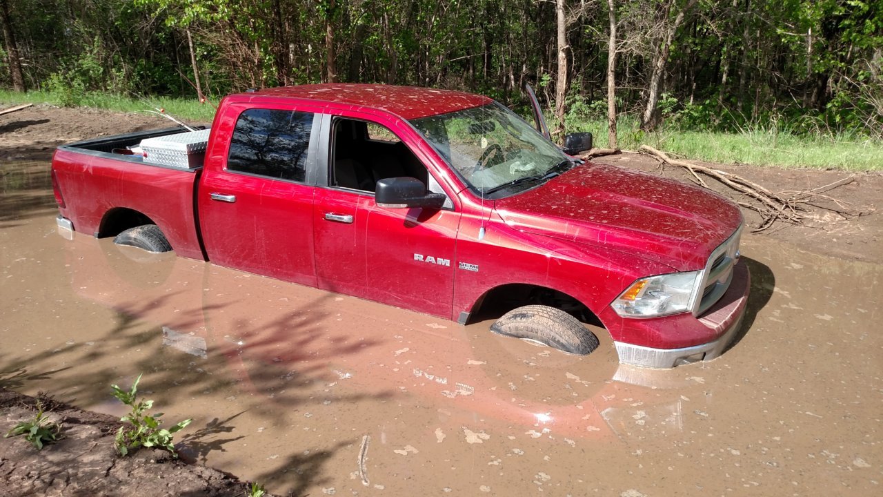

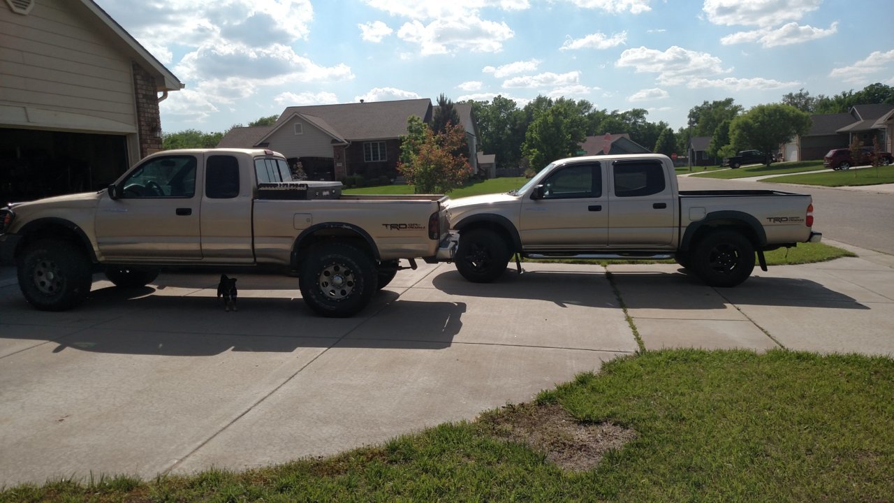

    I'm not ruling 4x4 out yet but I've rarley had to use 4wd, mainly the diff lock would get through most situations. Unless you don't have a Tacoma. Although I usually have to use 4wd to pull everyone else out. IMG_20160430_170107192.jpg IMG_20160430_083600657_HDR.jpg

    It is mostly the angle of the dangle on that picture

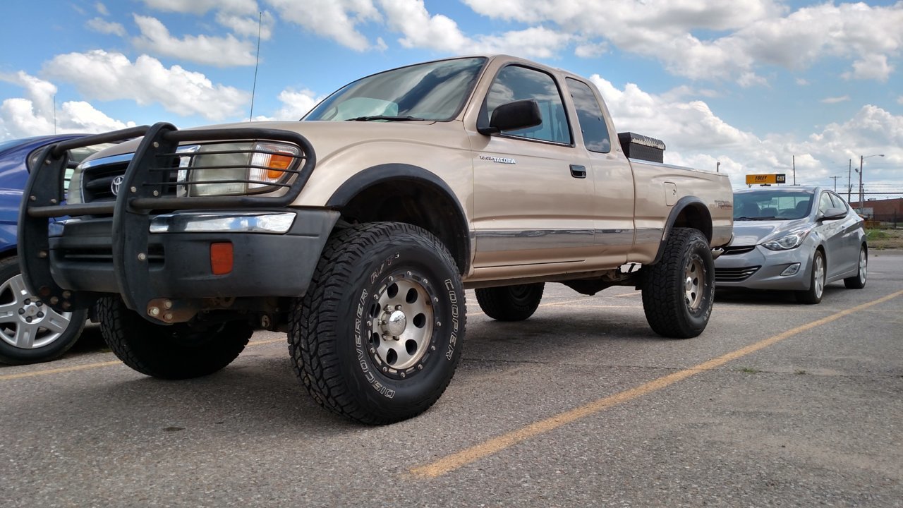

    This isn't the same truck that's getting the 5.3. was just talking about 4wd.IMG_20160715_161027300_HDR.jpg
