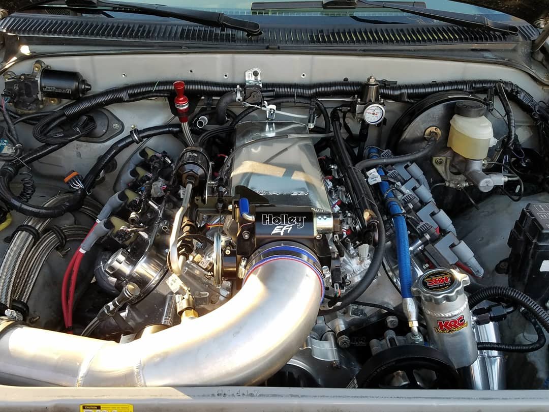

    Details on how your going to wire everything? stand alone harness?

    I have a microsquirt laying around but I will most likely use the stock harness and unlocked ecm for this truck. As of now I can run the engine in my garage on it's stand. But only on alternative fuel as the vats is not deleted yet.

    LS 2WD.
    You are already getting into the LS's it looks like! I think you've made a choice.
    Plus that V6 has 360K miles? No thanks.

    The v6 has around 225k the 4 banger has 360ish. The ls is going in either way. I have plenty of parts sitting around for it.

    im 4x4 and LS

    I'm going to pick the 4wd up this weekend so maybe part out???? And keep the 4wd stuff for a rainy day. Or sell it as a kit and dump more money in the Chevy. Too many options and too many projects!

    There we go! I need details unless your sas?

    nah I'm long travel

    That would be nice! What oil pan and headers/manifolds are you using? I'm guessing all ls1 accessories?
