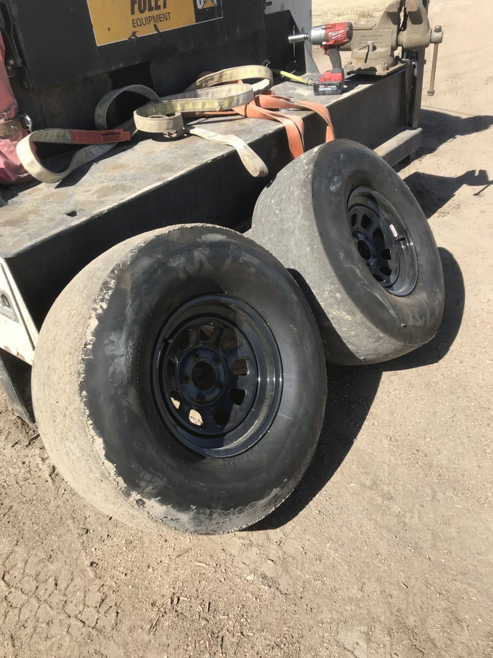

    4:10s on 285s.......... your trucks and this one are in way different ball parks lol now I could see an issue if I mounted up my 33x10.5w slicks on it but math works wonders man. especially with no multipliers like 4lo

    I agree 100 percent! I don’t even know where or how this topic got started but In my mind and and math it’s not an issue. Like I said earlier if I put these tires on yeah I might have an issue but more than likely it will throw a ujoint before the rear end.
