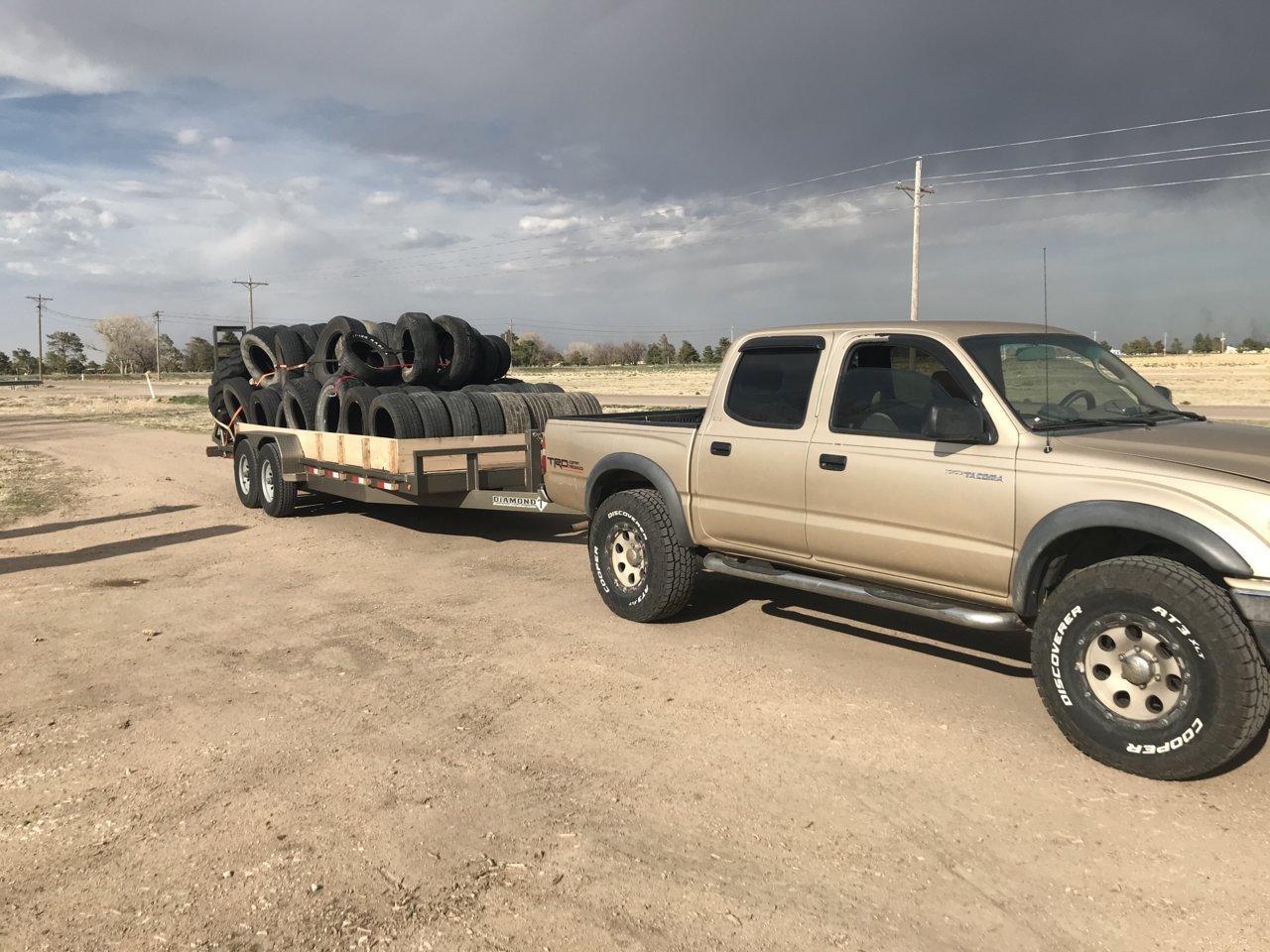

    Did a couple pulls today ran good but not super fast, medium traction all through 1st no tire slip in 2nd and on. Should be a good mix of power and drivability

    Pulled well, hour test drive. 2 grader tires and 90 car/truck tires.

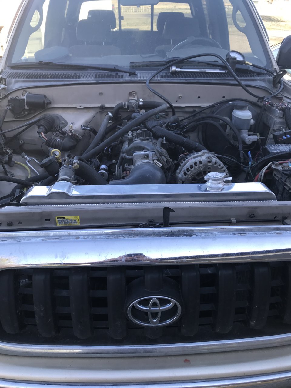

    Didn’t use the welded pan, used a F body pan. Iron block 6.0. I’m using a champion 3 core radiator now. Stock radiator is good without towing anything, put around 100 miles on the 5.3 towing a lot of tires. Started overheating a bit so the new champion 3 core has held the temp under 195 with no fans running in normal driving, have not towed yet with the new radiator. Wiring is pretty basic actually. The only thing I need to get wired is the coolant temp sensor and tap in a yota sender. All other gauges work well

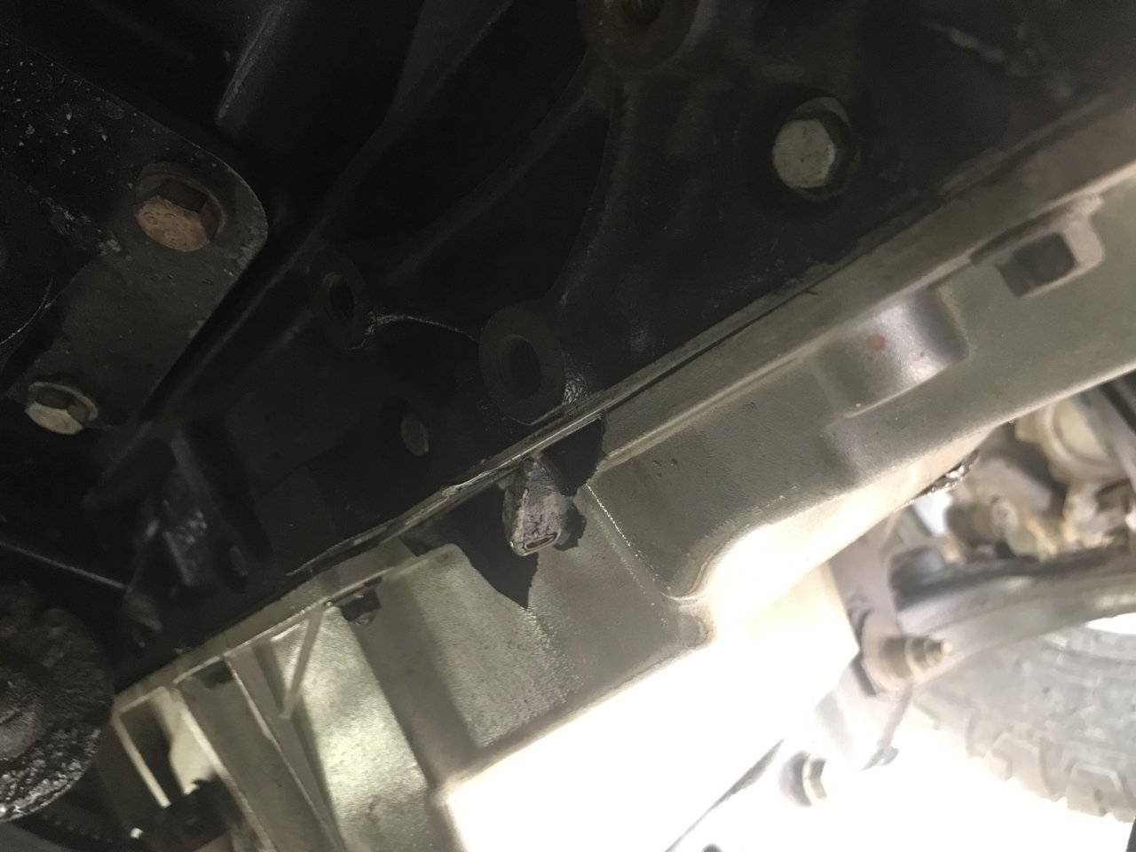

    welp 6.0 is in and runs but oil pressure is low and has metal in the oil....... greatimage.jpg
