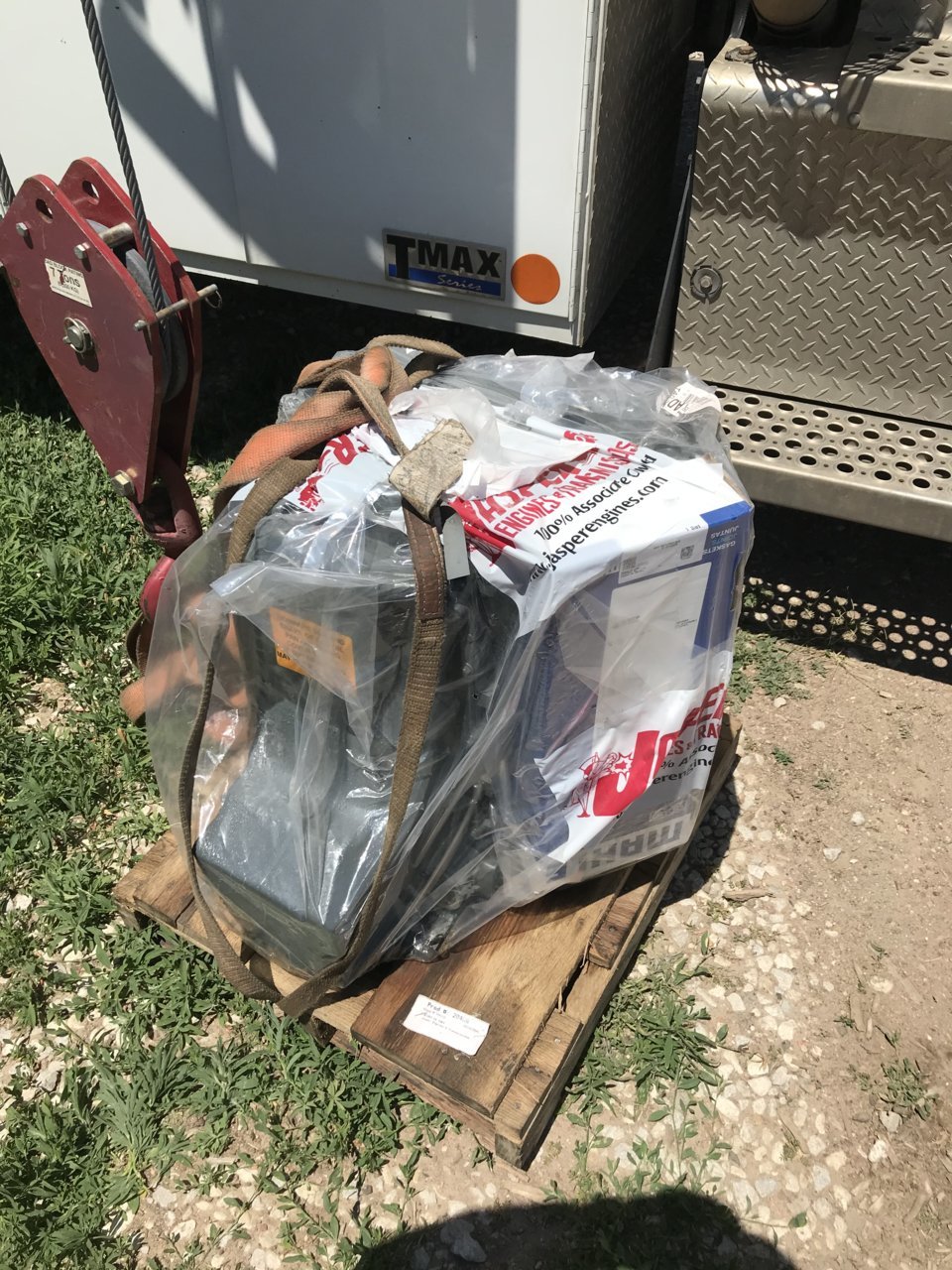

    6.0 jasper is paid for waiting for it to arrive

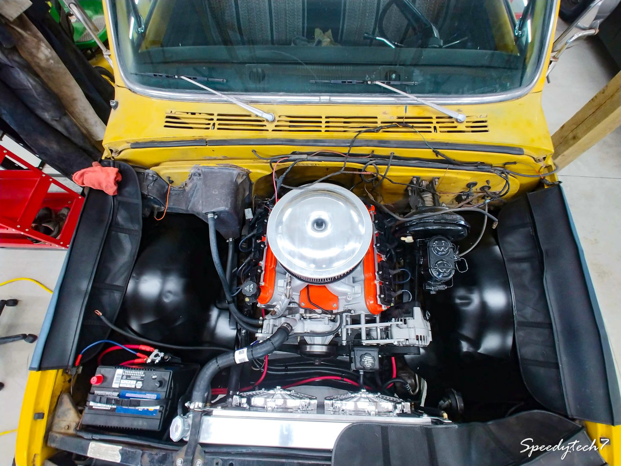

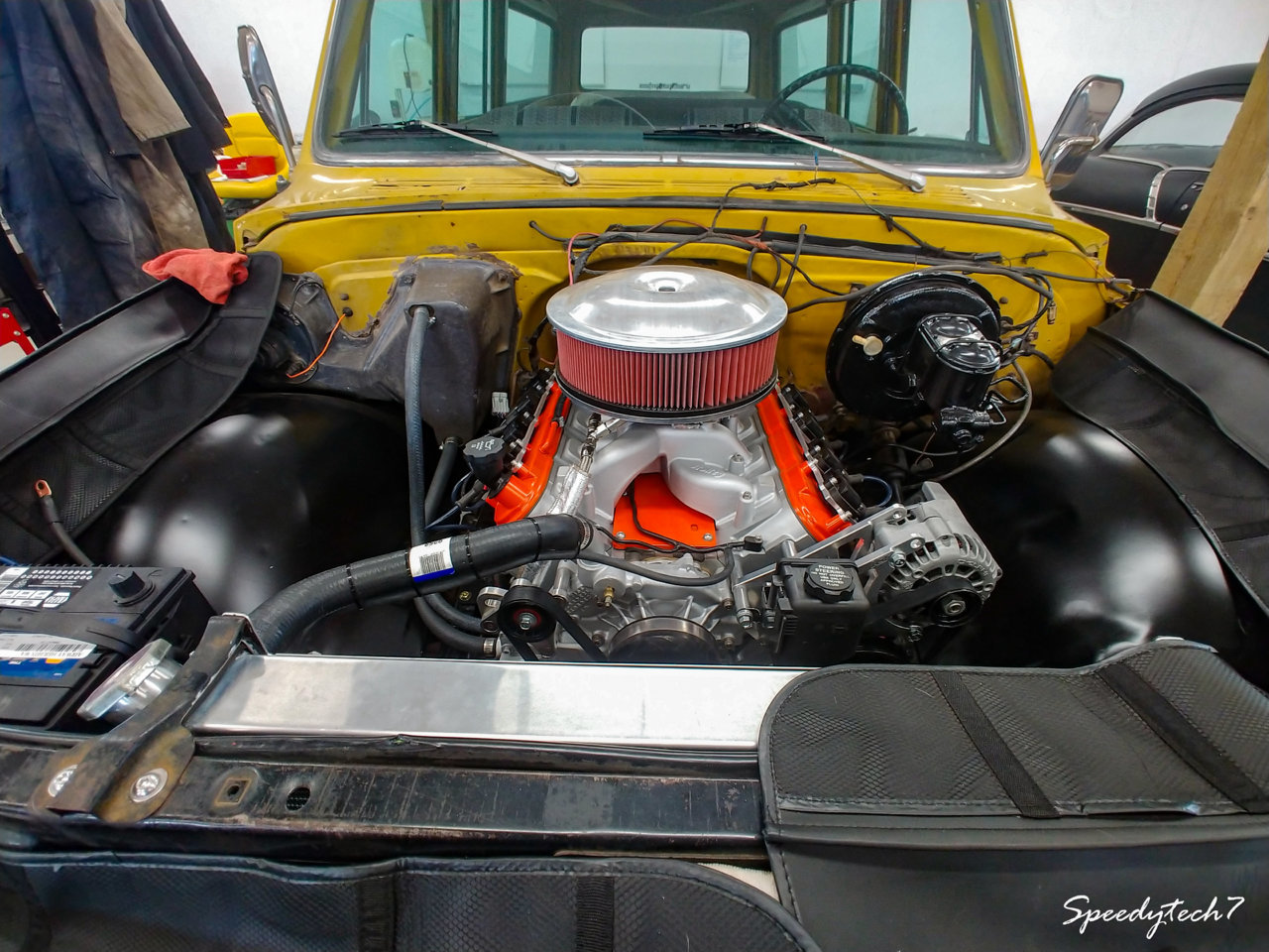

    We've started getting engines we can observe running and perhaps even pull ourselves these days since everyone has LS fever and scumbags know that and yank em out of clapped out tahoes and shit.
    Even went upmarket on this and got an LH6 because it was getting hard finding any decent genIII 5.3s anymore.

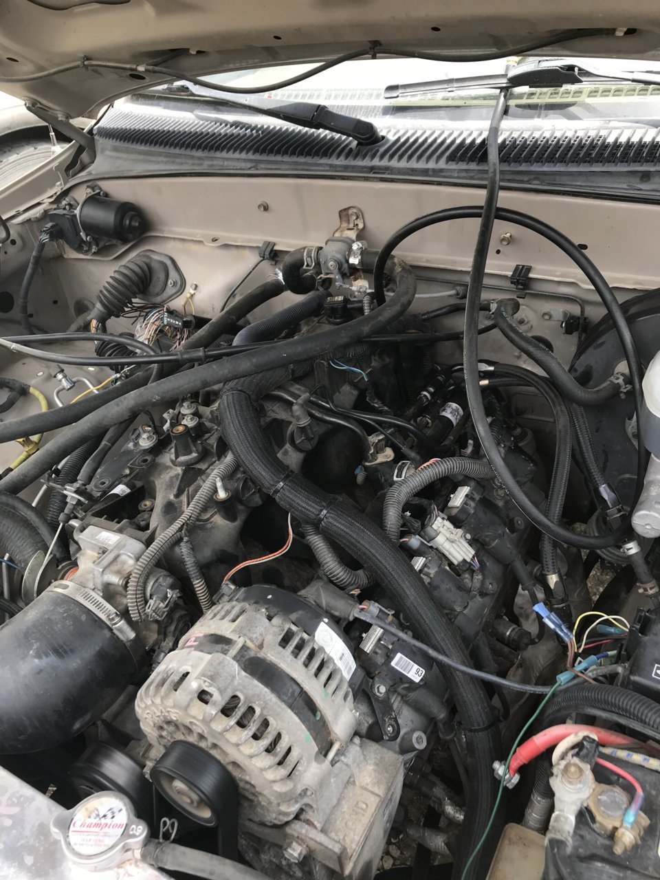

    6.0 is in and running, just need to mount an oil pressure gauge. All other coolant temp, Speedo, rpm all work. Just need to get cruise going and it will be set!18171853-0909-40B0-8922-42EE68F7755A.jpg6B784E43-514B-4311-999F-D5925B3B44E3.jpg
