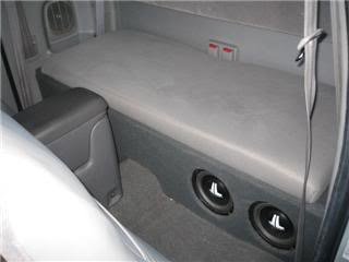

    The jump seat location is prime real estate for 4-6.5” subs and a pair of amps

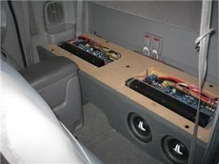

    I removed all the seat parts as well as the sheet metal “box” that forms the base of the seat. Think I also cut the tabs off that the jack mounted to.
    The sides are mdf cut to fit the contour of the floor, bottom is a gazillion layers of glass, and the amps are recessed into the top and capped with steel mesh to allow some airflow. I squeazed in every inch of airspace I could to keep the enclosure as small as possible while maintaining proper volume. Unfortunately it doesn’t fit my ‘15
