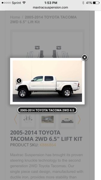

    Anyone have 6.5 maxtrac spindle lift on there pre runner

    Do you mean spindles without spacers or coilovers? I think Maxtrac makes only one model, the 4".

    Yea the Maxtrac 6.5" lift is just the 4" spindle and 2.5" strut spacer, it comes with a 4" block too I think.

    Yes they're beefy as hell. Just verifying for OP.

    Oh and OP, spindle lift is the best lift you can get for a 2WD. Lots of lift (I would stay 4" or you get cons) without reducing ride quality or wearing out your suspension with spacers. If it were possible on a 4WD I'm sure most people would use them. It's one of the few benefits of 2WD. Take advantage of it! For the rear, look into a spring pack though, as you may find yourself paying for a better setup in the future if you use a 4" block. I think that wears out your pack and will sag but I'm not completely sure.
