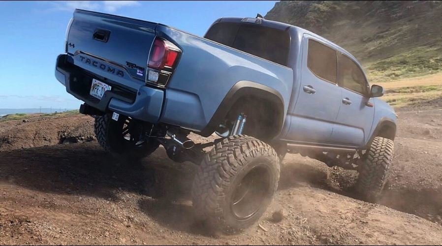

    other thread got a little derailed so I will try again.
    Just looking for info from those of you who share my interest/have knowledge about drop bracket lifts.
    I'm currently on a 3" front and rear lift (probably closer to 2.5") thanks to the help of a handful of you on this website.
    After about a year of driving this setup I've decided I want to fit 37s and get up higher on the road. I AM from Hawaii so this lift will fit right in and I really don't care about any negatives that are associated with drop bracket lifts. I know I will be cutting my cross member and plan to cut more of my frame to fit the 37s.
    I'm trying to keep my Dakar leaf packs and slap some blocks on them to minimize the block height while also retaining my 660 pound weight carrying rating.
    I plan to permanently fix a small gang box in my bed and understand that I will need to regear to 529s especially because I don't do much highway driving. I already get 14.5 mpg on 265/70/17s so I could care less if I'm getting sub 10 after all is said and done.
    Anyone running full extended coilovers on a 6+ lift? Would love for your input. I want kings but am open to other suggestions based on experience.
    Thanks for input.
    This is the goal but with less stance. I want a narrower wheel setup. Probably going with 18s or whatever the smallest wheel I can go with.

    Top notch on the big island sells 6-8” lift kings 2.5’s. My friend runs the King’s w/ the pro comp kit. If you wanna keep your leaf pack I’d get the archive garage shackles that’ll give you the needed lift w/o having to run a block.
