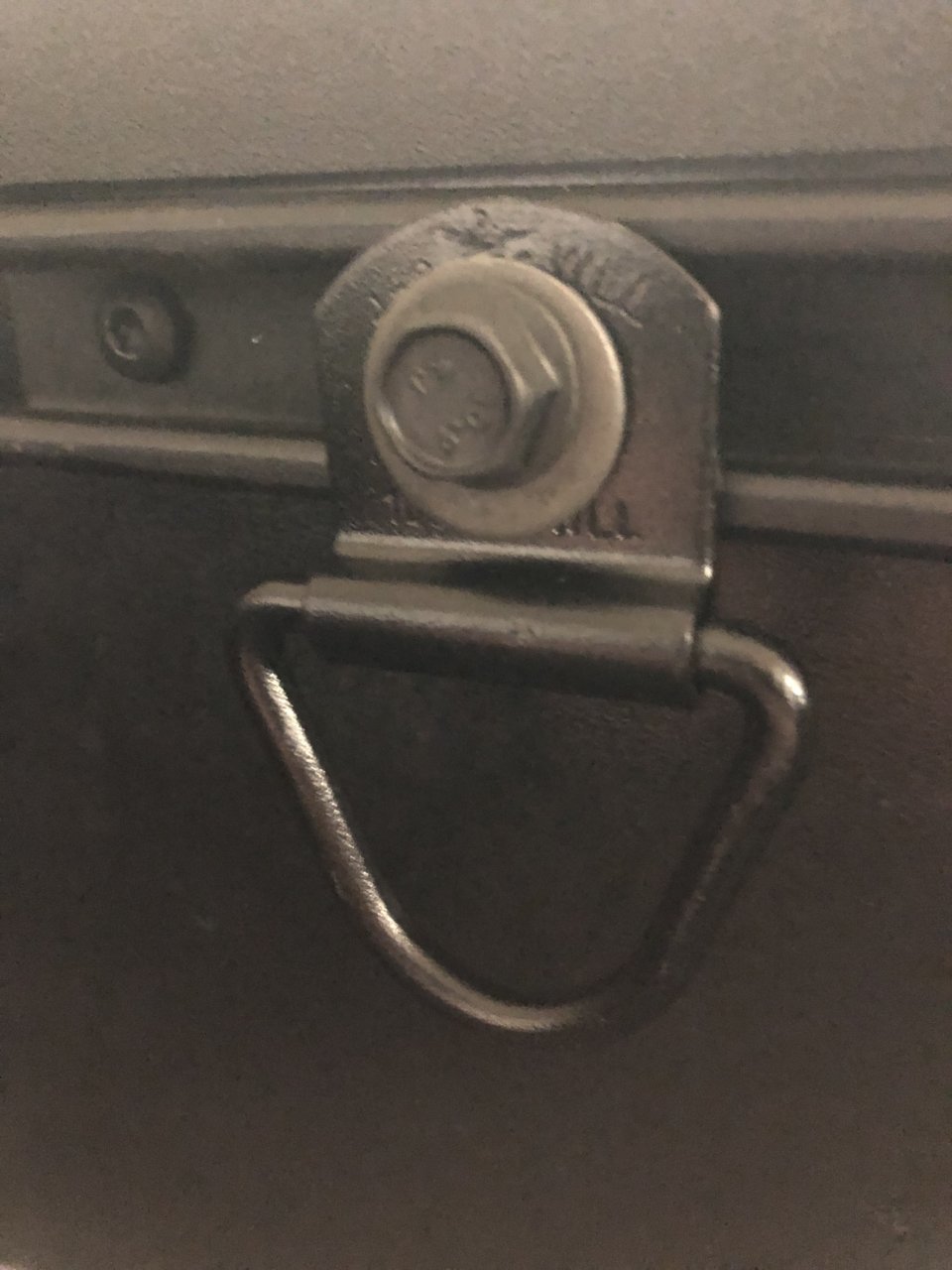

    I’m posting this for those members that want to save a bit of money and do this themselves. These sets (2) sell for $24 online. You can do it for less than $6 each complete.
    These are what you need
    $25.90 for 2 sets of these which will total 8 pieces, these are great because they insert in the bed rails without taking off the ends.
    http://www.hondogarage.com/index.php/product/landing/toyota-tacoma-utility-track-t-nut
    $18.99 for 10 V Ring Tie Downs 2”, these May look small but they’re quite large and hold 1000lbs.
    https://www.ebay.com/i/252743300730
    $7.74 for $10 M8 1.25 20mm bolts, they’re cheaper if you buy larger quantities and need more for other projects
    https://m.ebay.com/itm/10-M8-1-25x20-Metric-Hex-Flange-Bolts-Grade-10-9-DIN-6921-/262069224485
    For $52.64 you’ll get 8 complete sets for your bed rails and two extra rings for elsewhere.

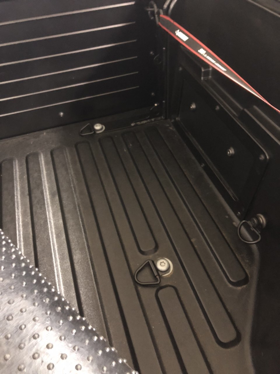

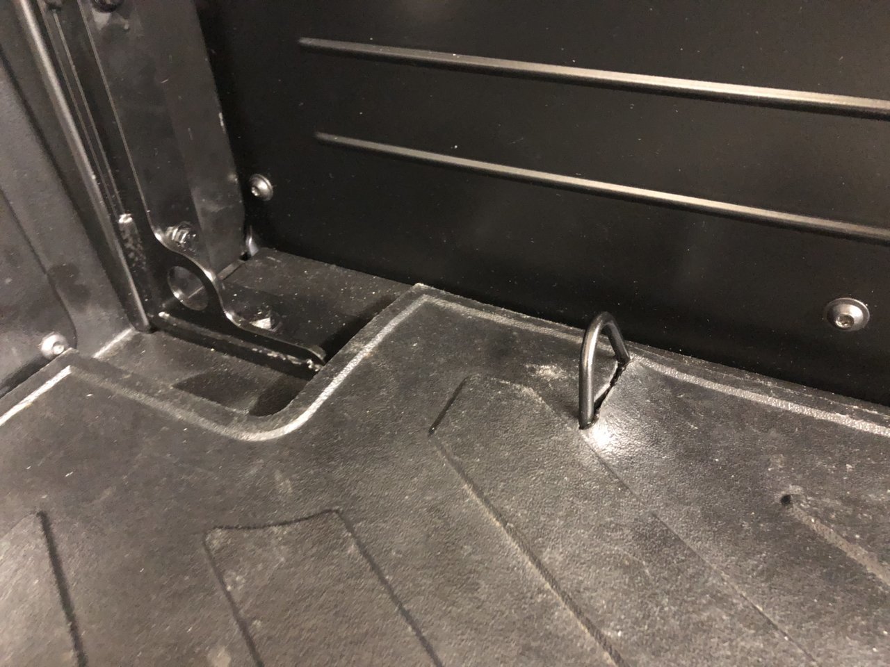

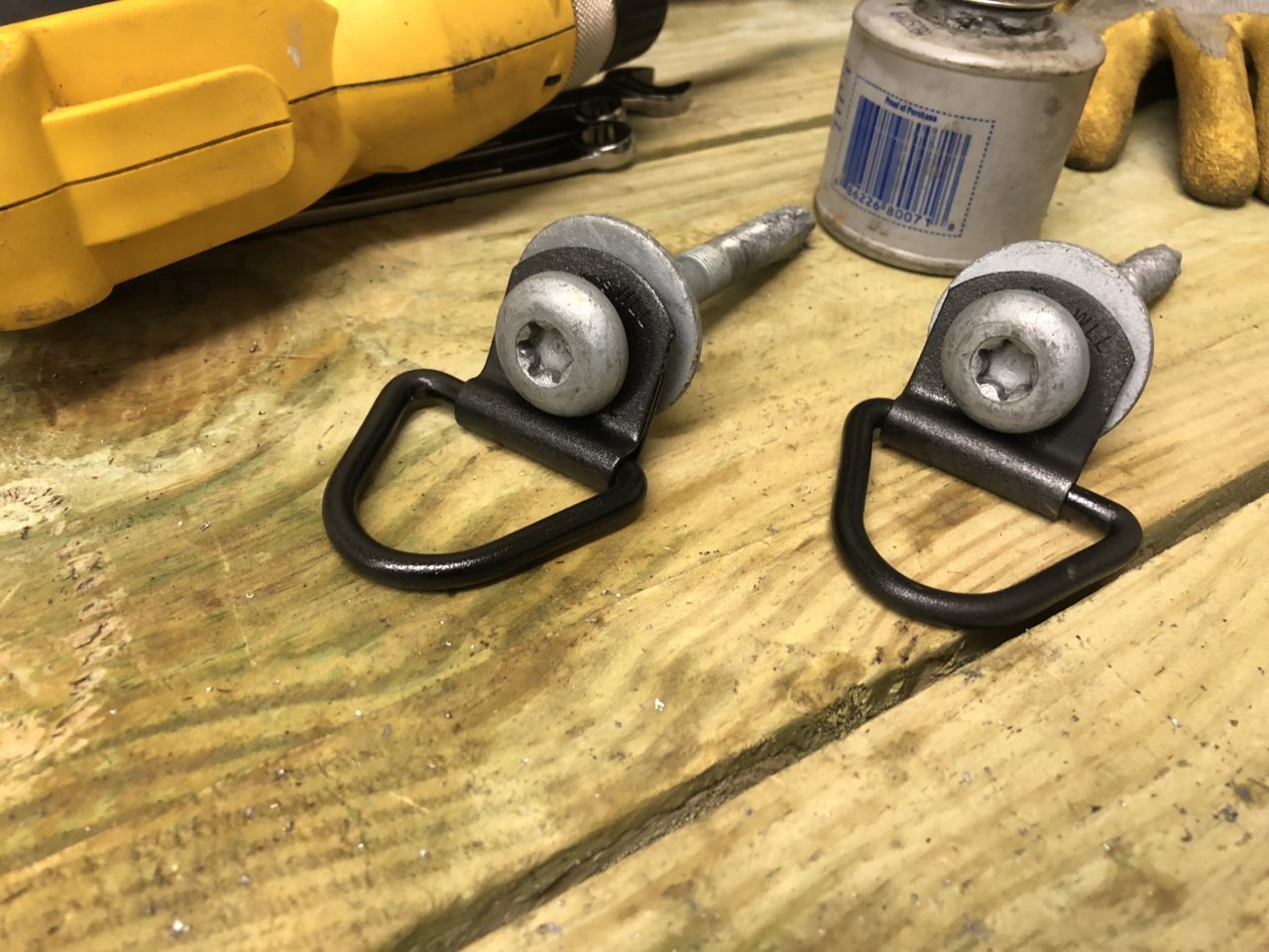

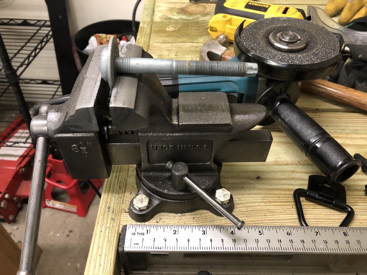

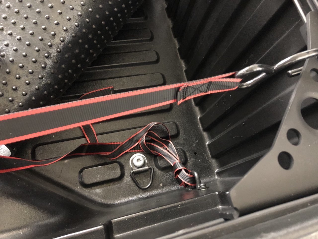

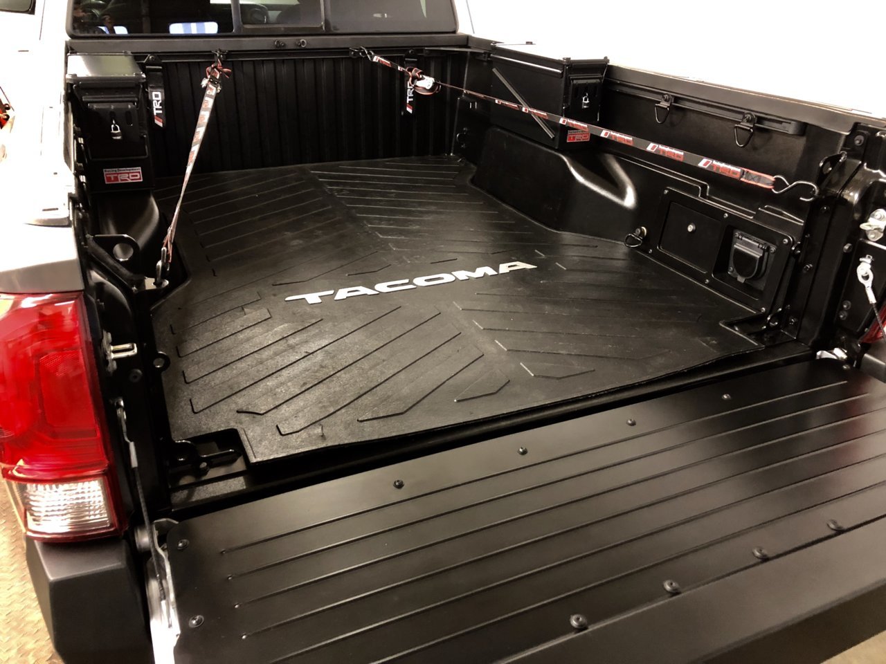

    Also put 6 of these on the bed bolts so have tie downs on the bed floor. Other’s have done this and there’s a write up I’ll include a few pics. You have to grind off the ridges under the bed bolt washer to get it off for dring in between. Also I had to drill out the d ring holes slightly larger. Finally, I just cut a 6 small slits in the bed mat which goes through when using or put it flat under the mat when not in use. Of course don’t forget antiseeze when reinstalling.

    Great writeup!
    I like how you highlighted the Toyota on your bed mat.

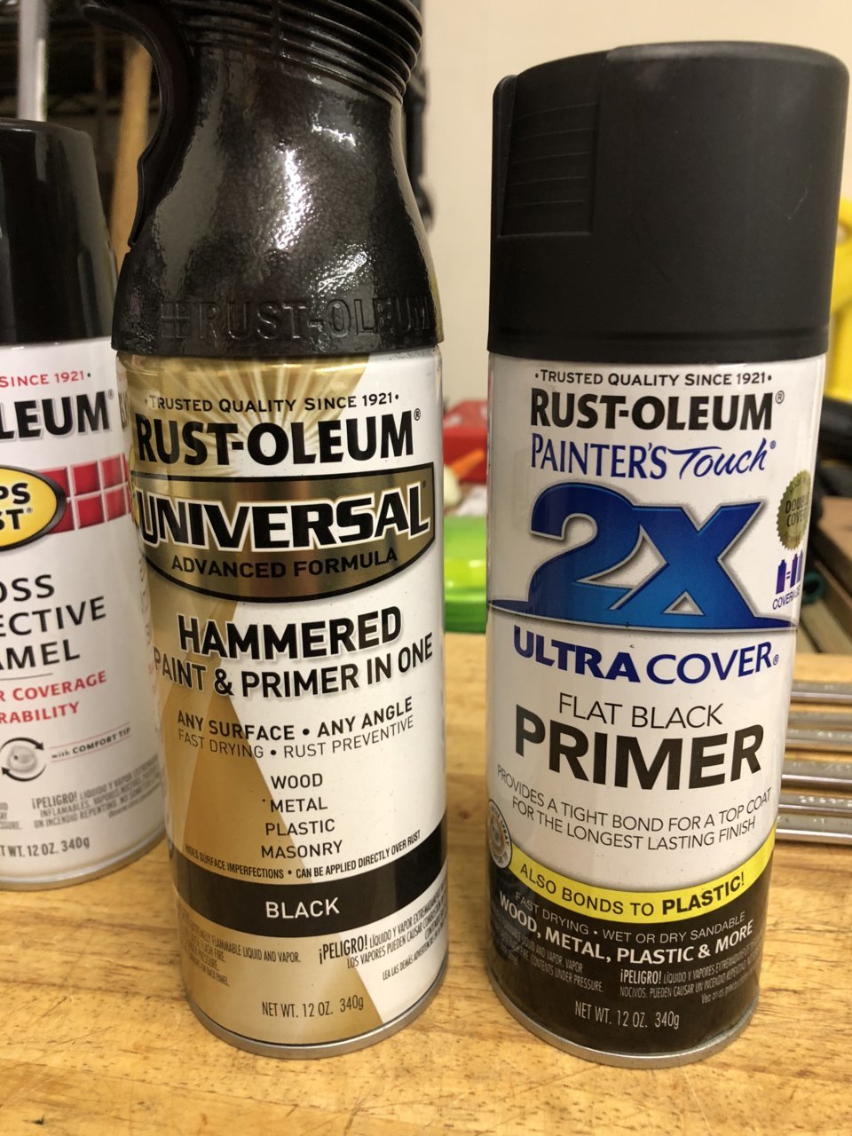

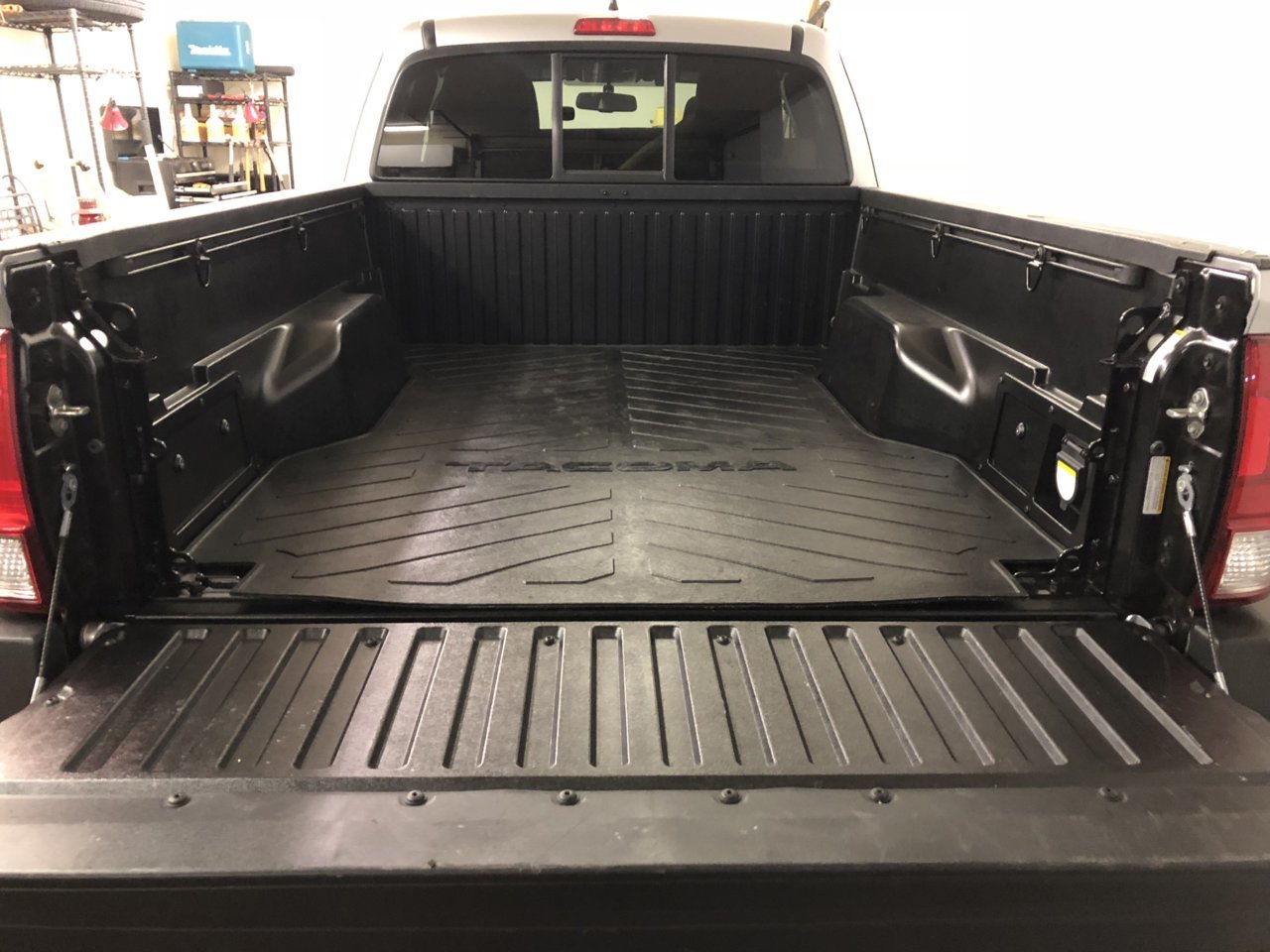

    Cheap and easy mod with a $3.99 paint pen from the craft supply store. I used a black paint pen to cover all the bolts in the bed too, and the white warning stickers in there, as well.

    i did this mod to my 2nd GEN but instead of using the T slot bolts I just removed the Torx screws on the rail itself and screwed the d rings behind the rail, also ive noticed that the D rings themselves will rust very quickly I bought the same ones which may eventually be removed and repainted soon.

    Actually I saw that my only concern is the rings noise banging against the bed while driving.

    You can also use a socket over the bolt head to hammer off the washer. I used a piece of wood under the bolt so that the threads wouldn't get damaged.

    Yeah I tried that maybe not hard enough though, so just decided to grind them off with a wide disc on the cut off tool.

    with the rear sliding window open it sounds like jingle bells, I just did mine with the same d rings and im astonished on how fast they started to rust being out in the weather, never thought they would rust as quickly as they did, at sometime (soon) ill have to Rustoleum them

    Yeah. It took a 5lb BFH to get mine off. And, I did loose a bit of skin in between the socket and washer being stupid and not wearing gloves.

    Good thing everything is black, always keep a variety of black paint!
