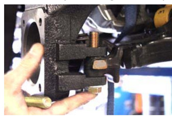

    The drop bracket lift and spindles you currently have retain similar LBJ mounting points (relative to stock), where the lower control arm/lower ball joint (LCA/LBJ) mount to the bottom of the spindle (knuckle).
    The other lift spindles that were recommended are designed to give 2wd trucks a front suspension lift without the drop bracket by lengthening the main arm portion of the spindle and changing the LCA/LBJ mounting point. Notice in the photo below, the bolts below the tie round mount behind the wheel bearing.
    This design gives 2wd trucks a significant lift without altering the suspension geometry nearly as much as a drop bracket lift, nor does it require as much work. TBH, it's a much easier lift that keeps 2wd truck components from wearing out as early.
    (And for reference, it is 2wd only - the CV axle shaft of 4wd trucks would normally mount through the large open hole you see into the wheel bearing.)
