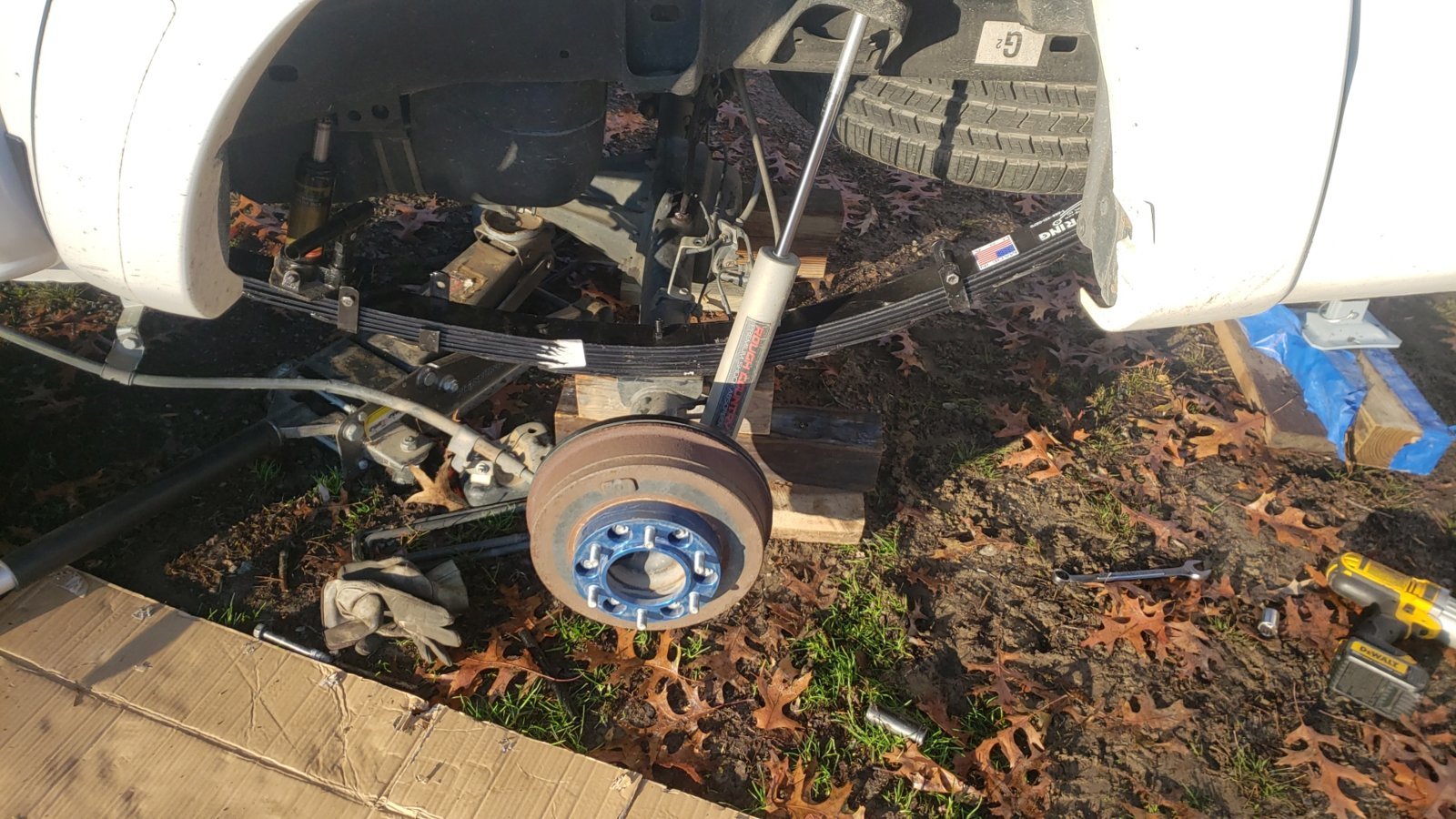

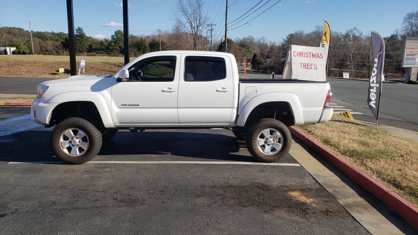

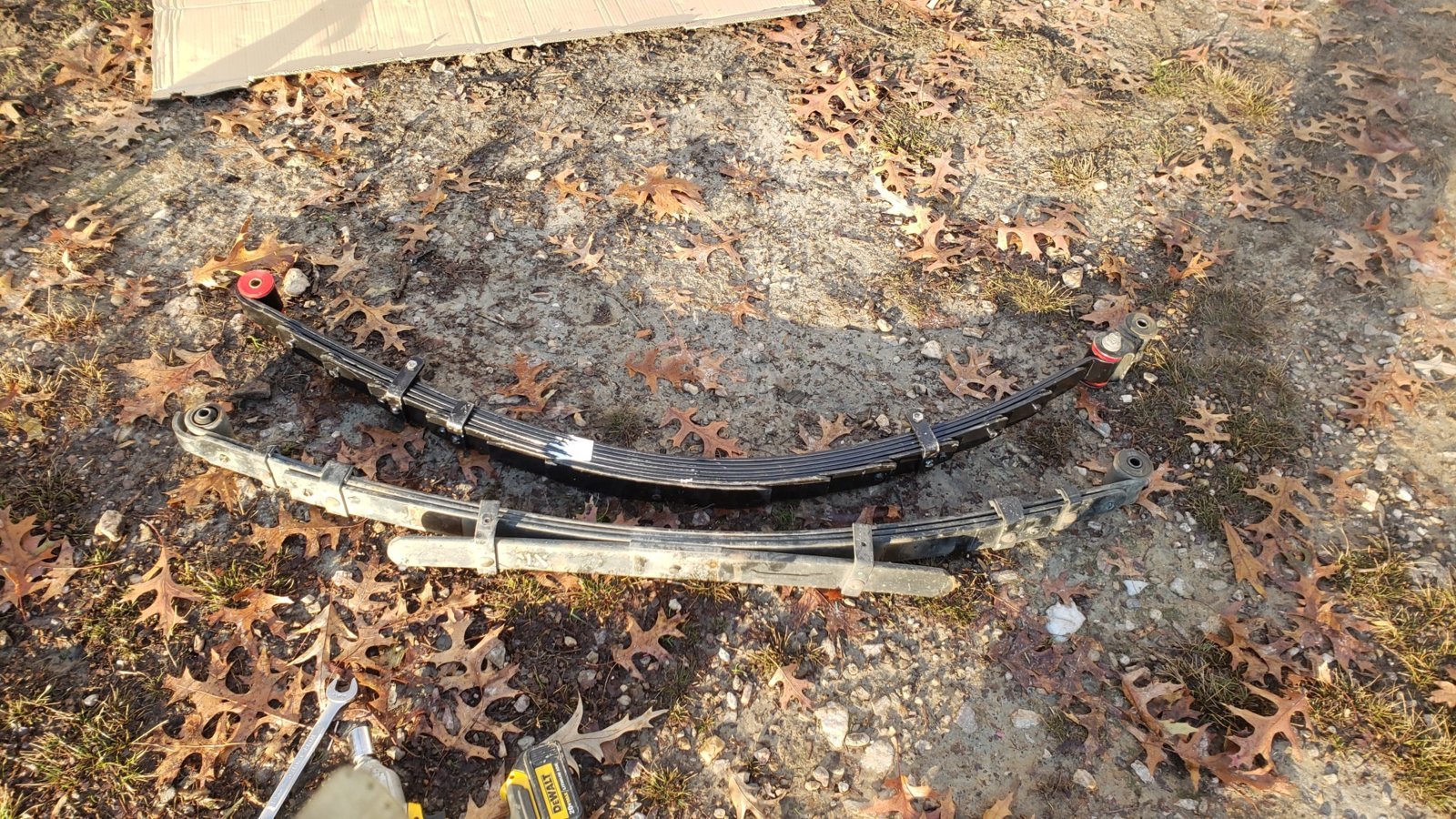

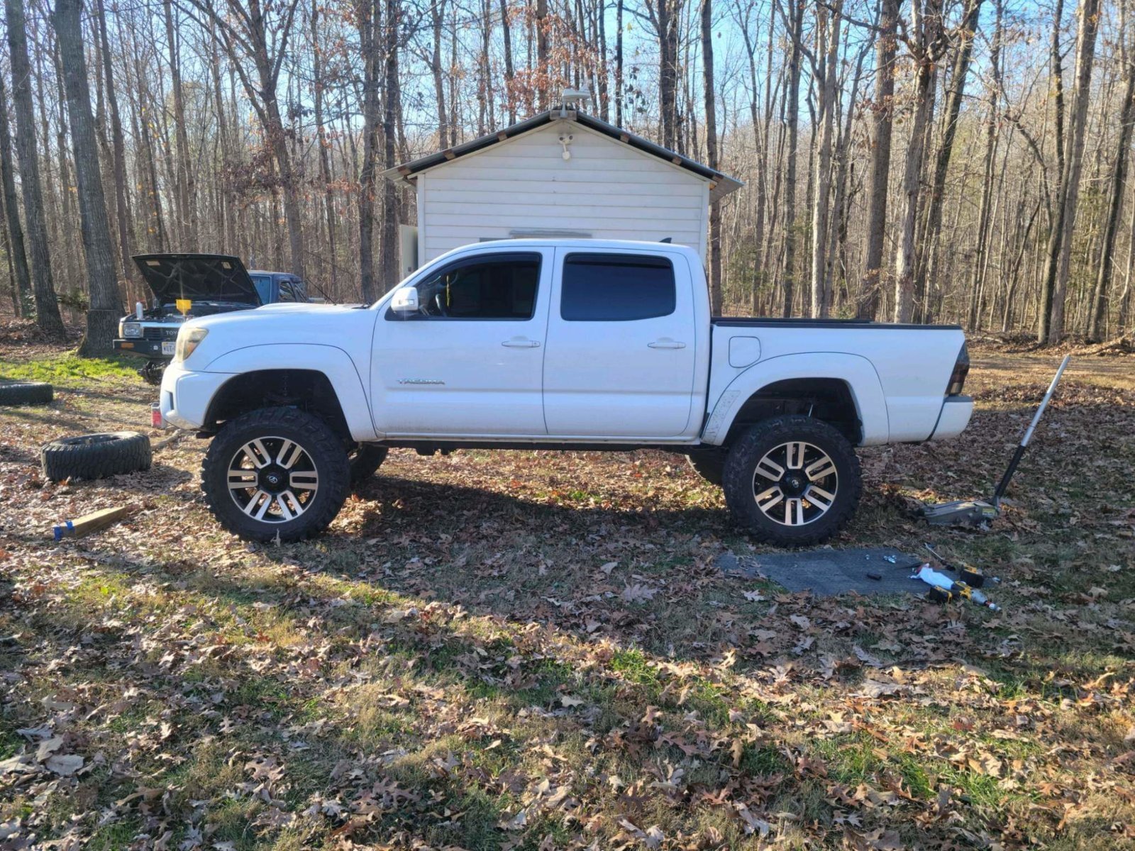

    6 inch lift spring vs oem.jpg 6 inch all the way around stock tires.jpg 6 inch lift spring.jpg I had them made by Alcan springs in Colorado, look them up if you don't believe me, I could care less

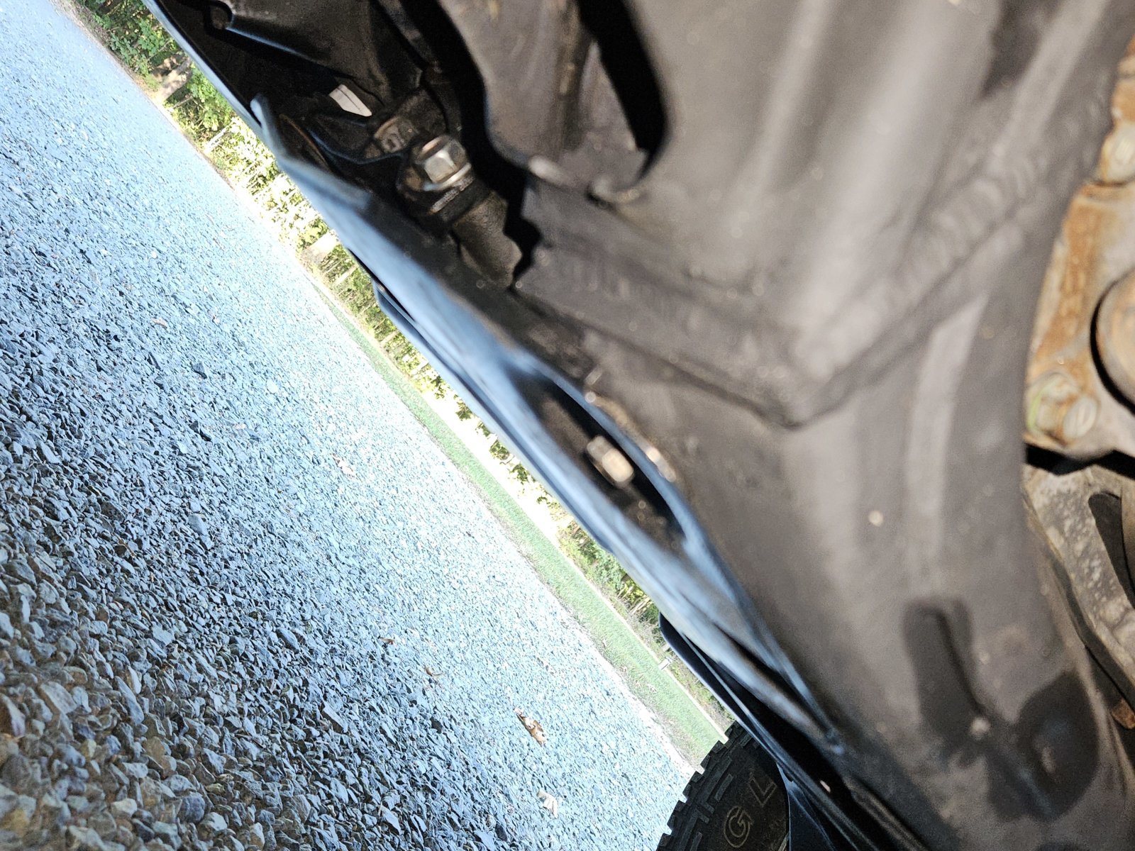

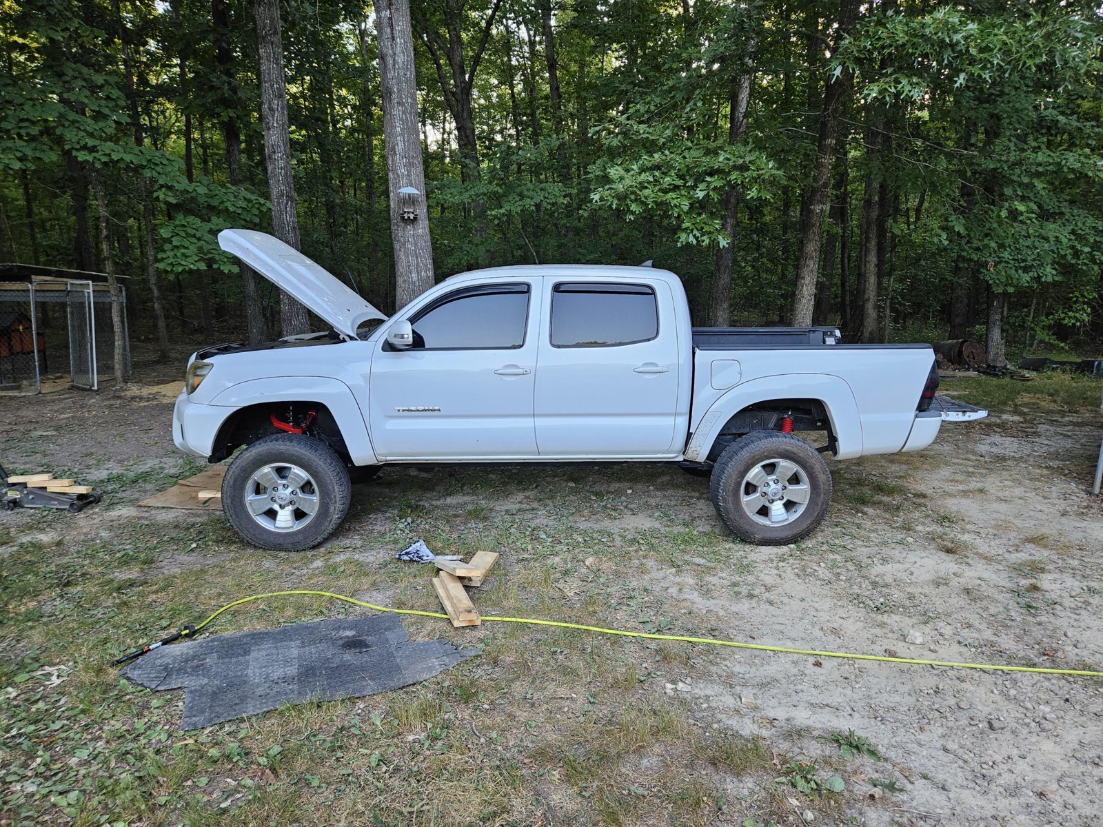

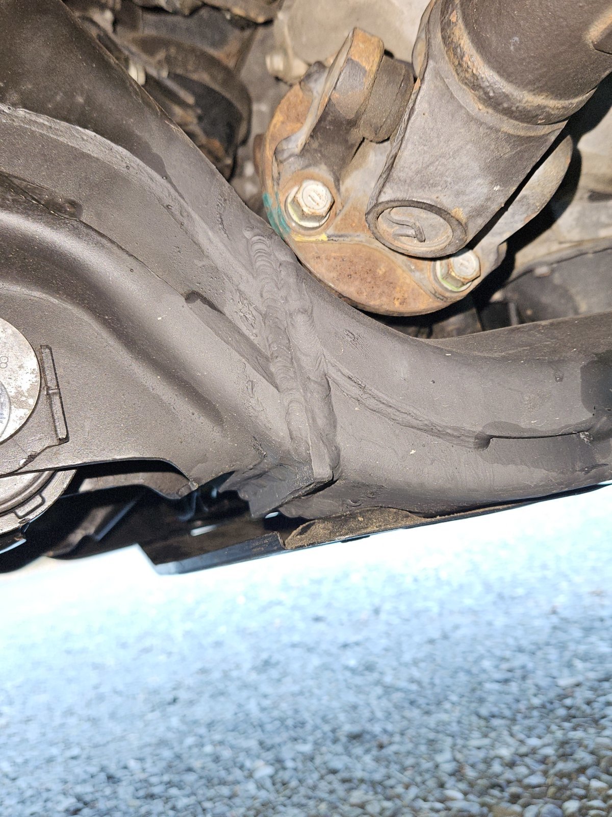

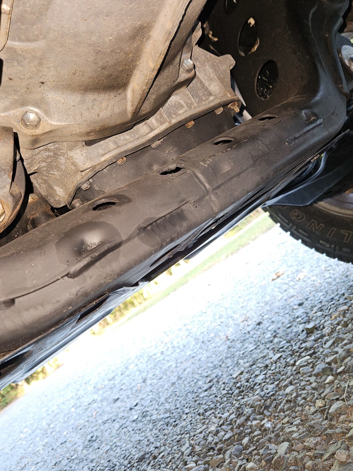

    yes, I'm working on uploading pictures now, but I had to get the front factory spindles, both front 4wd factory differential mounts, new oil seals for front spindles part # 710573 National oil seals will work. I lucked out and got both front spindles the 2 diff mounts a cut out factory crossmember piece, most of the bolting and the factory skid plate and bolt off of marketplace. so basically, what i did was removed the 6-inch completely, reinstalled the front diff with the factory mounts and the diff drop in the front and tightened the bolts then in the back placed a ratchet strap under the diff, bolted the factory crossmember to it and let it down until it fit up were the cross member could be welded in place. on the frame side I did have to install a piece of flat plate to make up the difference in the length of the crossmember piece I received. no big deal. I fitted it all up and had a buddy of mine weld it up will i tweaked it into place as needed.

    Lol chill dude. I know they can make them. Just had never seen a picture of 6" lift leafs before. That's a wild amount of arch!
