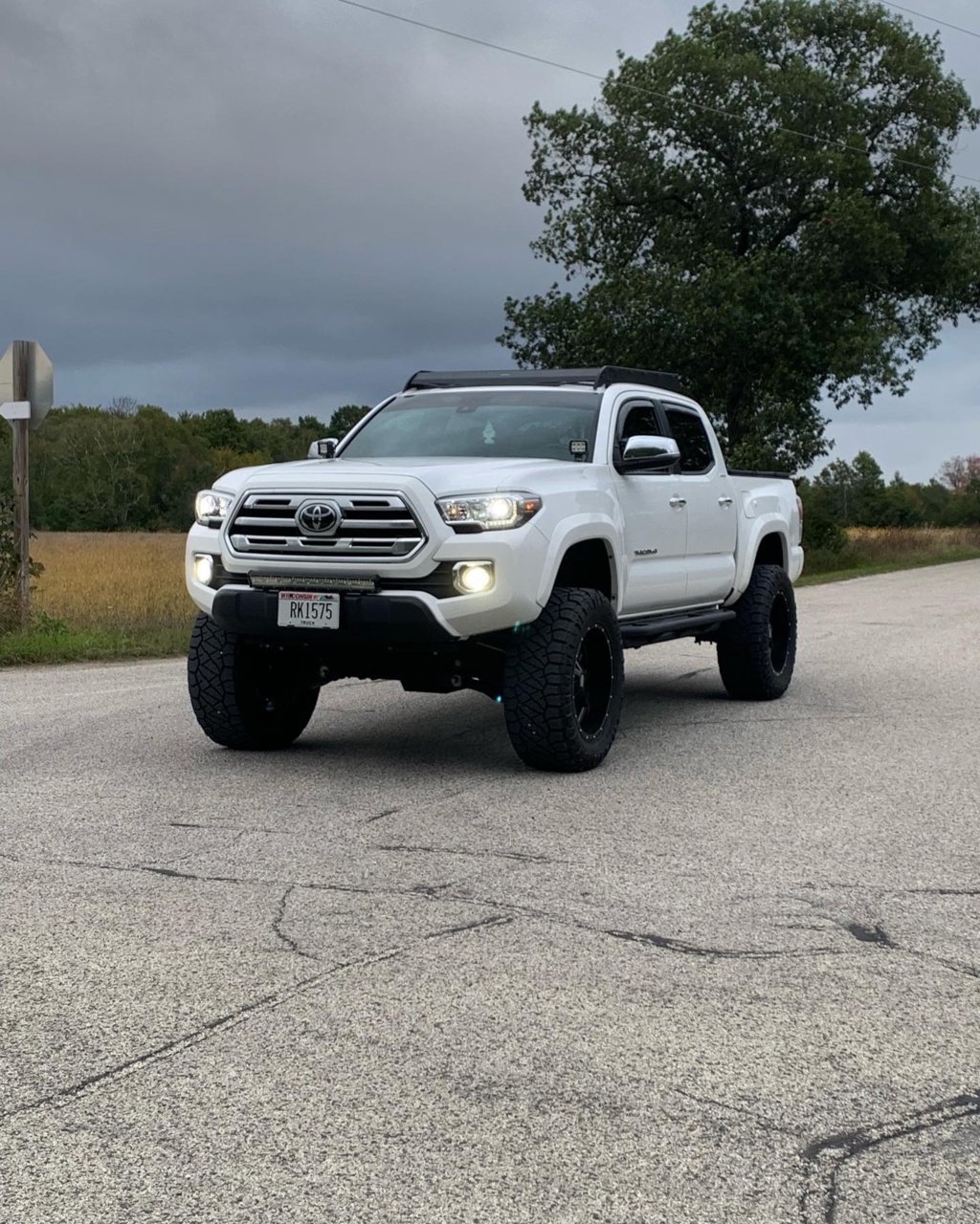

    So I bought a 3rd gen Tacoma and when going 60 it stay in 5th and won’t go to 6th. Not sure if it’s just bc of the loft or what and wanting to know with re gearing it will help. Thanks in advance

    35s? Pics so we can see the beast.
    You may need to regear, but the truck is likely working hard to maintain speed.

    Idk how to post pictures

    Get that thing tuned. Will help tremendously and way cheaper than a regear

    So get a tuner for it for more horse power

    Nice truck brother as Bishop said you are probably going to need a regear to solve your issues. Hopefully someone with a big lift like yours will chime in with their experience.

    Not necessarily. A tune will help with the bigger tires, better throttle response and much better shift points

    60 mph you want it in 5th. With those Big O Tires it is like 6th gear for a stock Tacoma if not 4th. Sounds like your rig is dialed in. Gun it and guide it.

    Get it tuned . I have 6" and 315/75/16 currently on kdmax pro XT with normal throttle settings. I have more addons if interested to know exactly what , just ask. I can run 6th no problem. I'm a at transmission
