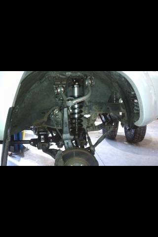

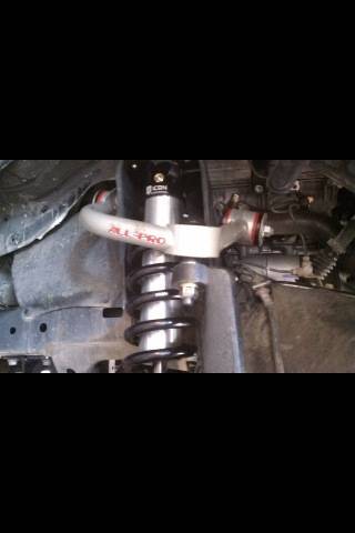

    Just recently got my truck lifted exactly how i wanted. 6 inch pro comp lift, Icon coilover and the UPC from ALLPRO. I'm also rolling on Ballistic Jesters. Is anyone else running These UCA from ALLPRO? They "skweek" like a Mother f*****

    not sure about the squeaking but thats a nice set up you got on a 6" lift ;)

    btw when was the last time you greased bushings?

    Uniballs squeak at low speeds, but also grease your bushing in your upper control arms. DO NOT GREASE the uniball.

    You can spray the uniball with some Dupont Teflon lube. It gets rid of the squek. Also it could me your bushings, make sure you don't ocer grease them, they are super picky.

    They should have been greased when the shop put my UCA on.. At least i hope they did. Nice truck by the way!!

    Oh ya, regarding any noise issues. You will pick up more road noise from the Uniballs, poly bushings and the DOM tubing in the Uppers. Depending on your environment and wheeling conditions, use a dry teflon lubricant on them, because the top holds debris like a wishing well, so get in the habit of wiping them out at the end of the day. All-Pro used to sell a cap to go on top, but it was junk and people used some 'One-size-fits-all' type Daystar poly tie rod dust boot that works better, so All-Pro discontinued them. I use synthetic grease for the bushings. Works awesome and it's even red to match the bushings! lol

    I finally went out and bought some synthetic grease for my bushing and it cured all the awful noise i was getting. apparently my bushings never got greased when my UCA were put on. If anyone is considering ALLPROs UCA I would highly recommend them.
