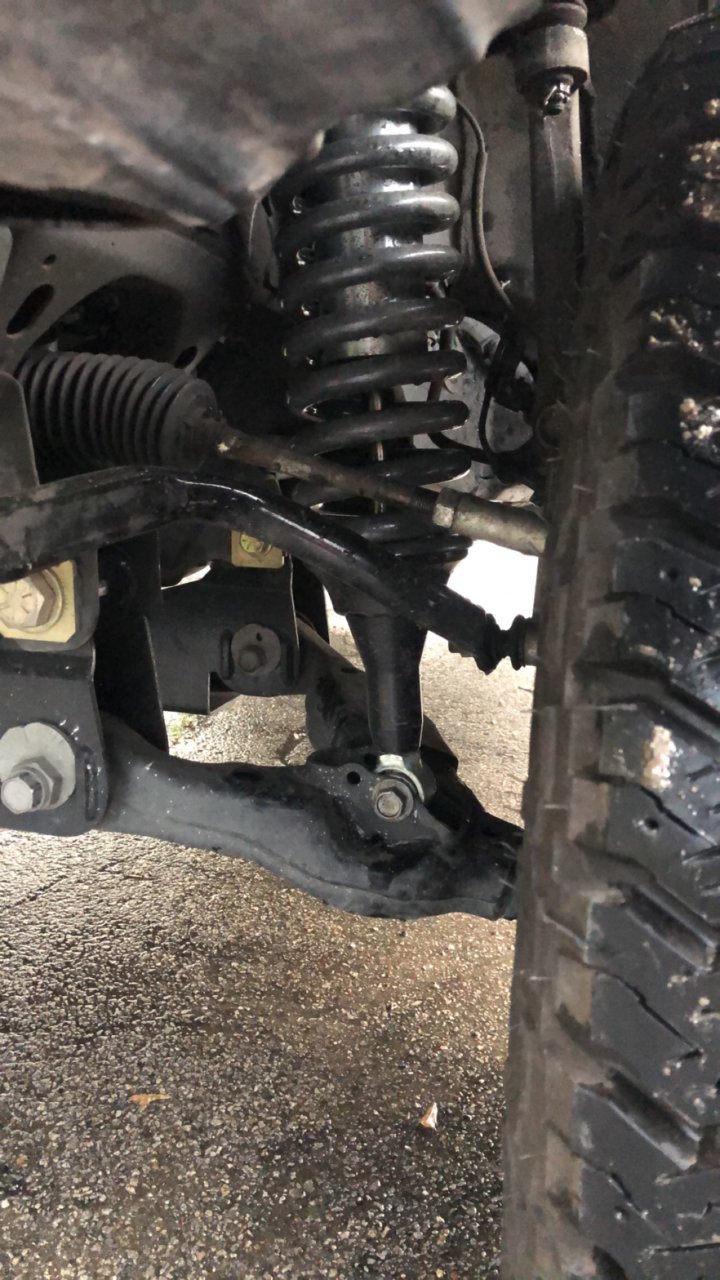

    So I recently got a new lift kit installed on my 2017 tacoma and I’m having some issues with it, I noticed when I would make a sharp turn my sway bar would make contact with what I believe is the axle... anyone got any tips on how to fix this?

    Hey, its not the axle its the tie rod..
    I would also like to know if anyone else has this problem or fixed it..
    I got mine lifted same lift kit and im having the same issue..
    Im with you here tacobro713

    Try to get a swaybar relocate kit.

    Looks like you have a prerunner so no front axles. You could just take it off worst case scenario?:notsure:
