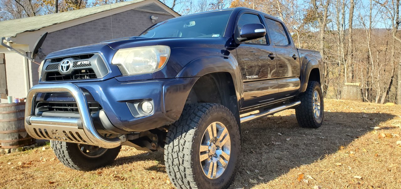

    Bought mine with a 6" lift and factory 18" limited wheels with 1-1/4" spacers.
