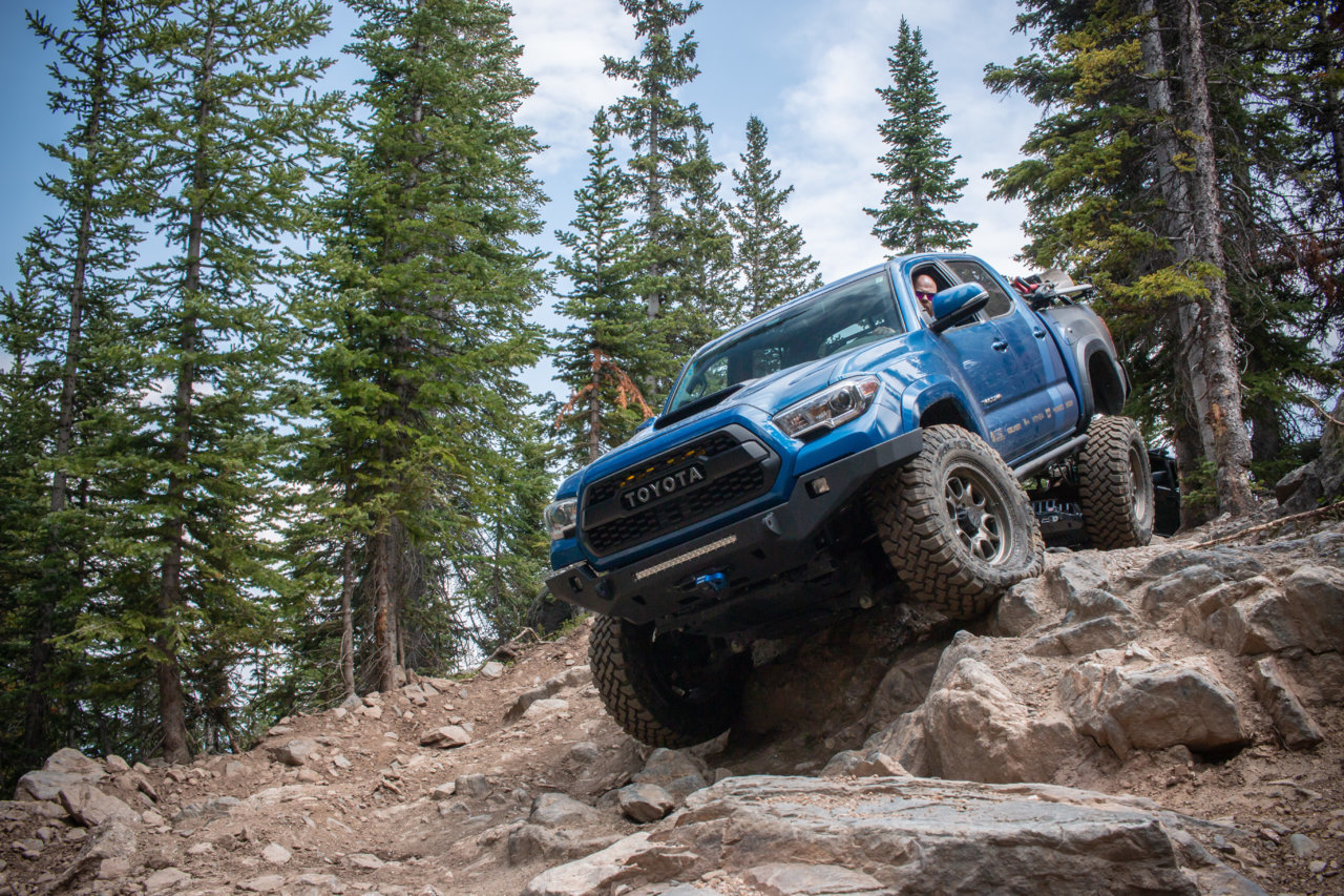

  13. Dec 21, 2019 at 7:21 AM
    #33
    Truc577
    Truc577 Well-Known Member
    Jul 15, 2017
    #224074
    565
    Curt
    NOMO
    2005 TRD OR 4x MT, 2020 TRD OR 4x AT
    High output valve stem caps 2020: Bilstien 6112/5100 Mobtown sliders RRW RR-5 Bronze wheels 2005: 2018 frame and full suspension 2017 Dark Anthracite wheels ARB front bumper
    That looks tough!
    TimC likes this.
