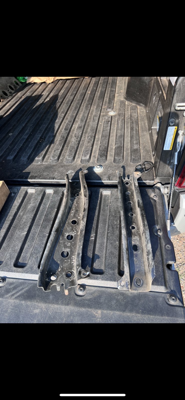

    the shop took these cross member brackets off..i am now getting steering wheel jerk over bumps.....that the cause?

    These cross member brackets

    Those are radiator support brackets, has nothing to do with the bump steer that you are experiencing.

    online shows these not on the vehicle will affect rigidity of the truck..i cant see under where the hell they go!

    As stated, those are the radiator support brackets. They get removed for drop bracket lifts (4" to 6" lifts) and most skid plate installs. These are not the cause of your problem.
    You likely need an (better) alignment...

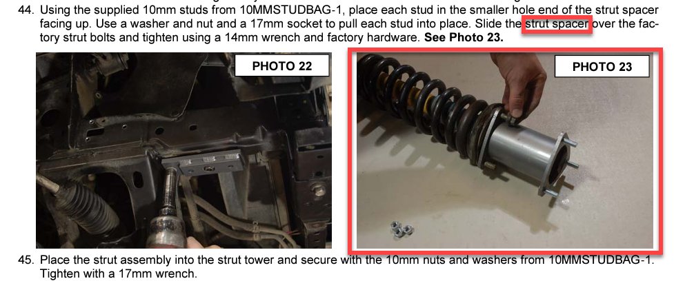

    because the ready lift kit had strut spacers. the RC kit has lifted struts.

    Got a link to the kit you purchased? I mean obviously what's done is done, but I don't see a RC off the shelf kit that doesn't use spacers. Got pics of your installed suspension?

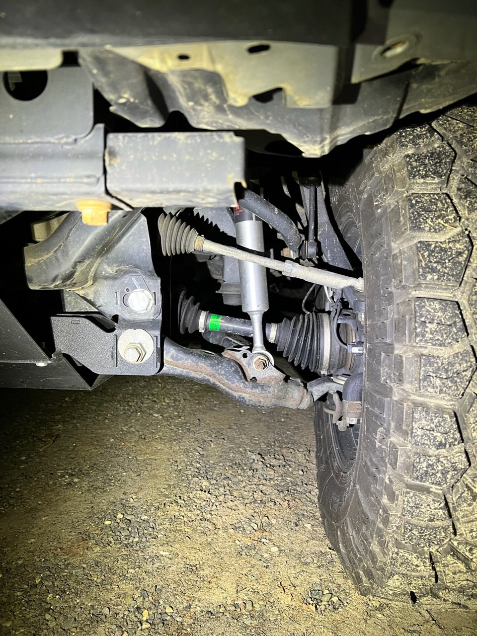

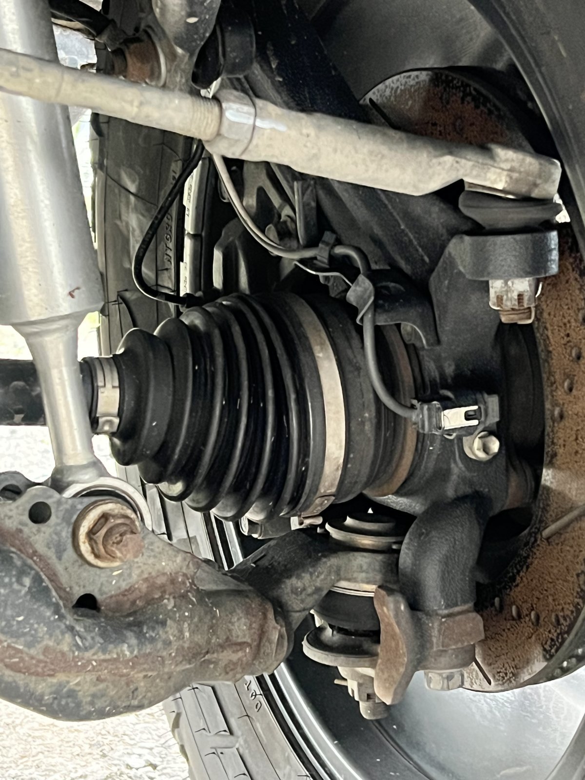

    Here is two pics

    Got a pic of the top of the shock?
