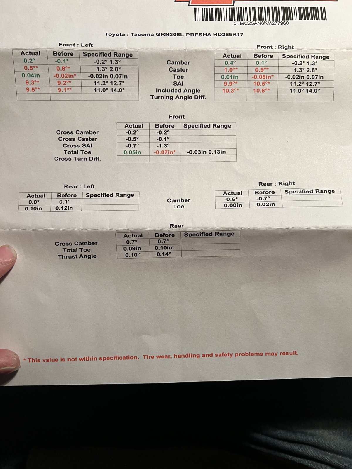

    149
    aaron
    Alignment specs

    Those caster #s are horrible!!! You need a good alignment guy.

    That alignment looks pretty bad. Green = good, red = bad

    Find another shop for an alignment. That's your issue.

    les schwab will only change oe specs slighty im about to spend this 870 for adjustable UCA's

    You're not even in oe specs

    Holyshit!!! Your alignment

    You don’t need adjustable ucas, getting the alignment correct is not an issue with a db kit.

    Tell Les Schwab you want .05 toe in, .5 positive camber and 2.8 pos caster all those are within oe specs the truck will drive so much better

    I'm betting their crew just couldn't get better numbers. Why else would they be so far out of the "Specified Range"?

    You dont need ucas unless you want 3+ on caster and the tie rod angle are fine.

    you only need UCAs if they are limiting your alignment specs.
