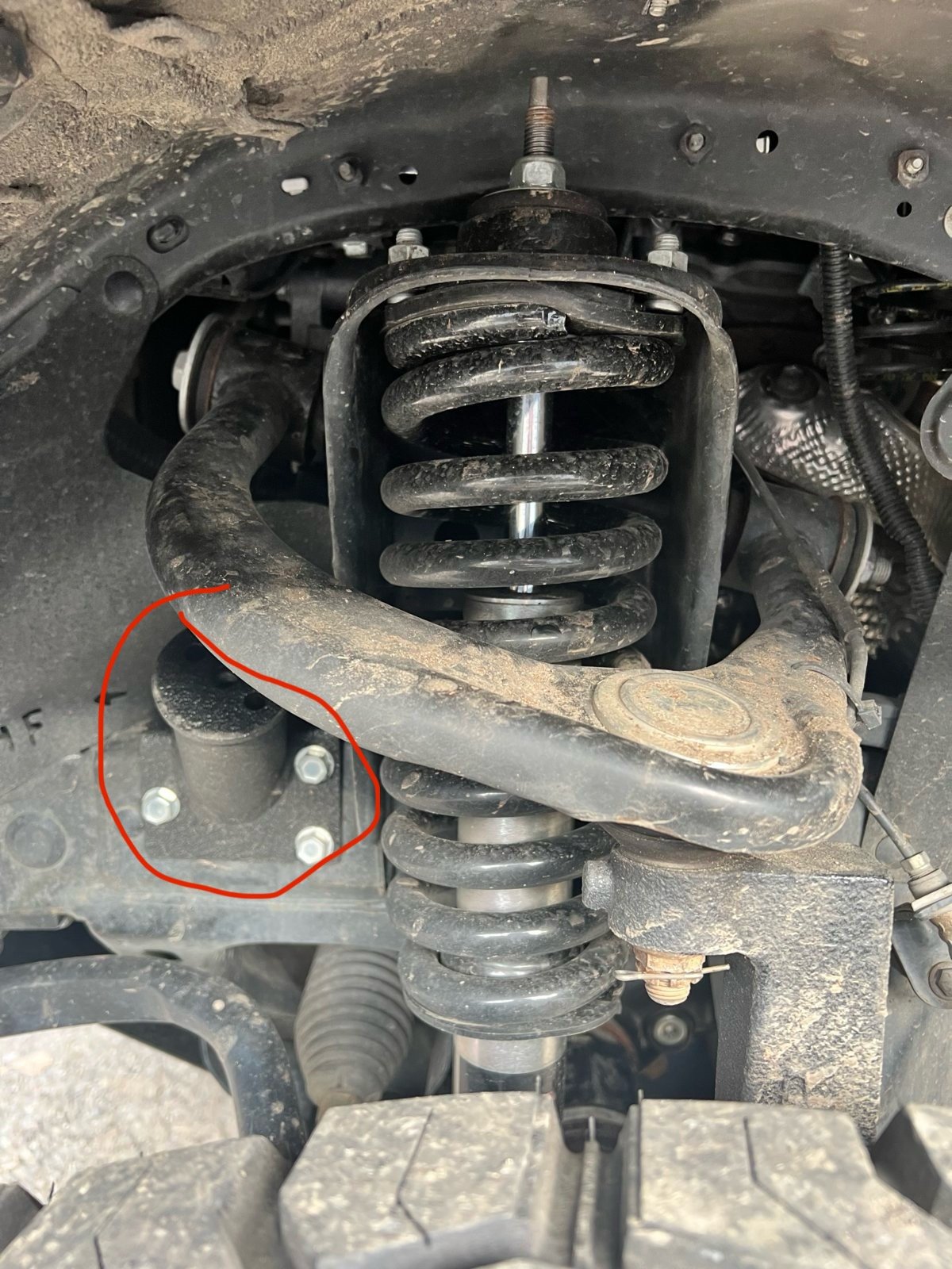

    can you post a photo

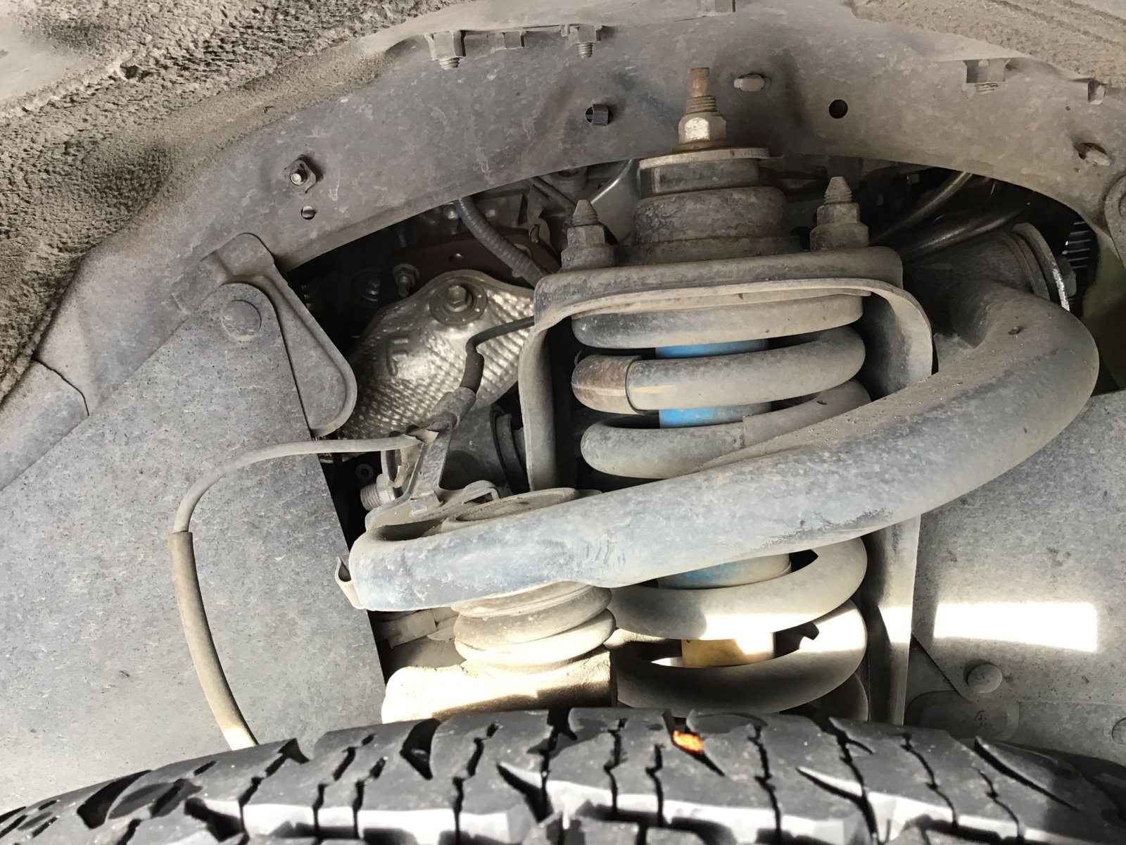

    This is how mine looks ……

    it's just a different style than yours. nothing wrong.

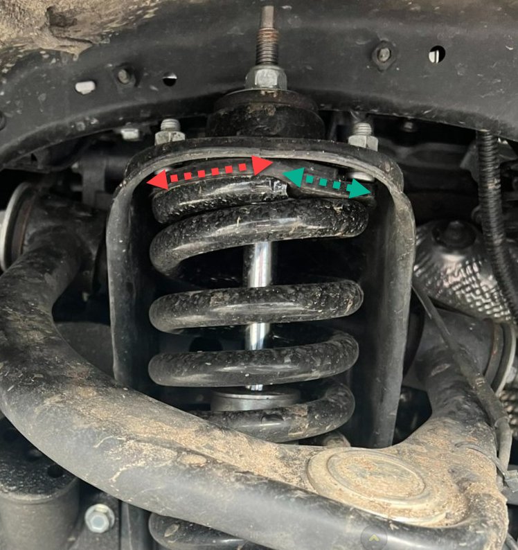

    It looks to me like the rubber spring isolator is upside down and not fit correctly on to the upper most coil of the spring. I’ve never seen them squished in like that unless there was an install problem

    There is no way that the way that spring is sitting up into the frame pocket can be correct.

    You’re seeing the isolator where sits on the end of the coil overlap. Perfectly normal.

    You talking about this?

    All the threads showing?

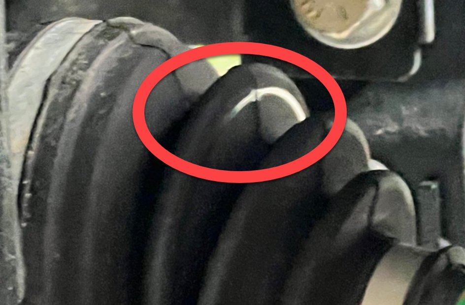

    I think thats ok. Mine look like that
    Second question.. what is this?

    I’d say they over tightened the top nut a bit.
