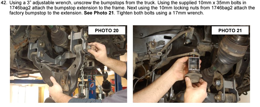

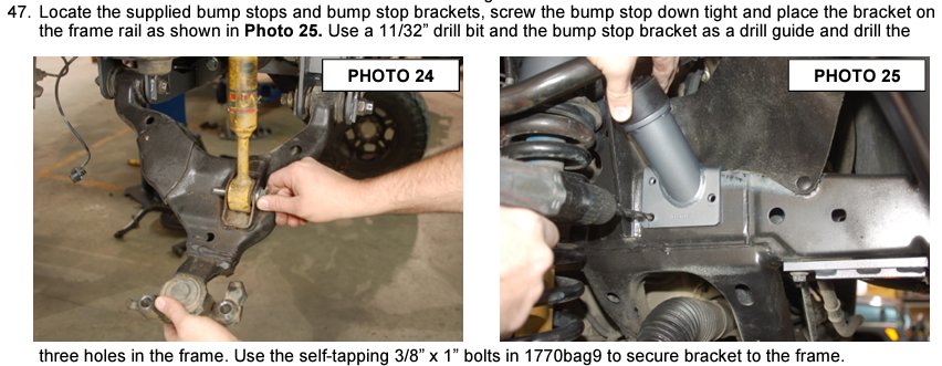

    It’s a bump stop to limit down travel

    Wow, never heard or seen of a UCA bump stop. What happened to the stock location?

    i took the rubber bump stop off to see if it would change bump steer affect and it didnt

    that is where that wanted it off the install guide lol

    Its for full droop, not bump. Its probably cause they know thier shocks are junk and cant take a small top out.
    I was worried they were bumping off the UCA with stock control arms. Its common in racing but you need beef

    The factory one is still there. The factory bump stops limit up travel on our truck, with the kit they add a bump stop to limit down travel as to not bind on the coilover.

    i thought my ucas was hitting the front bump stops nope they barely ever even connect

    They are supposed to. Its either to protect the shock from topping out (full extension) or keep the UCA from hitting the coil. Id get those back in ASAP.

    they going back in within the hour they just screw back in
